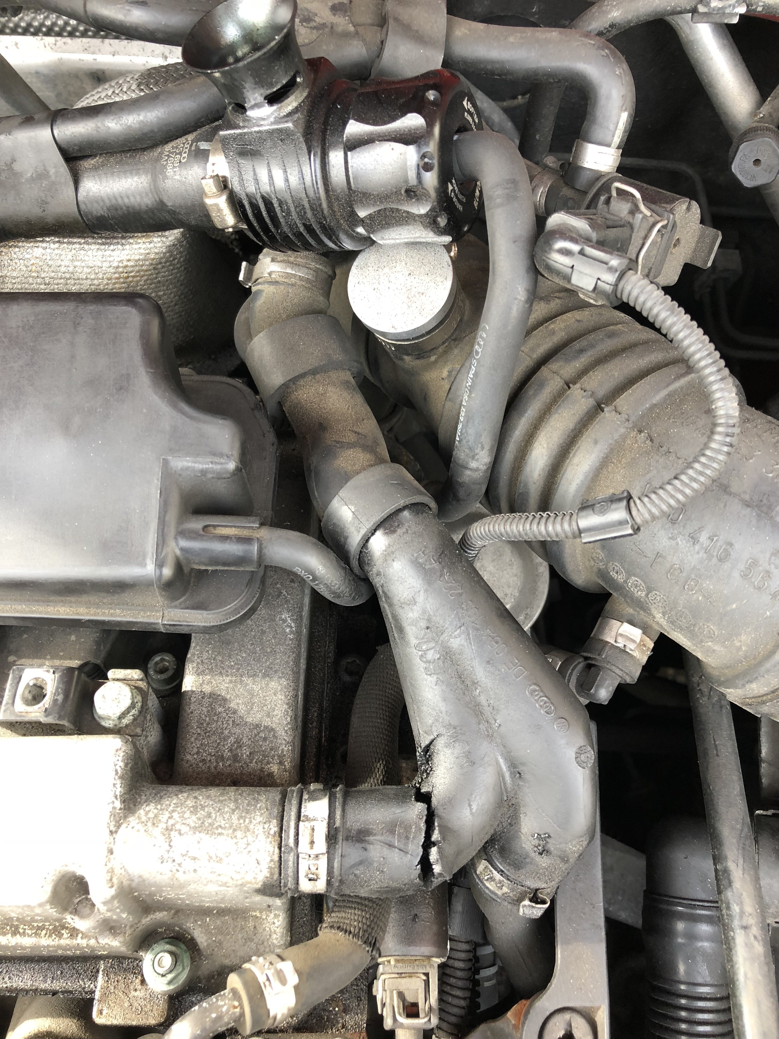

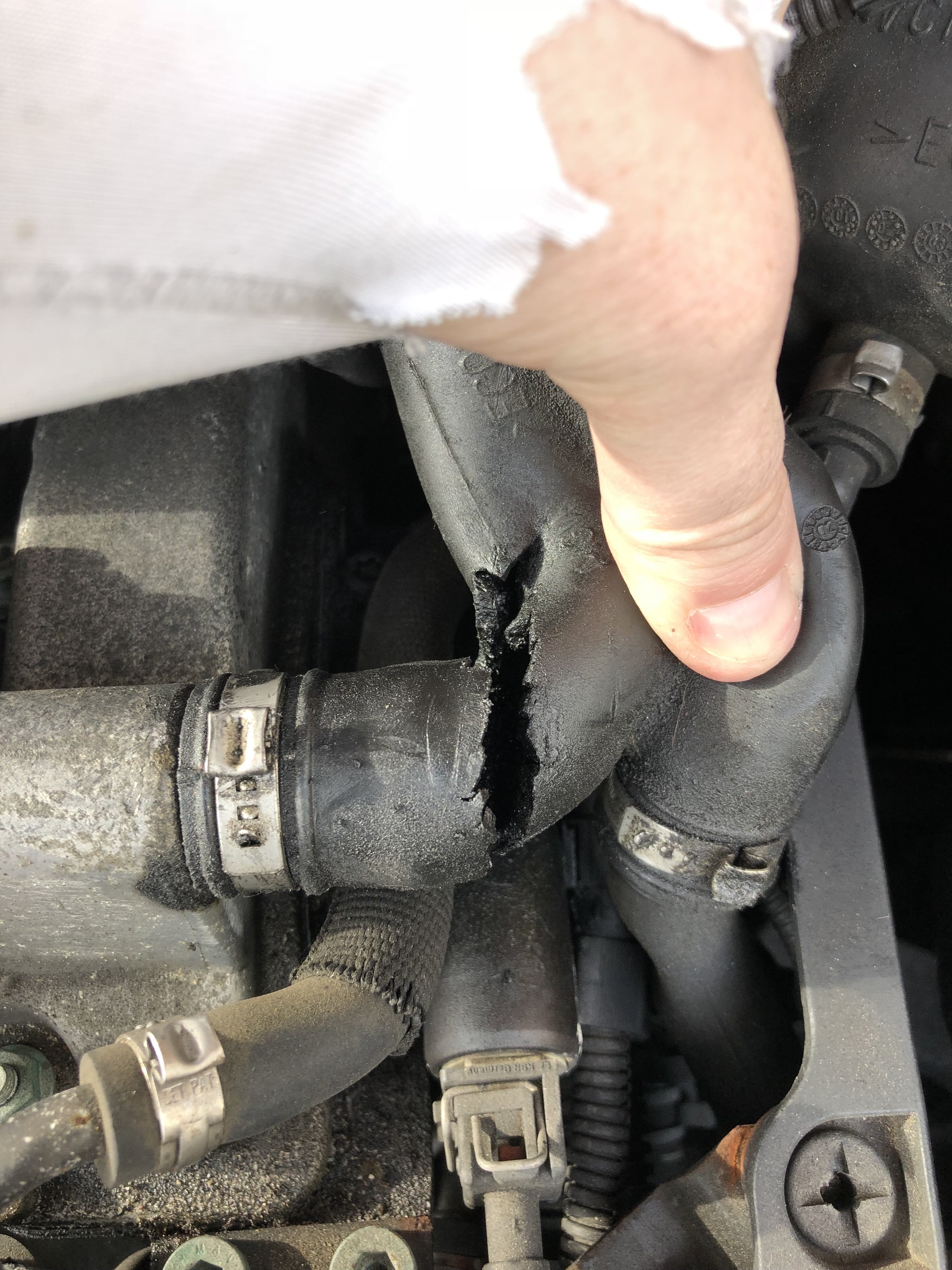

So I found the “split” that main dealer was talking about. It’s only being held together by about 1/4 of the pipe. Other than the silicone hoses spoken about previously, is there anywhere else I can get one of these from other than payin nearly £60 from the main dealers. 0BF447D2-2BEF-46A5-9135-FFEADDE2F818.thumb.jpeg.ece40e562e21ec16a03c14608f405afc.jpeg6CB3A6C9-8AA4-431B-8626-1B2B79325451.thumb.jpeg.28e271ebe297c39d3e42d5b1130d92f2.jpeg

Forge Make a replacement for that split hose in the above pic.

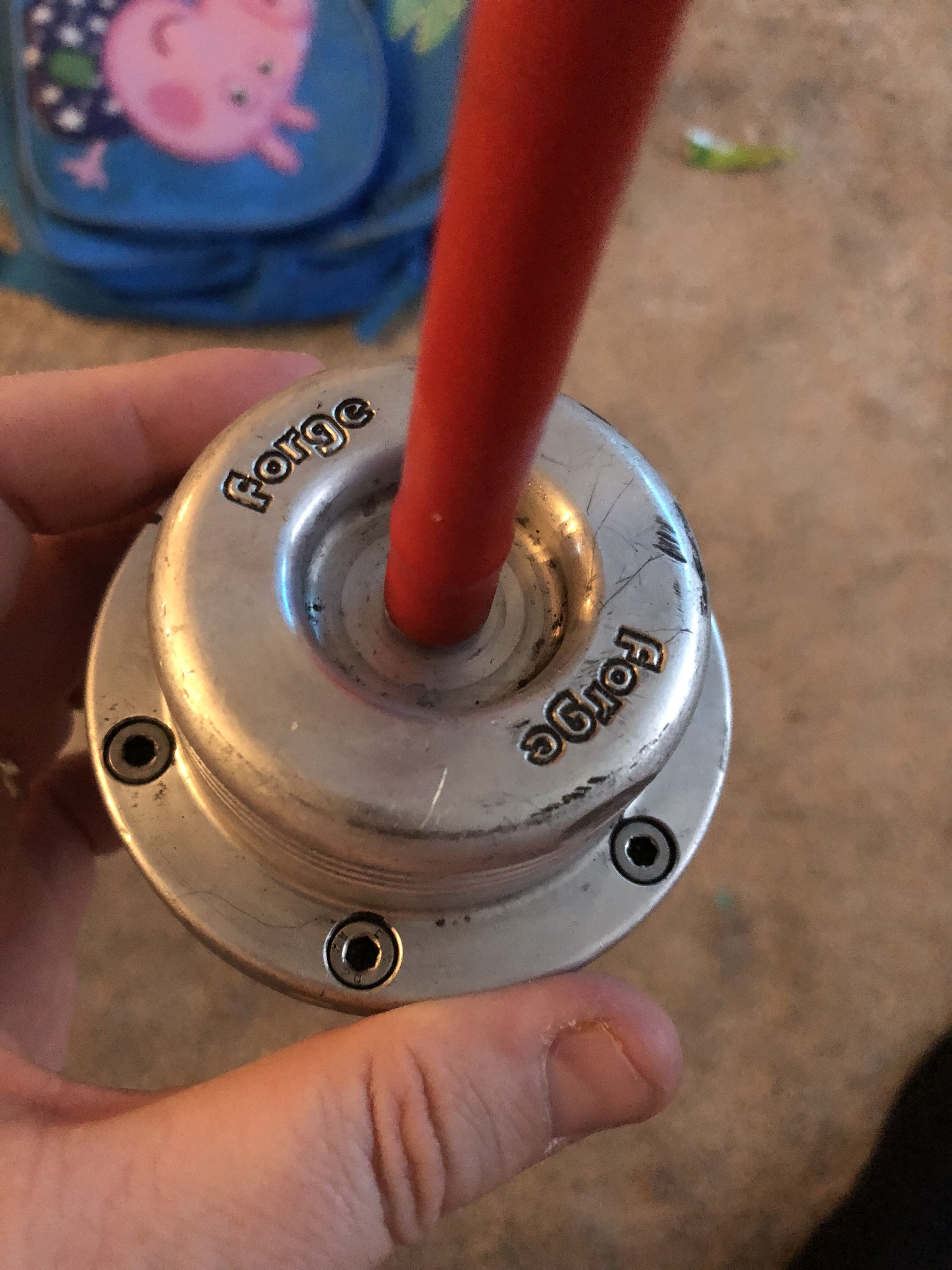

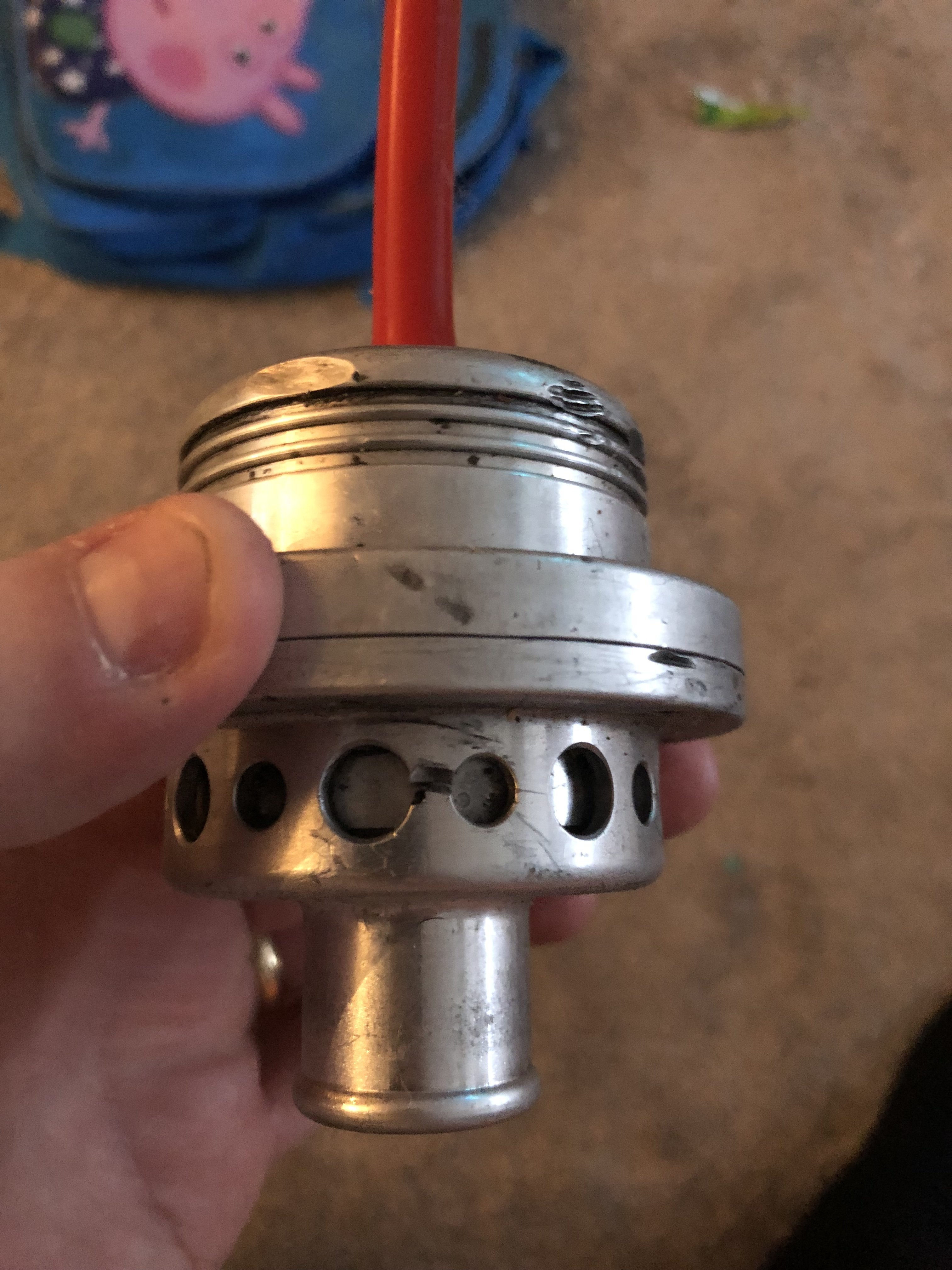

Thanks mate. just looking through the stuff the guy gave with the car and came across this one. Is it what I need it do I still need to get a new one? Looks a bit worse for wear but hopefully still fully functional AFE69079-F960-4BCF-81AA-724B641B5D8C.thumb.jpeg.a670be2d0279aa92a97d0350d5ccf75f.jpegAFE69079-F960-4BCF-81AA-724B641B5D8C.thumb.jpeg.a670be2d0279aa92a97d0350d5ccf75f.jpeg1980C62D-A9FD-4393-B8BC-375A865F466E.thumb.jpeg.738fffc41472bebc03707283ba7881f2.jpeg
That's another atmospheric valve so also no good. A recirc valve has connections for two hoses, an inlet and an outlet.
The manangement for the 1.8t expects the dumped air to go back into the system, as the MAF has already accounted for it, so if it's dumped to atmosphere, the computer doesn't know where it's gone so effectively thinks that there is a boost leak.
