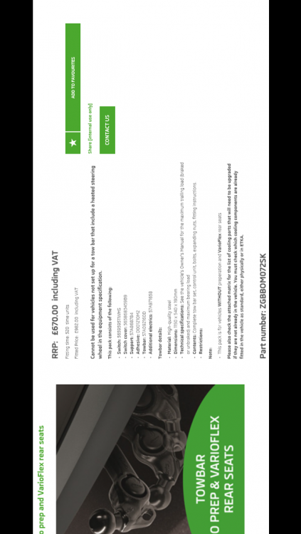

After looking in to fitting a tow bar I have found out some info
• the kit which incloods wiring socket bar it’s self and control unit isn’t available from Skoda or TPS no date on availability
• it will need a cooling modification in the form of a new radiator fan and cowling a step up from a 3.2kw to 4kw and a new radiator grill with bigger holes
I’m unable to find out if this is part of tow bar prep but I suspect it is
• witter list a bar but isn’t available yet
