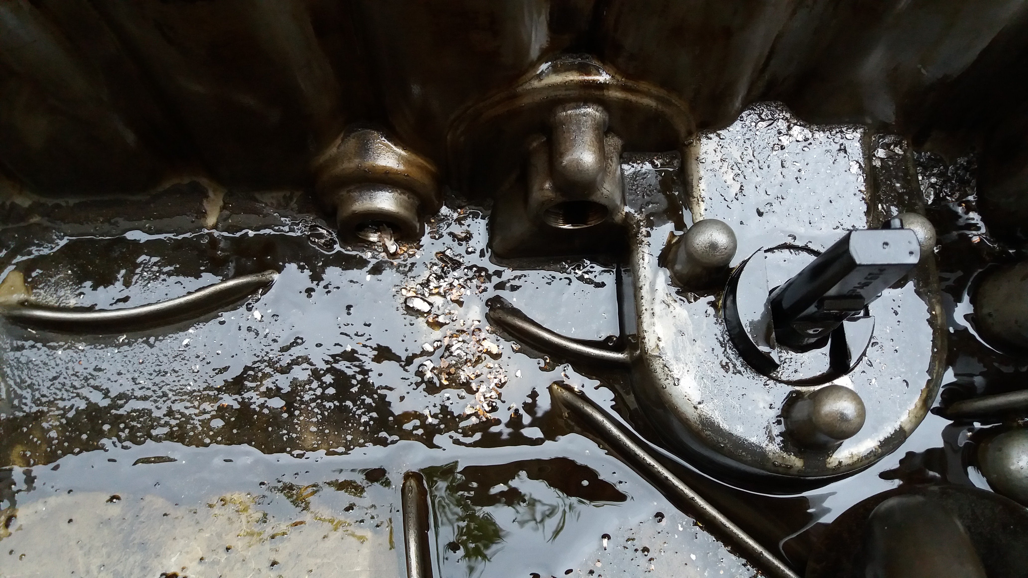

It's got copper and metal type shavings in the sump. Been to 2 garages n both pretty much saying it's bearings. 1 saying big end bearing other saying bottom either way they both saying it's a big job and engine needs to come apart so costing a few quid. I don't wana risk doing the pump n pick up pipe for it all to be in vain. I've spent arond a grand on engine since November so am sceptical about this to be honest. Am seriously thinking of selling as is. Here's a pic of the sump n what's in it :crying:
For the cost of a new pickup pipe, which is about £20, I'd be replacing it before I wrote the engine off. Part numbers for the pickup and rubber o ring are 06A115251 and N0282222.
While the sump is off, it's a 2 minute job as it's only held on by 2 small bolts. No need to be thinking about changing the pump aswel, I've not known one to fail on these engines, it's always the pickup.
Thanks mate. Just pondering weather to sell it as been told coza the metal filings in sump it's bearings that have gone so guna need new 1s. Really don't fancy spending anymore £££ on it to be fair but i'm in limbo as to keep it :blink::sadsmile:
That does indeed look like metal from bearing shells I'm afraid. :sadsmile:
