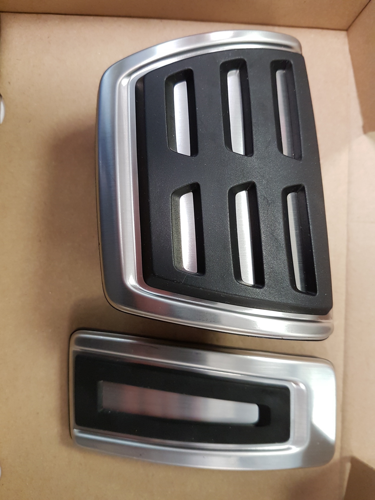

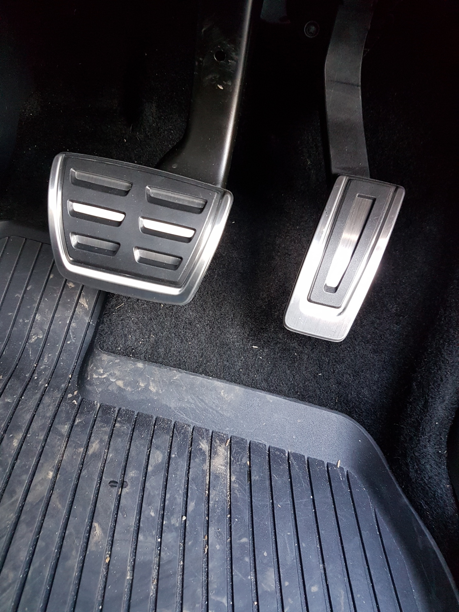

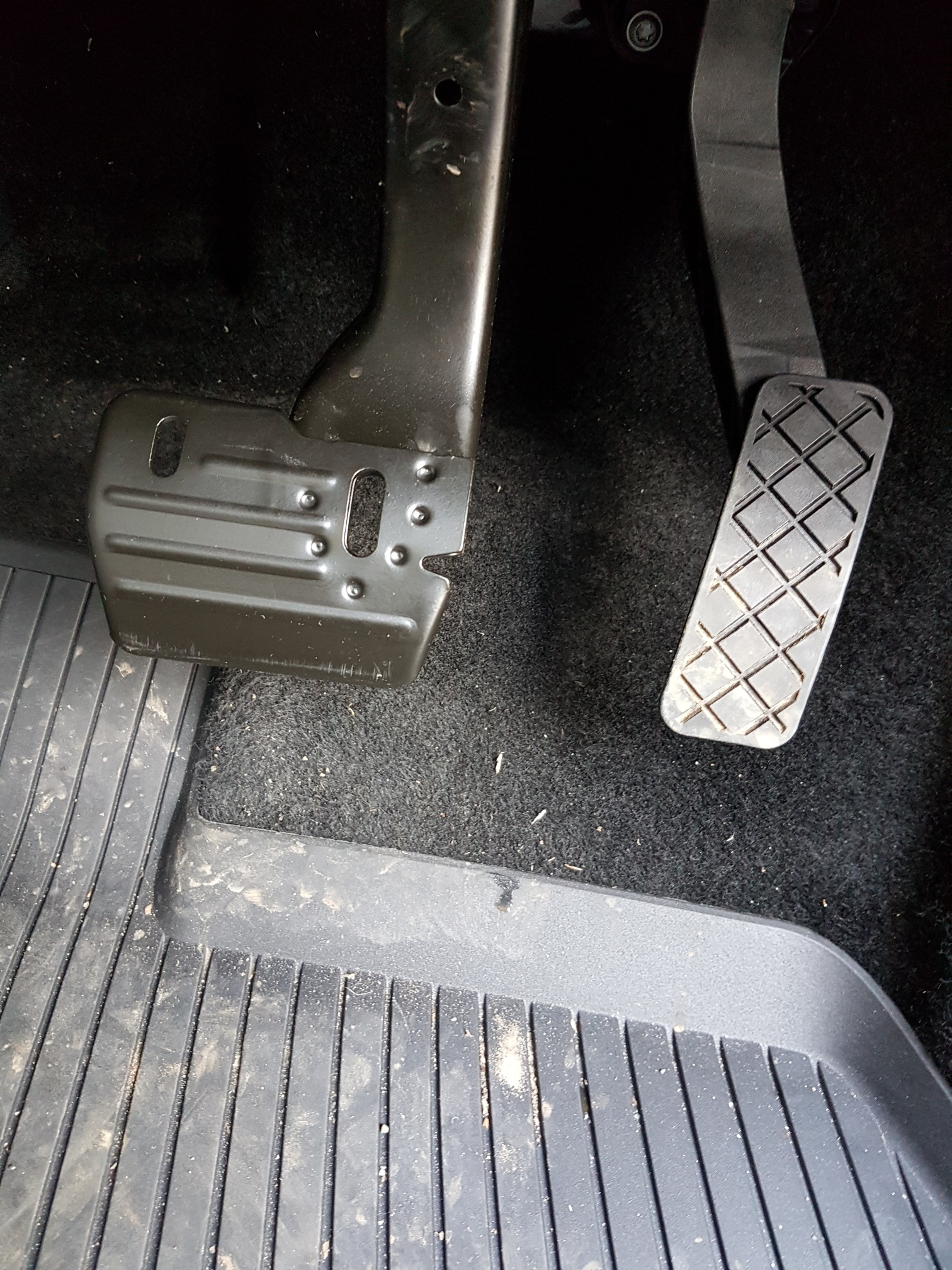

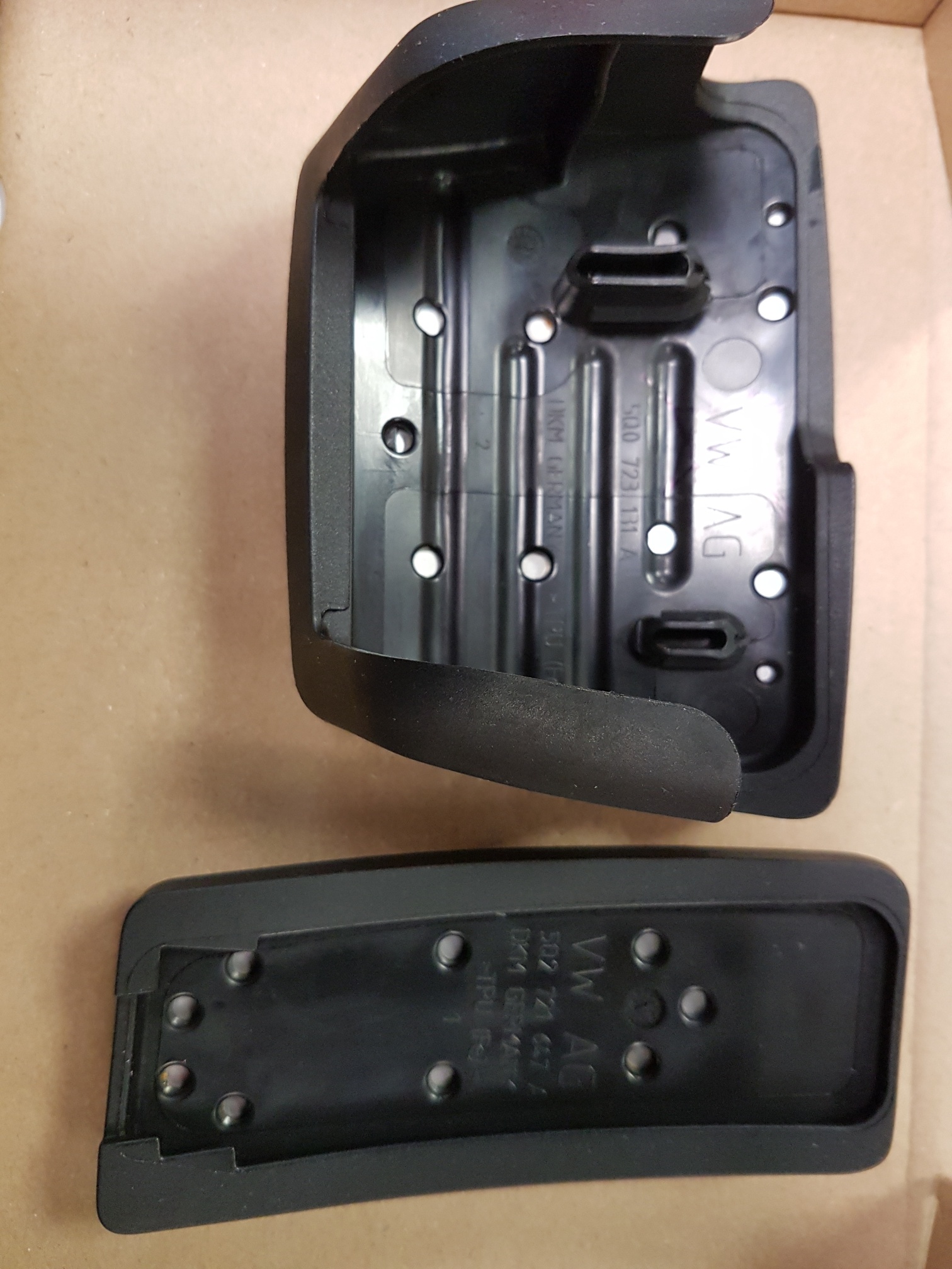

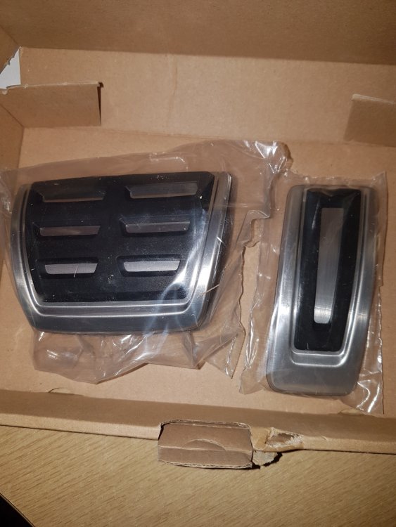

I fancied some stainless steel pedal covers just to set everything off but was put off by the price when I came across these on ebay after a lot of searching and messaging and they worked out at £27.39 delivered after paypals exchange rate so I thought considering that the golf and many others use the same platform as the Karoq I'd take a chance. They arrived in under a week and have vag part numbers marked on them and going by the quality look genuine to me, see attached pictures. I pulled the brake pedal off from the top right corner and put the replacement on the bottom edge first and just eased it up and the location pins just popped in, took 30 seconds. The accelerator was a bit harder but in the end I put a little fairy liquid down the left side, then fitted the top right corner and slid the right side in, then I used a small allen key to lift the rubber over the pedal and just worked the left side on. The fairy liquid dries over night so no worries there. Here's a link to the pedals on ebay https://www.ebay.co.uk/itm/VW-GTI-Audi-S-Line-Seat-R-Skoda-RS-Sportpedale-Pedalabdeckung-DSG-RHD/112551532469?ssPageName=STRK%3AMEBIDX%3AIT&_trksid=p2055119.m1438.l2649

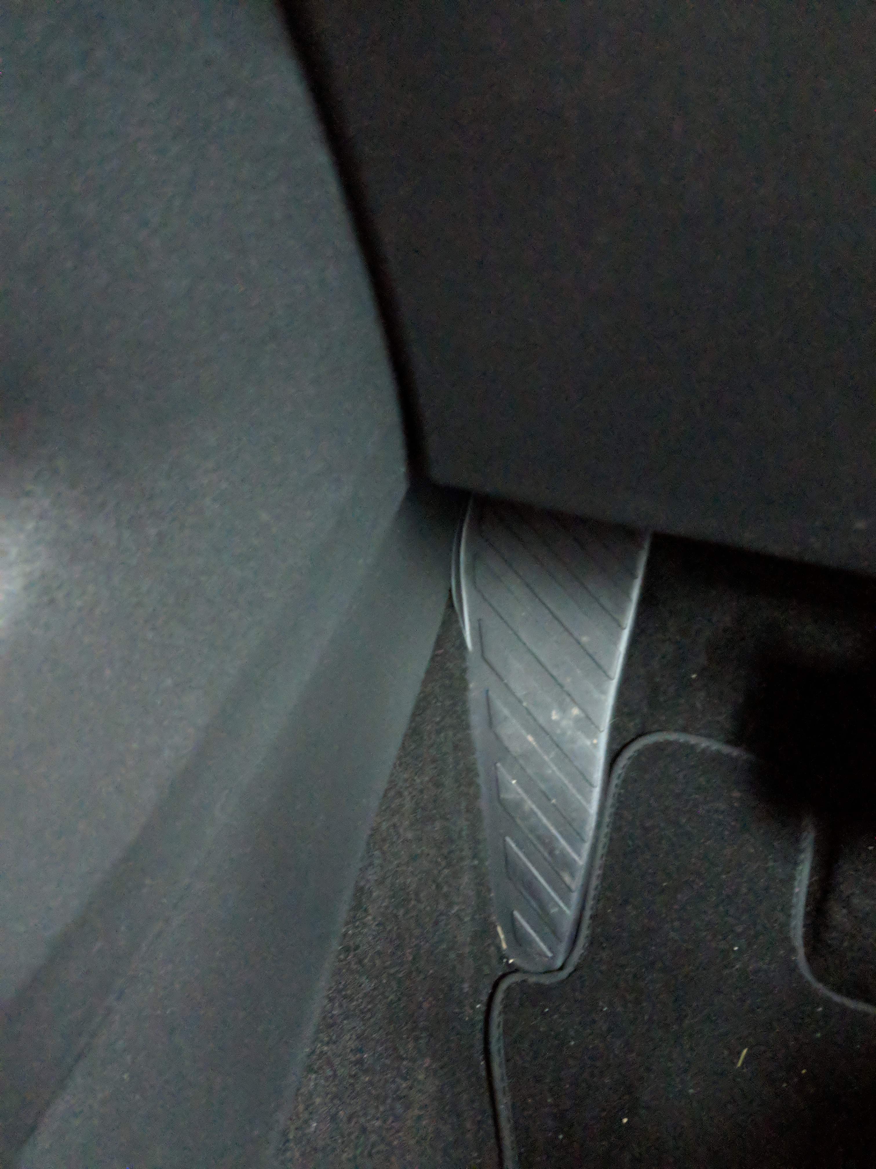

There ought to be a matching RHD DSG footrest coming through at some point. I'll keep an eye open and post back here if I spot any.
On 05/04/2018 at 14:57, Panther_uk said:
Umm indeed. If they fit, that wouldn't be *too* bad a price for the full RHD DSG set of all 3. The LHD version Superskoda lists is a rectangular shape on the footrest, but I assume that's because it sits by the LH driver's door instead of the console as here.
My footrest is definitely the arrow shape.
Feel free to buy the set Panther and let us know :D

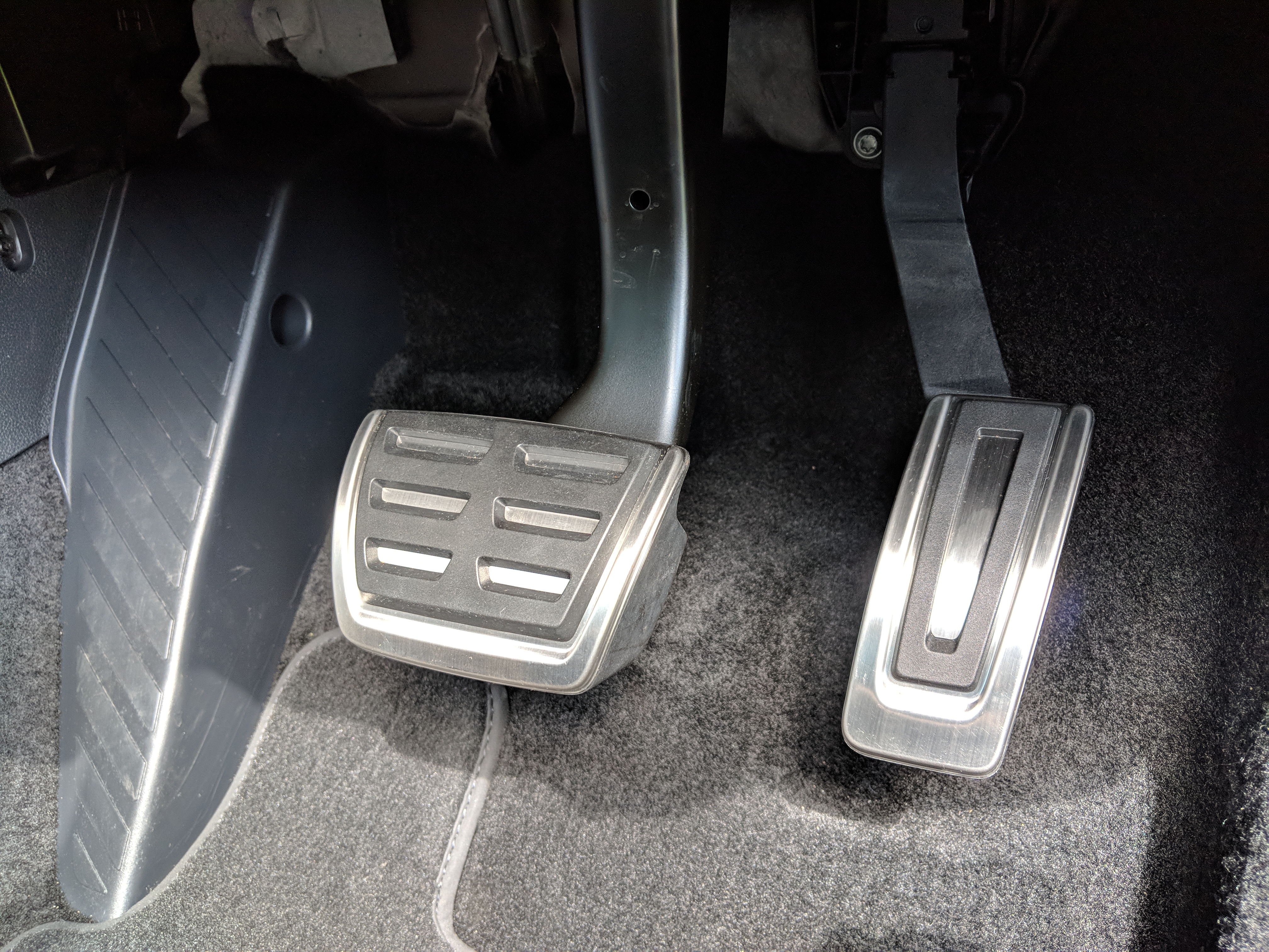

Still pondering the footrest. Meanwhile stirred myself sufficiently to get these on.  Thanks for the inspiration Vectis :thumbup:
I can confirm that this also works on the Kodiaq. Thanks to @Vectis for the idea.
Did you have a hell of a job getting the throttle on?
 Followed Vectis' lead, but in the end, it was so hot the gas one just pushed over and on.
Brake was easy.
Brake was easy.
The Allen key tip saved me. That and washing up liquid.
