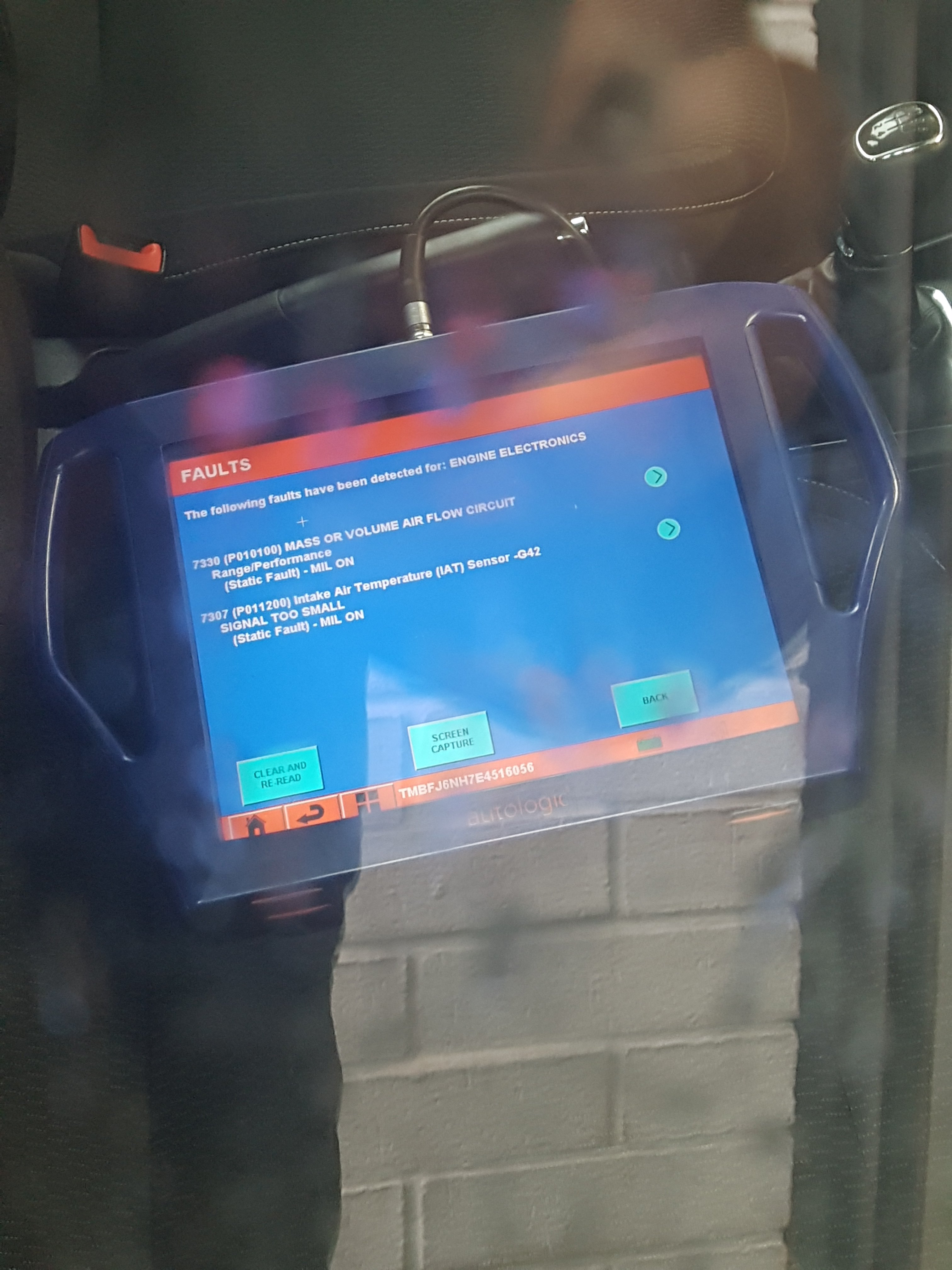

Just wanted to get your thoughts. Just bought a 14 plate Rapid Spaceback G-Tech from trader and I've had some issues. As I was about set off in my new used car the engine warning light came on, however the trader immediately fixed the issue and delivered the car.
Today I find the error is pending on the OBD reader I have - P0112 Intake Air Temperature Circuit Low Input - but its not showing on the dash after 45min drive. They changed the MAF ( picture ) .
I also noticed the car has a squeaky sound when going over 20mph speed bumps.
In all does the fact the error is pending mean it will eventually show up on the dash?
They did say they would look at it again and sort the issues but seems like a lot of headache so far.

I've read that the squeaky suspension is one of those characteristics of the car/model. Does it squeak all of the time or occasionally. Even my Toledo squeaks occasionally from the front NS but if I try and listen for it happening sods law it won't oblige.
Regards the other fault, definately have them sort it, they should be able to clear the fault if they've solved the cause.

Driving today to work and another error appeared the coil one. Defo returning now.

Yes i did after a few barriers from the trader and games. I got a full refund.
He tried to claim thier was nothing wrong with the car and that i was looking for faults.
Thats was until a garage hooked up a reader and read the error.
