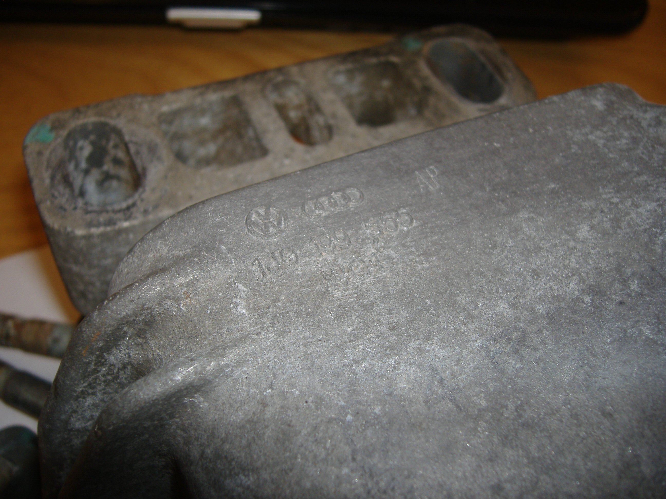

I've got an upper gearbox mount that can be ready to send very shortly if you wanted to try one mount by one? But the upper engine mount (timing belt side) is still on the car and might not be off it for another week or two. Part number is 1J0 199 555, version AP.
