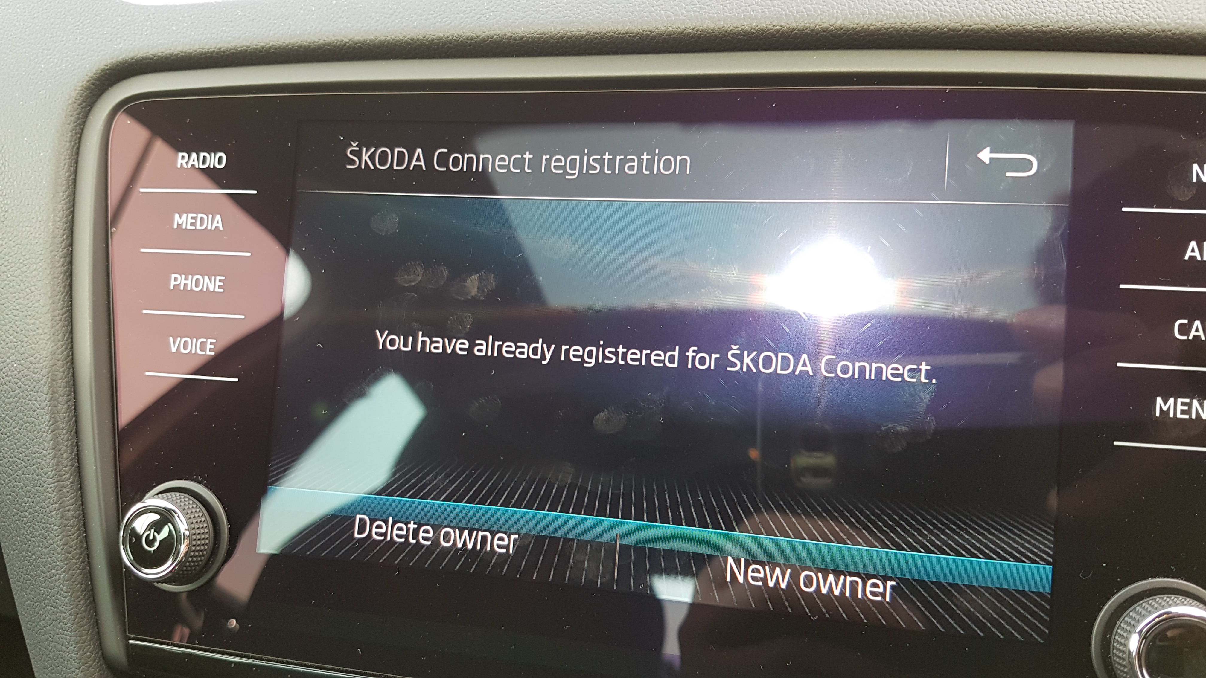

There's an option to delete previous owner registration details...

Where? I couldn't see it...
Pretty sure it's on the same screen as registration....
Just been to the car again and when i select 'Skoda Connect' it takes me to the set up wizard.
The only option i then have is to press 'code'. It then asks for the code (which it obviously then says is incorrect).
There is no option to de-register any accounts. I have previously tried a factory re-set in the main menu, but this hasn't made any difference.
Anyone else have any ideas? It's really doing my head in now!
This is what I can see - if an owner is already registered, you should see this. If you don't see it, I assume there's no owner registered...
Thanks, that's not what i see. It just says Code Incorrect.
Perhaps its just the code that's dodgy then. Skoda didn't seem to want to give me another one when i spoken to them
