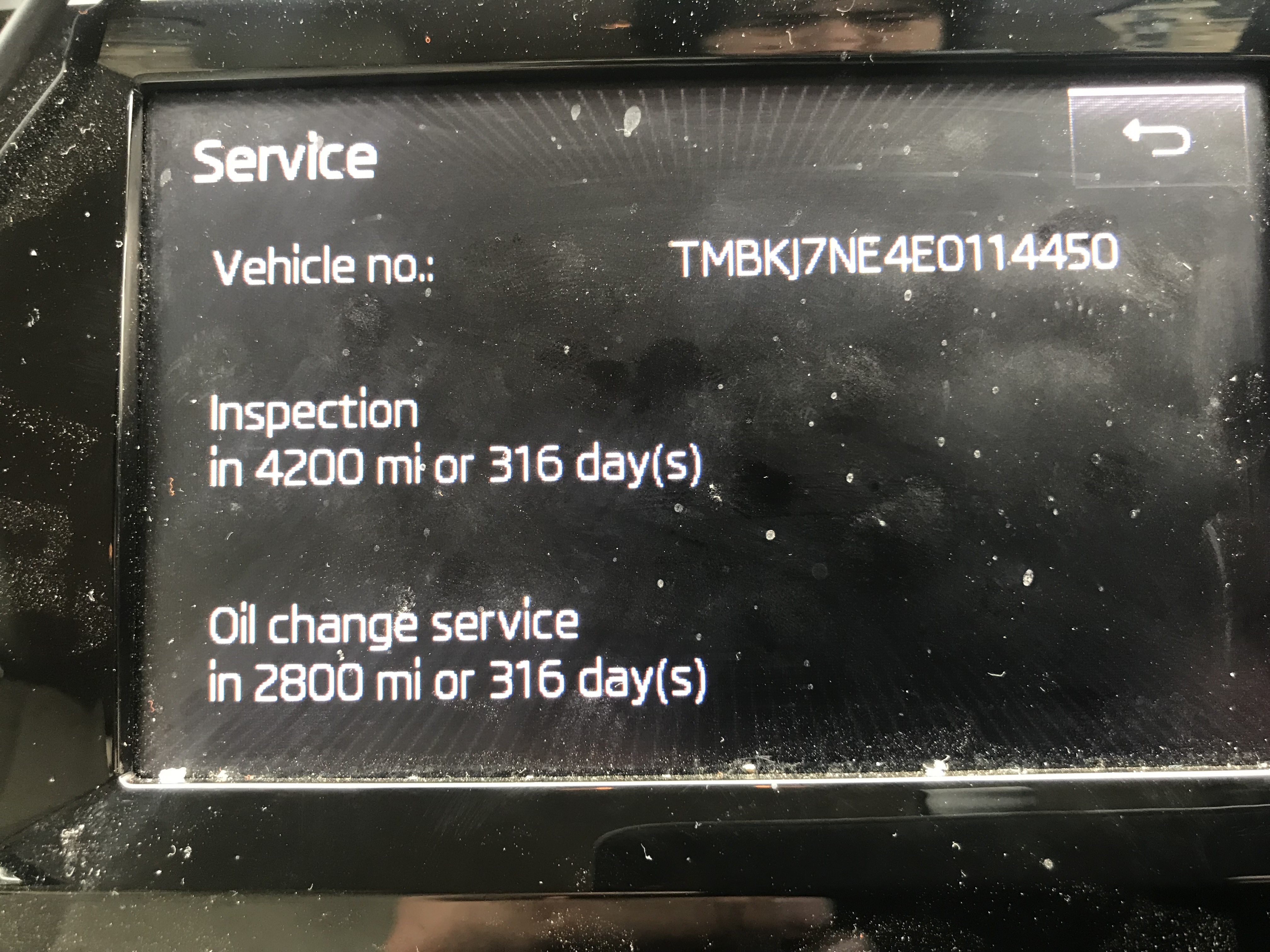

What’s the difference between oil change service and a inspection service?
In an oil change service they change the oil and filter.
Some things need changing in x miles/or x months oil/filters whichever is the sooner.
In an inspection service they inspect parts of the car to see if anything needs changing.
Some things need checking/changing in x months only, not by mileage, eg:- brake fluid.
Some cars might have the oil and inspection service done at the same time once a year.
If you do higher mileage then the oil service could be more often than each year.
Hope this helps.
Thanks Ag Falco
Cheers Falco. Do you know if it's possible to get the inspection service and the oil service changed to the same time interval at all?
Usually the "oïl change" service should be longer than the "inspection" or at least the same mileage.
My car is reset to 372 days to inspection & 720 days to oïl change after each service. (I'm on a variable service configuration)
I would suspect that you do short journeys or lots of start-stop driving & the ECU has determined that the oïl quality is affected thus requesting an oïl change before the inspection service.
When you have the "oïl change" service done, they will also reset the "inspection service" counters at the same time.
If you dont drive many kilometers, they will probably reset both to 372 days.
Otherwise, they will set inspection to 372 & oïl change to 720-something.
You can anyway ask for fixed interval or variable service interval. With the later you might be charged slightly more for the longer life oïl.
For a car doing short commutes, 3 times a week, amounting to 7000 miles a year, 1.4 DSG - what would be better  - fixed or variable ?
Fixed
