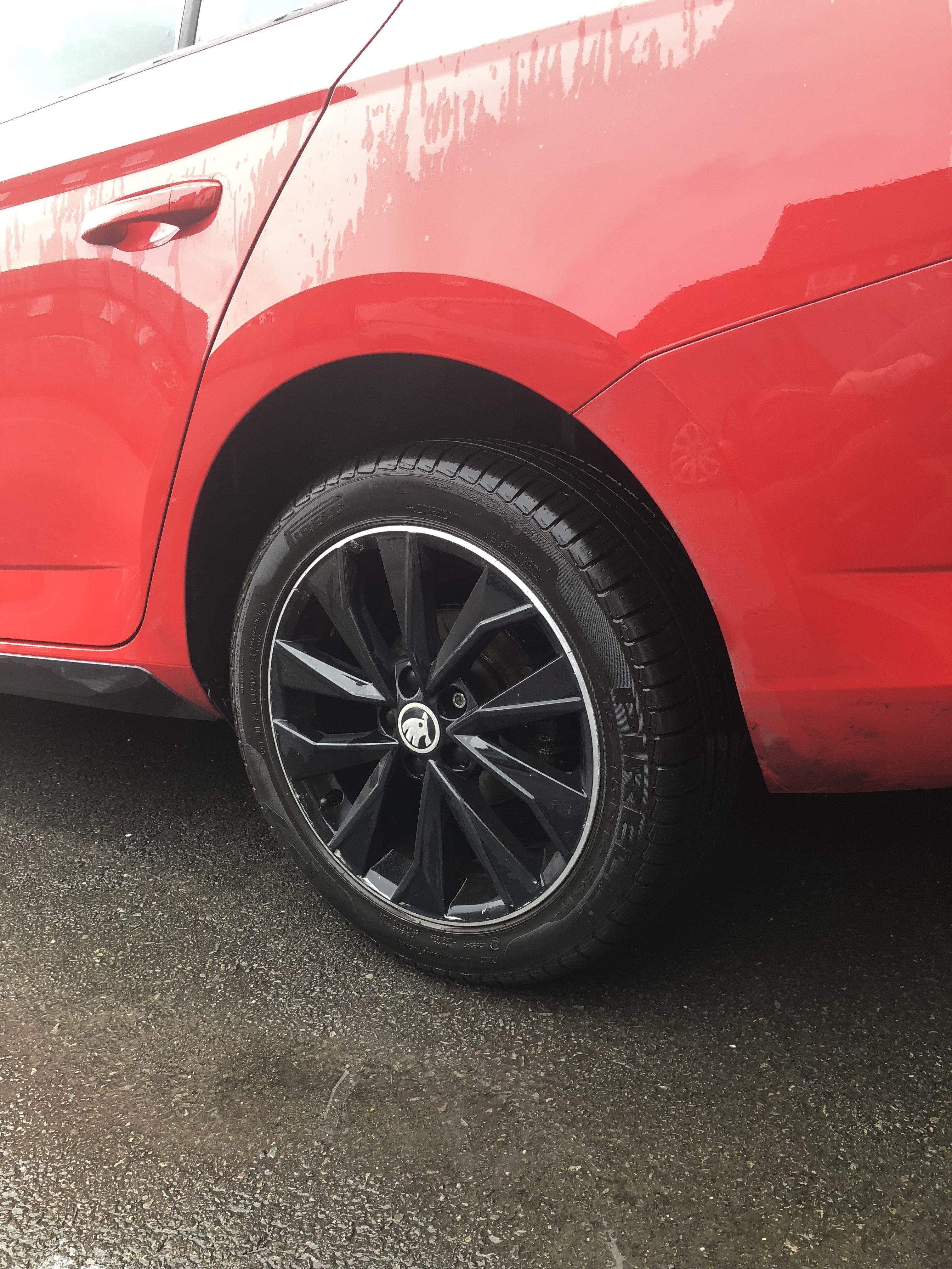

Recently my good wife got a 1.2 110hp petrol 2016 Monte Carlo estate and is generally very happy with her car and how it drives - except the suspension.

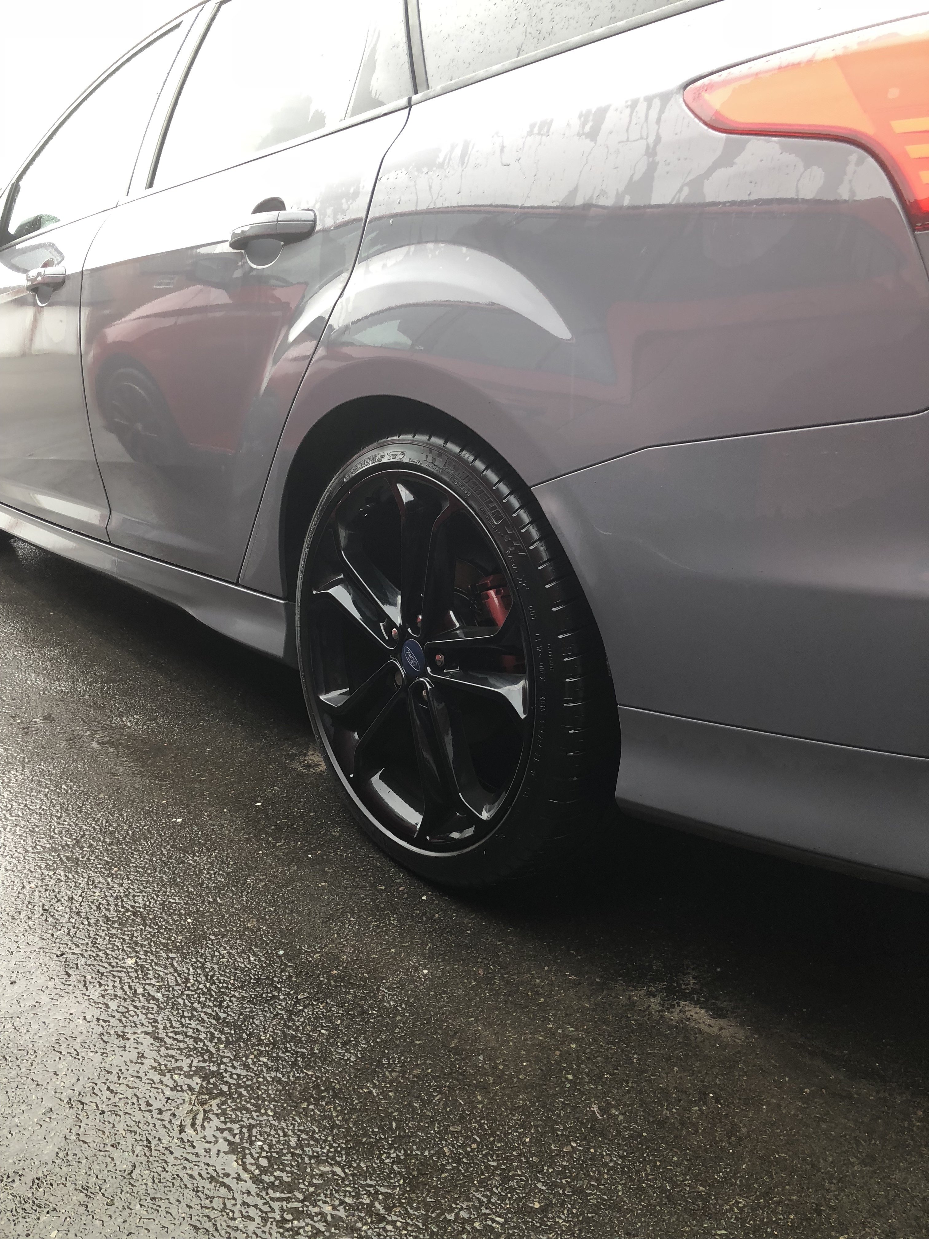

She is coming from a Fiesta ST so much harder and flat cornering, and occasionally drives my Focus ST which is nearly as stiff, so misses the taught handling.
Also the ride height is frankly ridiculous on the Fabia, so lowering quite a bit would be welcome.
I'm a confident spannerer so doing the job isn't a problem, but wondered what are the thoughts on fellow Fabia owners with regards to what to go for.
Don't really fancy just replacing springs as I feel shocks and springs need to be designed to work together (please feel free to correct me if not the case), and don't want to spend more than say £400 on components ideally.
Not looking for ground hugging lows, just so it doesn't look like a tractor and handles nicely with limited roll.

Does your wife`s Monte come with factory fitted sports suspension, that gets you 15mm lower than standard and a little bit harder.
I would sugest you try lowering with eibach progresive springs or if you want more adjustability go for coilowers such as KW, they are quite expensive but woth the money.

The rear springs are more poundage on the estate. The nose down stance actually helps the traction and handling, and even if you lower it the handling is a bit better when the front does not go light under acceleration.
If you are going for changing springs and dampers maybe as well to spend just a little more and get Coil overs rather.
Any crashy ride on a Fabia's tyres and platform even with the Skoda so called 'Sport Suspension.
Nothing different really from the Fabia, or the Mk2 to the all new 3rd Generation yet 5th version of a Fabia.

Hi Davy. Did you get the springs installed and have you any thoughts on them so far?
I'm tempted down this route now, as the daughters Monte Carlo is lower and rides much better, so we have concluded the difference must be just the factory sport springs.
Ideally we want something like the look of my ST, but appreciate that has 19s and the arch looks much smaller, but here's hoping.. ;)
