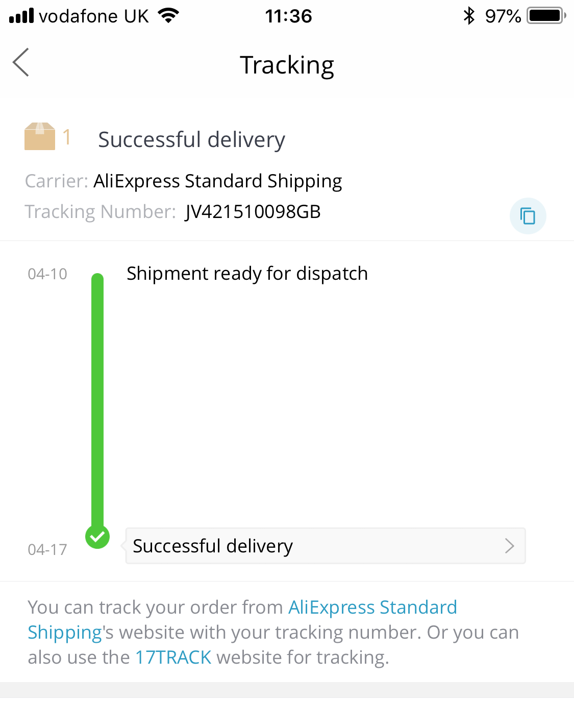

Get the Aliexpress app if you have suitable phoneware, it has built in order tracking, mine also said 28 days estimated at outset, but the tracking showed it on the plane in 2, landed in the UK in 4!
