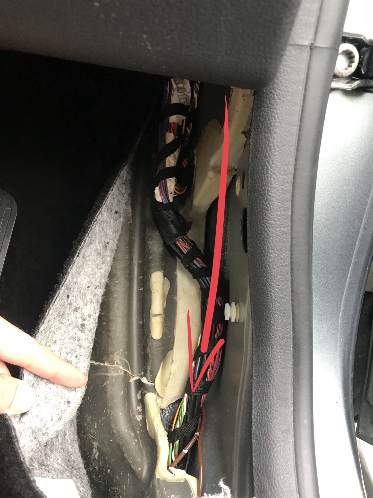

bspman - leak ran down drivers a pillar, and into footwell via the thick mass of cables (sorry for lack of better description). See photos.

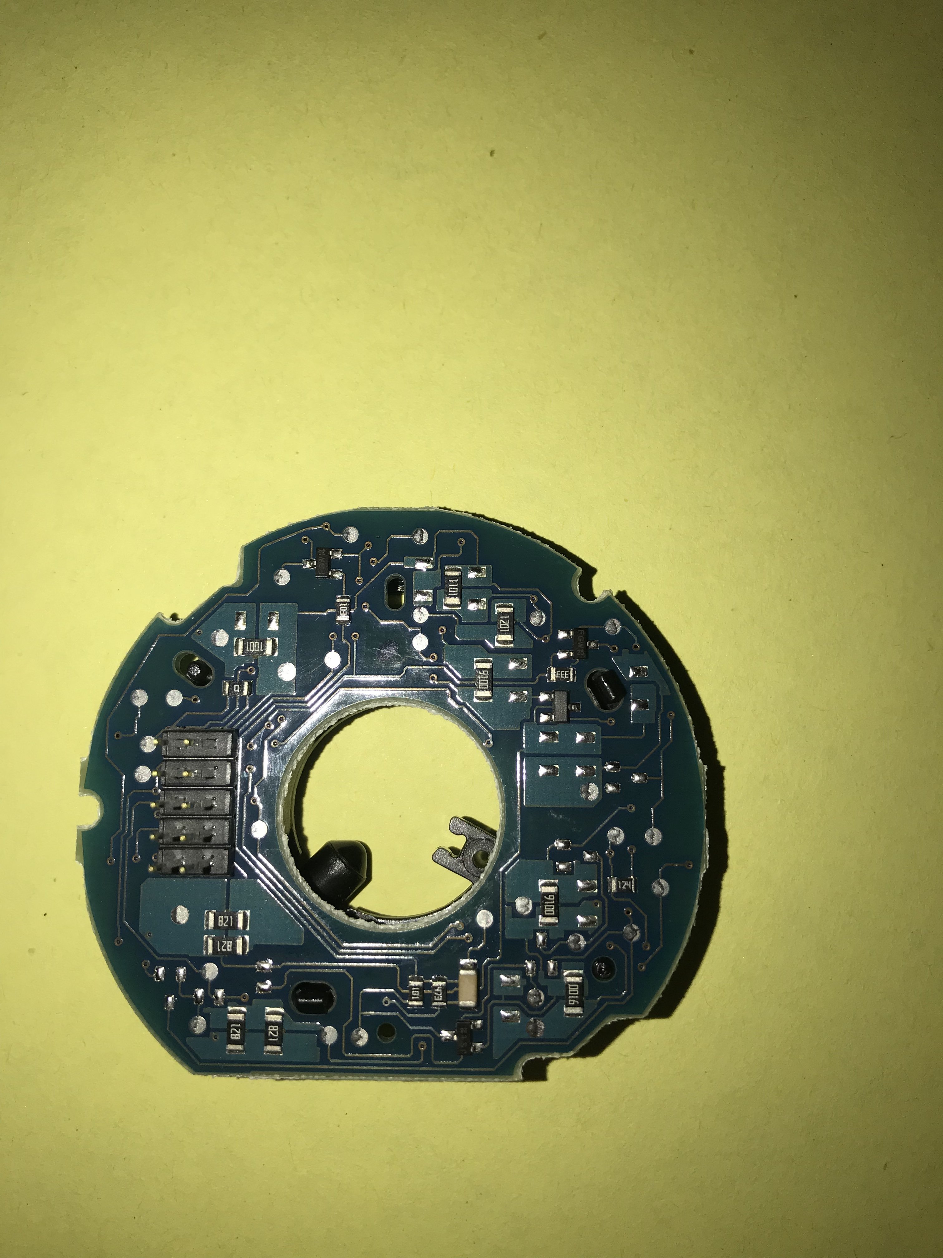

ive also removed the board from the switch. I’m no expert but it doesn’t look fried and certainly doesn’t look like any water damage.

mine was burned under the10 pin plug - one track passes between the 2 banks of pins, that was my prob! have you got a multimeter to check the tracks from the pins to the solder discs?
I might have somewhere but I’m not sure what I’d be doing. I’m useless with electronics! If I can find the mm, where do I test and how?

What is the route of the electrical flow? I was able to test connectivity from the pins to the pads (that swivel and contain the metal pronged-heads).

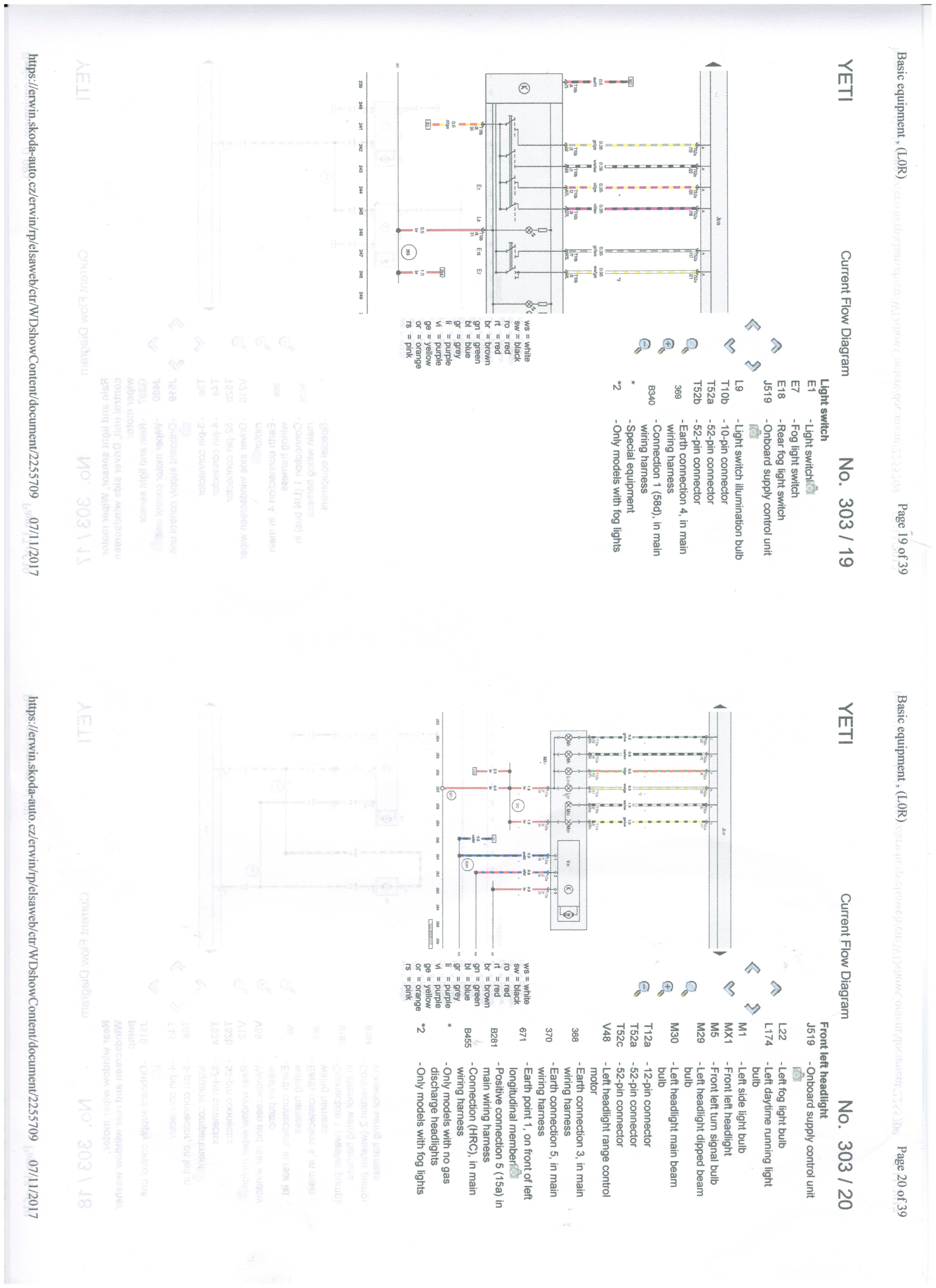

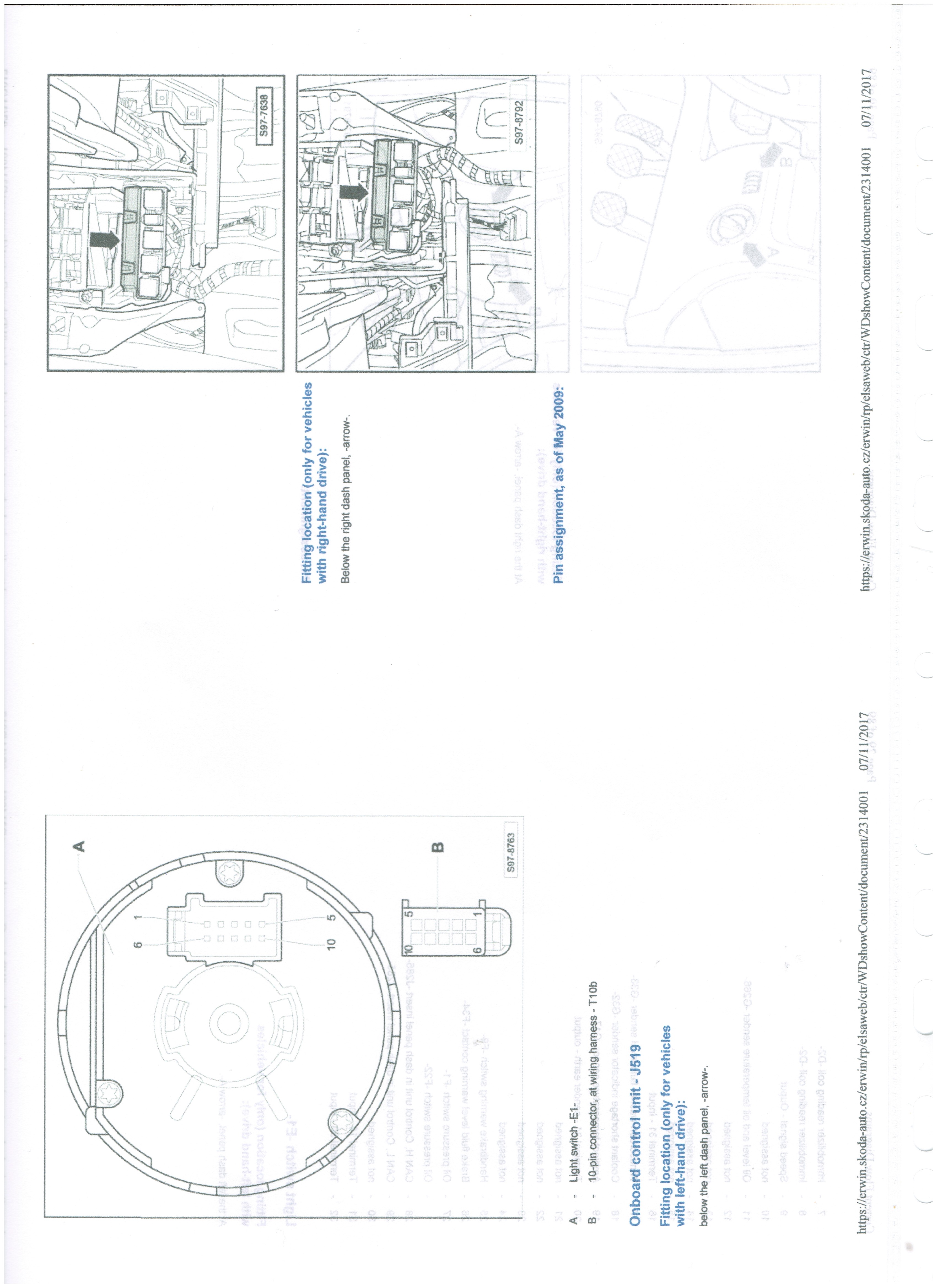

I attach 2 scans , one of the wiring to the switch and the other the pin numbering orientation - from that you should be able to assign pins on the pcb, what are the tracks like on the other side of the board? if the track has failed under the plastic of the socket base , with a gentle heat source it is possible to ease up the plastic and remove to view the tracks, you can then trace the track. if you attempt a repair use a low wattage iron and fine wire, its easier to solder on the underside of the socket and notch the board edge to get the wire run up to the pad.

Hi French, thanks for your response. The diagram isn’t clear enough for me to follow it but even if it was I’m not sure I’d understand it!

yeap all have the same switch as do other vw/audi etc of similar age, just need to check the plug socket, as some are different  -  I added some more to the last posting I made. if you want a bigger image, pm me and i'll try to send you one!
Great, image is perfect now.
