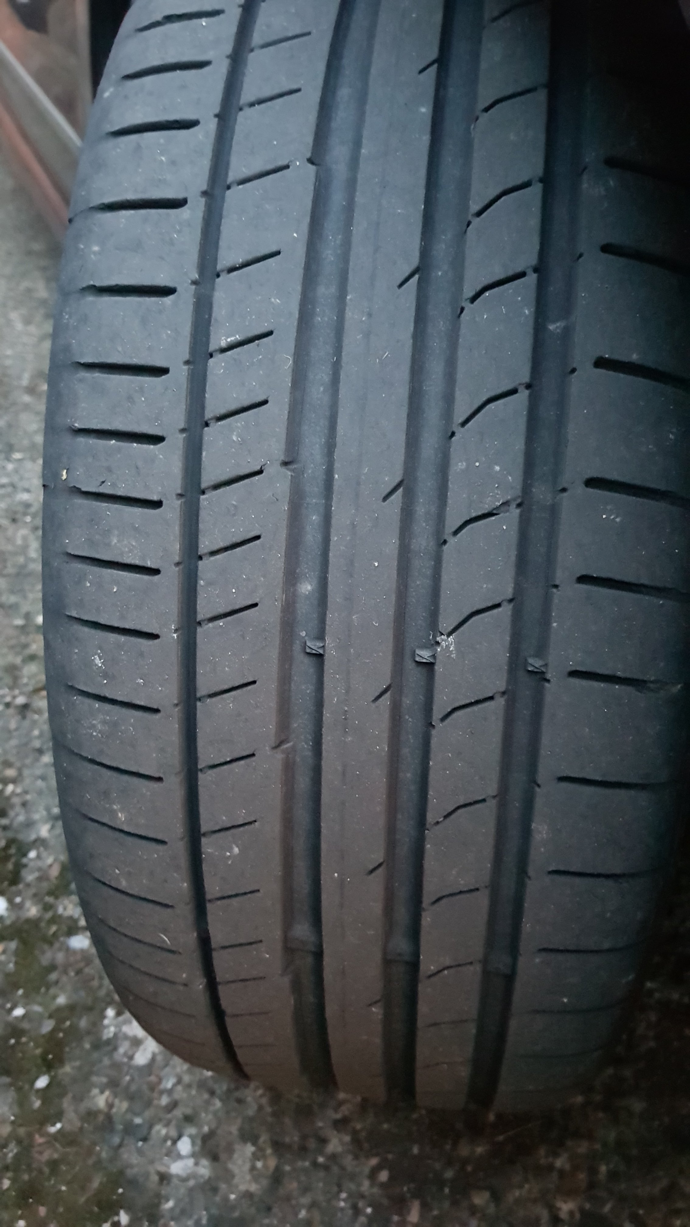

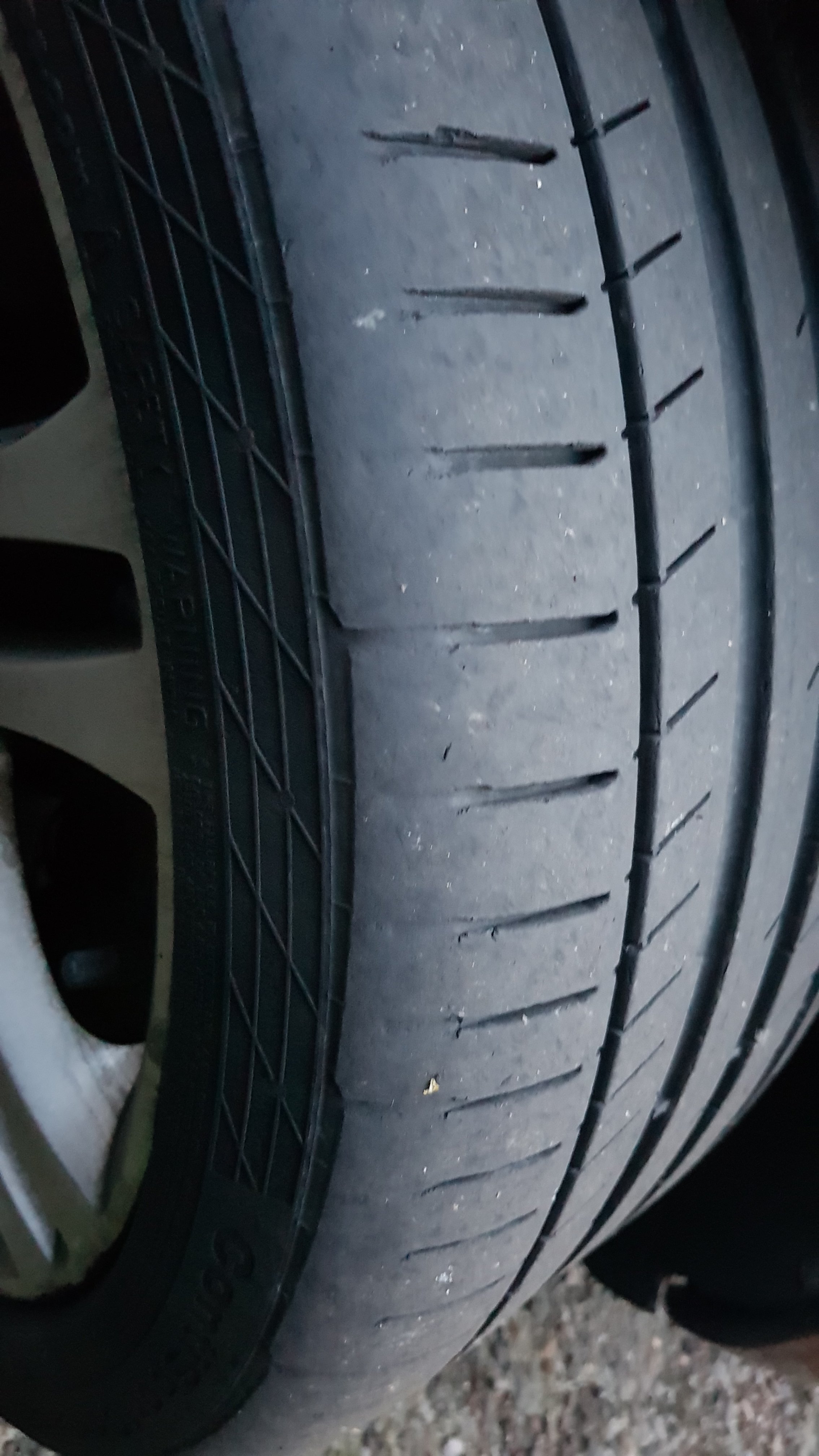

I have Conti sport contacts tyres all round on my car, but the drivers side tyre has excessive wear on the ouside edge,  the track is fine as have had it checked, as anyone esle had this problem? is it a common fault?
Thanks
Had Conti's before the last swap - and they wore evenly.  If it's outside edge, it could be camber setting of the suspension.  Tracking only checks for straightness I think.
Do you regularly drive with a full load?  Does it only happen on one side of the car or one wheel?
If it's all outside edges, I would guess at it being camber related but I'm not a mechanic :)
The camber  setting is ok and that it checked when using the hunters alignment..
The wear it more on the driver side  front.
That wear is on the very extremities of the tread, almost on the sidewall. I can't see how something isn't hugely out of spec in your suspension geometry. You could put the rear on the front and see if it starts to do the same?
Yeah might swap them as see
