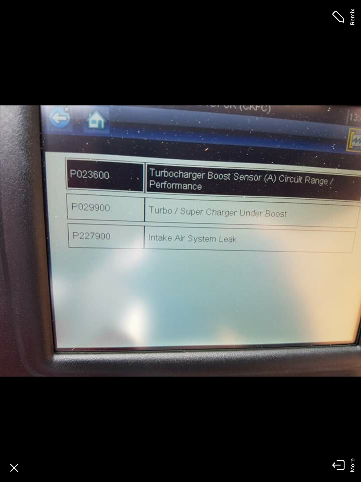

Boost pressure fault
Any help with attached fault code, booked in for Friday .
Octavia Vrs 2014 tdi
cheers
One of your intake hoses may have a split or the clamp holding the hose to a hard pipe may have broken?  A friends 2004 Fabia VRS had one clamp/connector fail where the intercooler exits towards the intake.
Basically it looks to me like your loosing boost pressure out of your intake loop, either from the air filter housing back to turbo, turbo to intercooler, intercooler to intake.
The car isn't happy as it is not getting the intake pressure it is expecting :)
