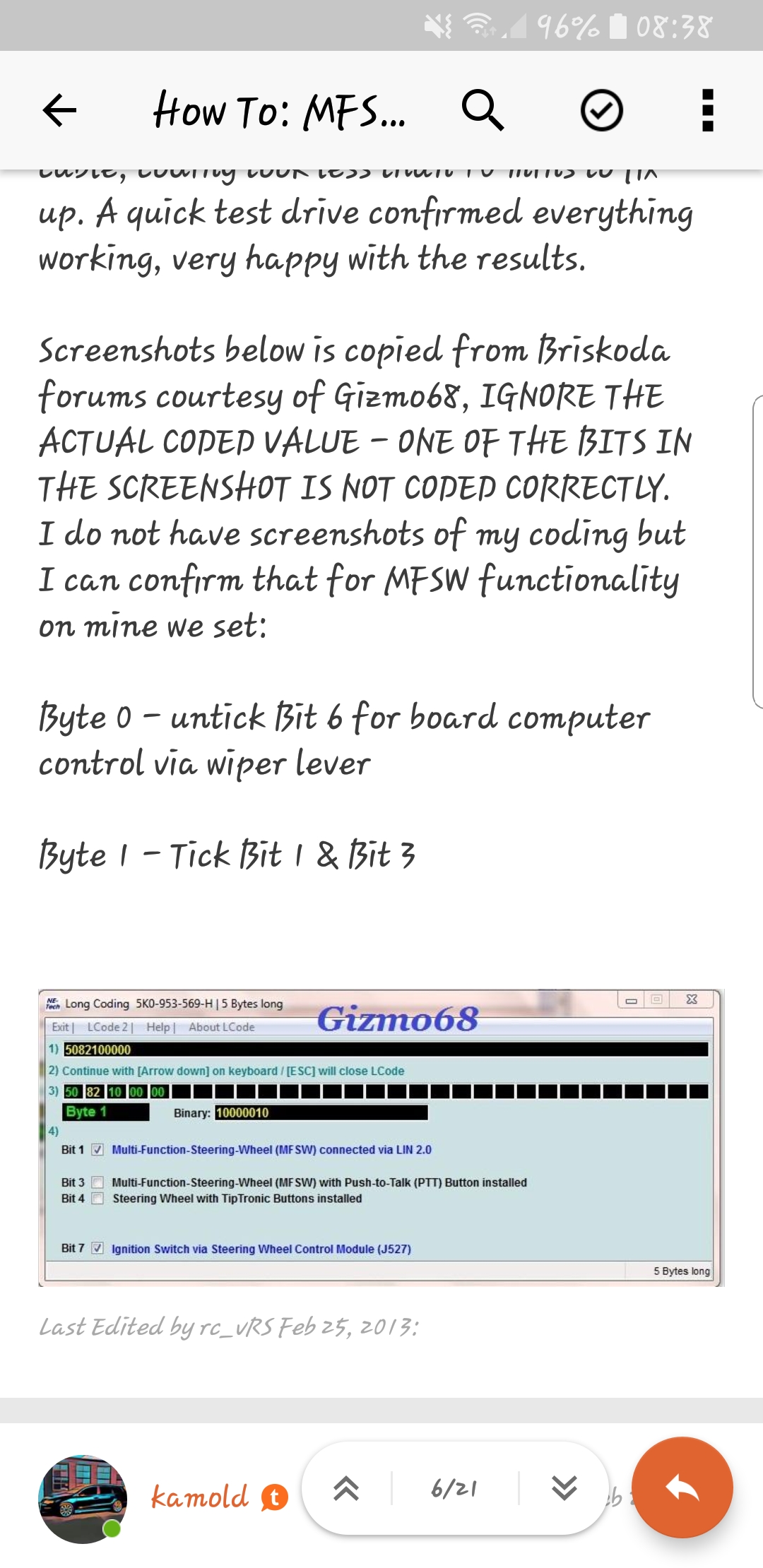

I followed coding at bottom?

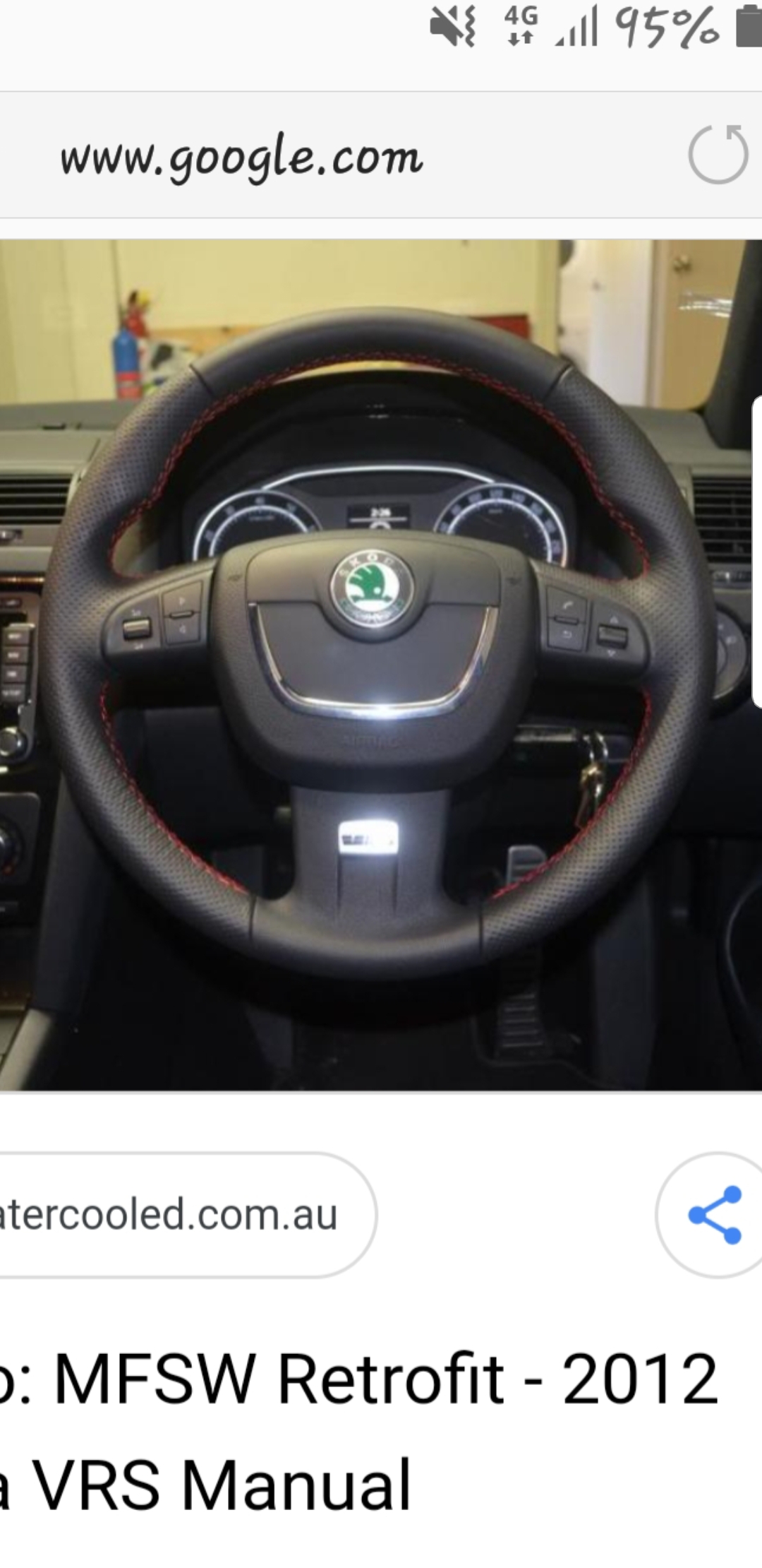

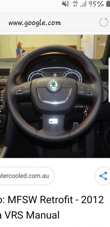

Its a fl steering wheel, same wheel just with buttons and red stitch..

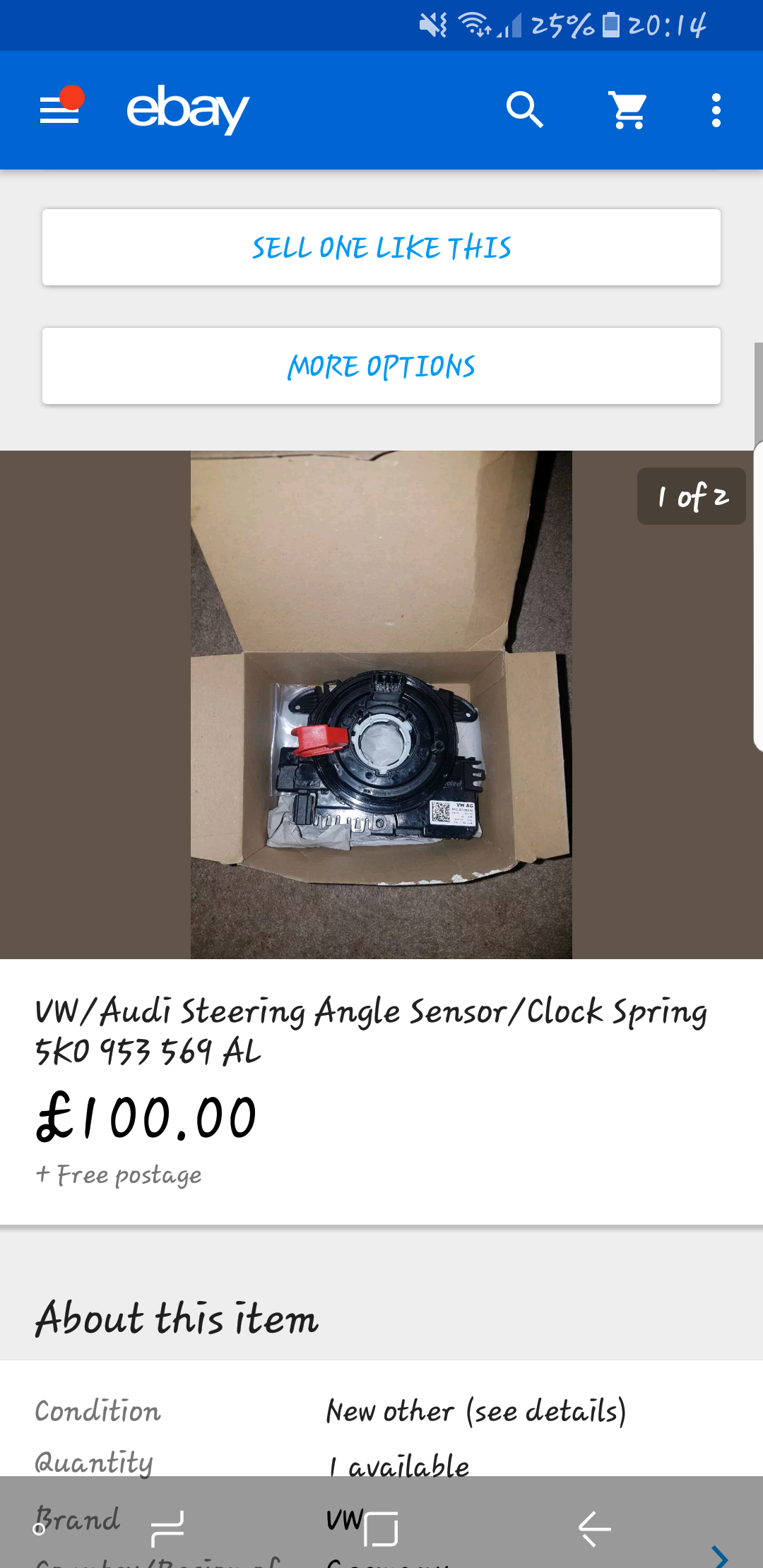

And this controller
They should work fine so will likely just be a coding issue. Like langers has said can you post a full auto scan so we can see the coding?
