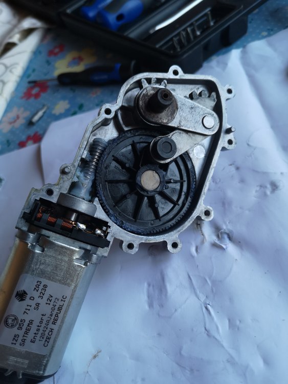

Have just taken the gear assembly outside of the housing and movement is solid.
Not sure if I should be looking at the actual motor instead of the mechanism??

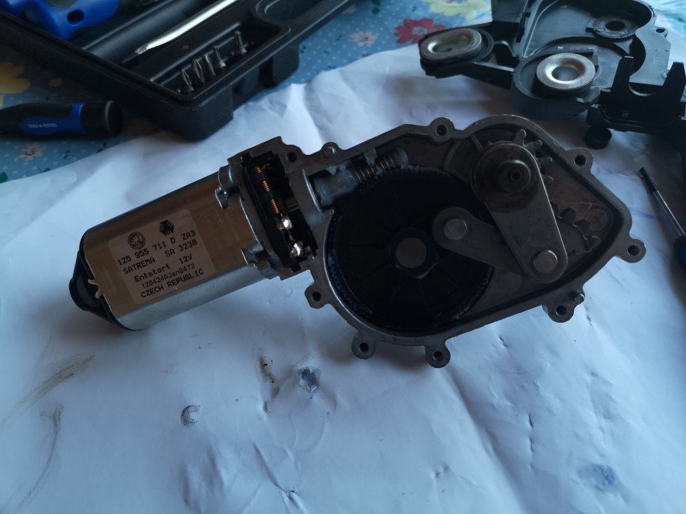

Better picture attached
The mechanism's tend to seize up and strip the teeth, thats what mine did, replace with a new one from a famous auction site; my motor was about £70.

Have just checked and I can move the worm gear... Somewhat easily...
I'm assuming that this is conclusive that it's an electrical problem, but unfortunately don't have a 12v power supply to test the motor directly....

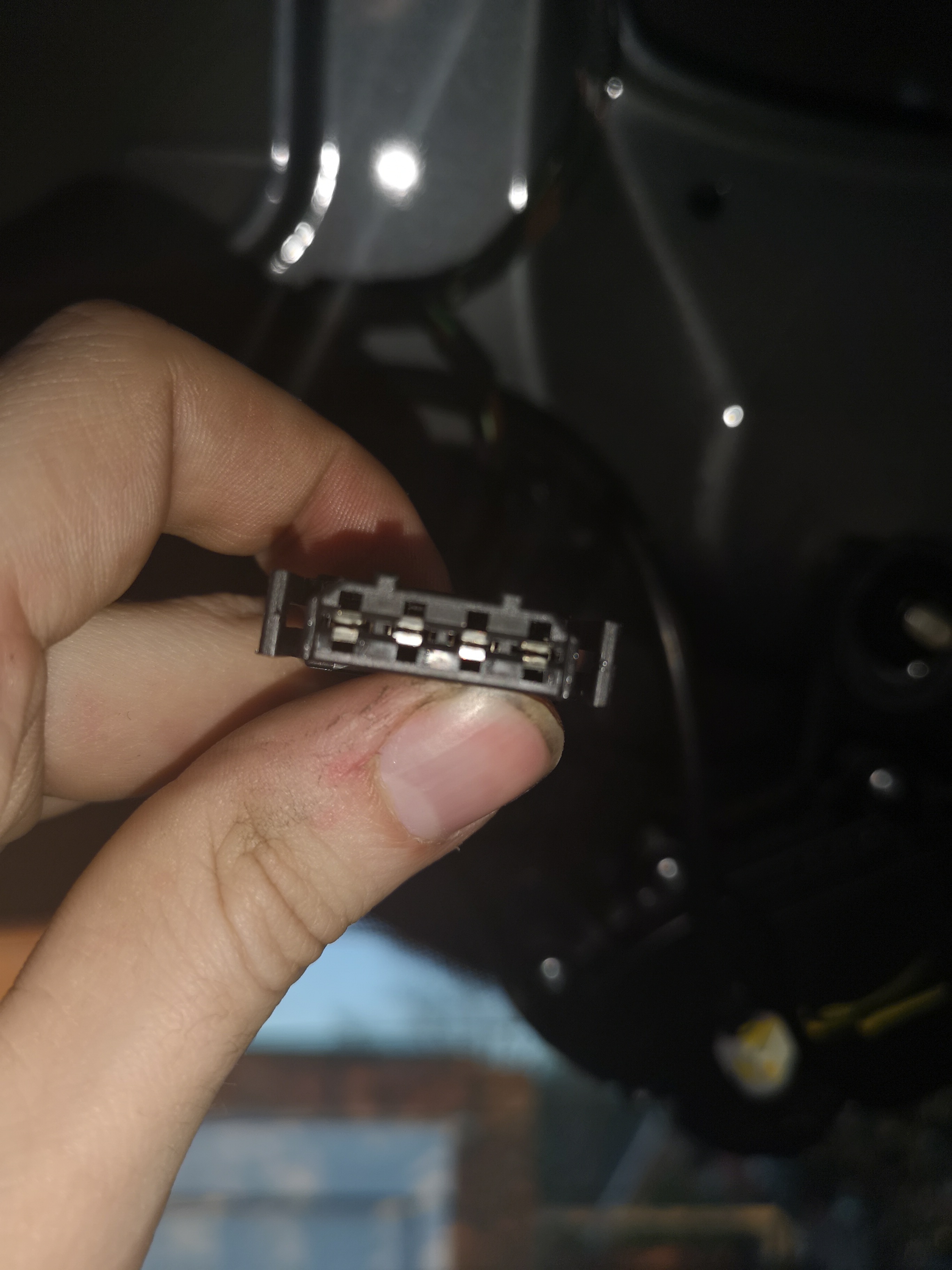

Can you take a picture of the electrical socket?
Do you have a DMM?
Assume these?
Have just put it back on the car so not the easiest to take a picture of haha,
Seem to have also got the clips in my boot buy not on the trim... Whoops
And no, no access to DMM or anything remotely useful unfortunately

The fault on mine was the same as that reported by others. Motor brushes stuck in their holders. Free up the brushes so that they touch the commutator and the motor works again. With the top lid removed (all the electronics are in there), you can test the motor by putting 12V on the contacts.
Hitting it with a hammer may be enough to disturb the brushes as they have push springs behind them and so give a tempory fix.
My view is that part of the problem is the design of the spring. As the brushes wear and get shorter so the springs extend and exert less force on the back of the brush. This coupled with the brushes being too tight a fit in the sleeves that hold them.

You can see the end of the commutator in your photo. Can you see if the brushes are actually touching the commuter. (Note that a gap of  a thousand of an inch will stop the motor working so look closely).  Just wiggling the brushes in their holders may be the only thing you need to do. I don't recommend releasing the tabs or taking the motor apart unless you know there is a mechanical problem with the two bearings.

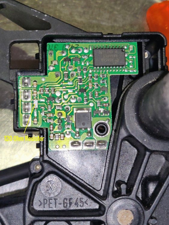

Had a look...  saw that controller board  CAN termination resistor (120 Ohm) had the resistor layer blown off - but little / no other visual evidence of other escaping magic smoke - - soldered a 1/4 Watt  120R across the two middle pins and  - hooray! - it worked.....   2p and an hour fiddling about.
Bugger all grease in the gearbox so dolloped a teaspoon (she'll kill me) of grease in there.
You can of course test the resistor by measuring across the middle two pins on the input terminals - it should show 120 ohms   etc.....

Did the canbus comms error show up on a VCDS scan?
Thanks for a good reminder of something else to check when faultfinding, lucky it had not dragged down the canbus line.
A question, its been a while since I read myself up to speed on Canbus, I think that each leg had its own 120 ohm termination resistor, does that mean that the one for the rear of the car is contained in the wiper motor? If so a fault with that could affect tailgate locking, fuel filler flap, rear bulbs etc.
I recall measuring for the presence of the EOL (end of line) resistor, hadn't realised that it was contained within the wiper motor, that brings another warning, if you remove it to work on it expect many random electrical problems.
J.R.
Nah - didn't scan  - as there's so much talk about knackered brushes and bad lube etc., etc.  that pulling the motor for a poke about seemed sensible.
The standard CAN termination is 120 ohms across the ends of the bus data wires (i.e. one at each physical end) so a properly terminated bus will read 60 ohms. I've not seen the bus topology for the wiper control but erratic operation with a missing terminator is to be expected.
Hiding the termination on the wiper control board - that's a little cheap...  you can see the missing film on the SMD terminating resistor - it should be black with numbers - just bare white pottery on that one.

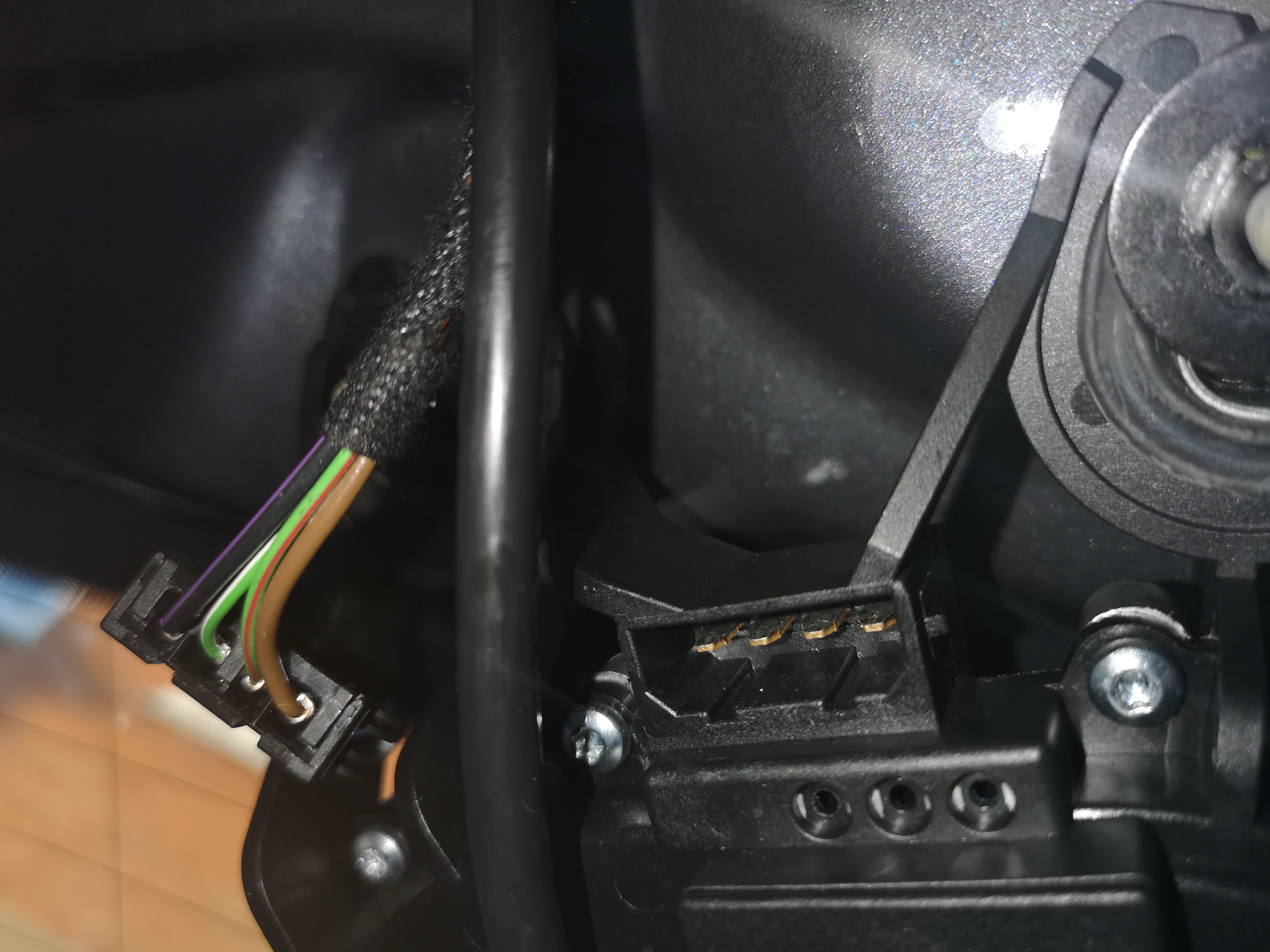

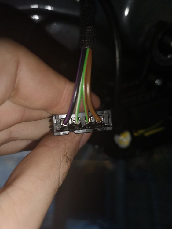

Good afternoon; I'm cheekily jumping into this thread to see if anyone can shed a little light on my own very similar version of this issue. I have a separate thread, some 5 years old now, in Briskoda for this, and have seen the motor jumping into life almost randomly on a number of occasions, but had essentially given up after it last worked back in February. However, this afternoon I've managed to test via a battery, to find that the motor is indeed working, workings greased, no worn teeth or worm drive etc. which makes me wonder where else the issue might be. I then reconnected to the rear-door connector, but it didn't work. I'm convinced the fuse is correct and working (-mine is listed as 18 in dash panel, and it's intact), which makes me wonder: is the connector prone to damage or deterioration ? Or: is there a secondary fuse at play? I've read this afternoon of a dash-located relay for both front and rear wipers, and wonder if this might be impacting motor operation. Thanks in advance.
