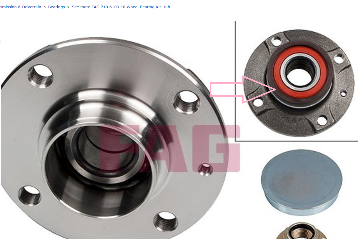

ABS ring is on the inner face of the wheel hub, as Emil says.  See pink arrow in pic below. Did you remove the hubs while replacing shoes? If so, any chance you damaged that dark coloured surface while they were off?
Thanks Wino, no I didn't remove the hubs when I changed the pads although it was all a bit tight and wiggly! Is it possible that getting the old pads on or off has damaged that area on the inner hub? Thanks
Sorry to bother you Wino but whats the material of the ABS ring and can they be repaired or replaced or is it a new hub if damaged? Thanks

I believe it's a set of little magnetic patches. I'll see if I can dig up more info from somewhere.
Much appreciated. I think I levered against the ring with a screwdriver to get some of the springs out when changing the pads.  You live and learn!
