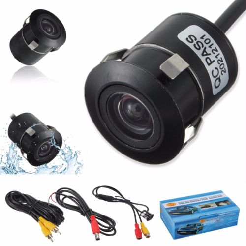

My camera kit looks like this one:

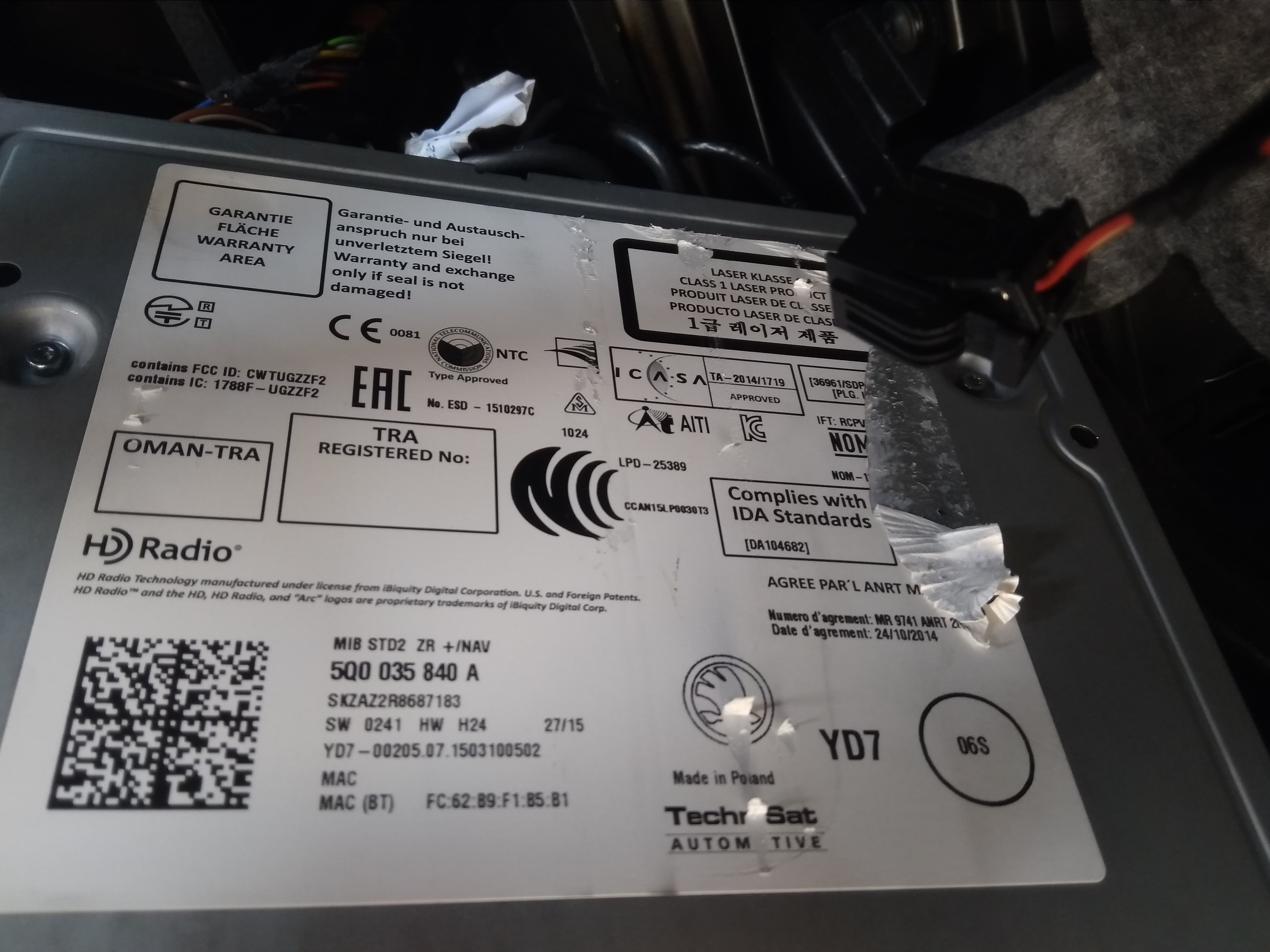

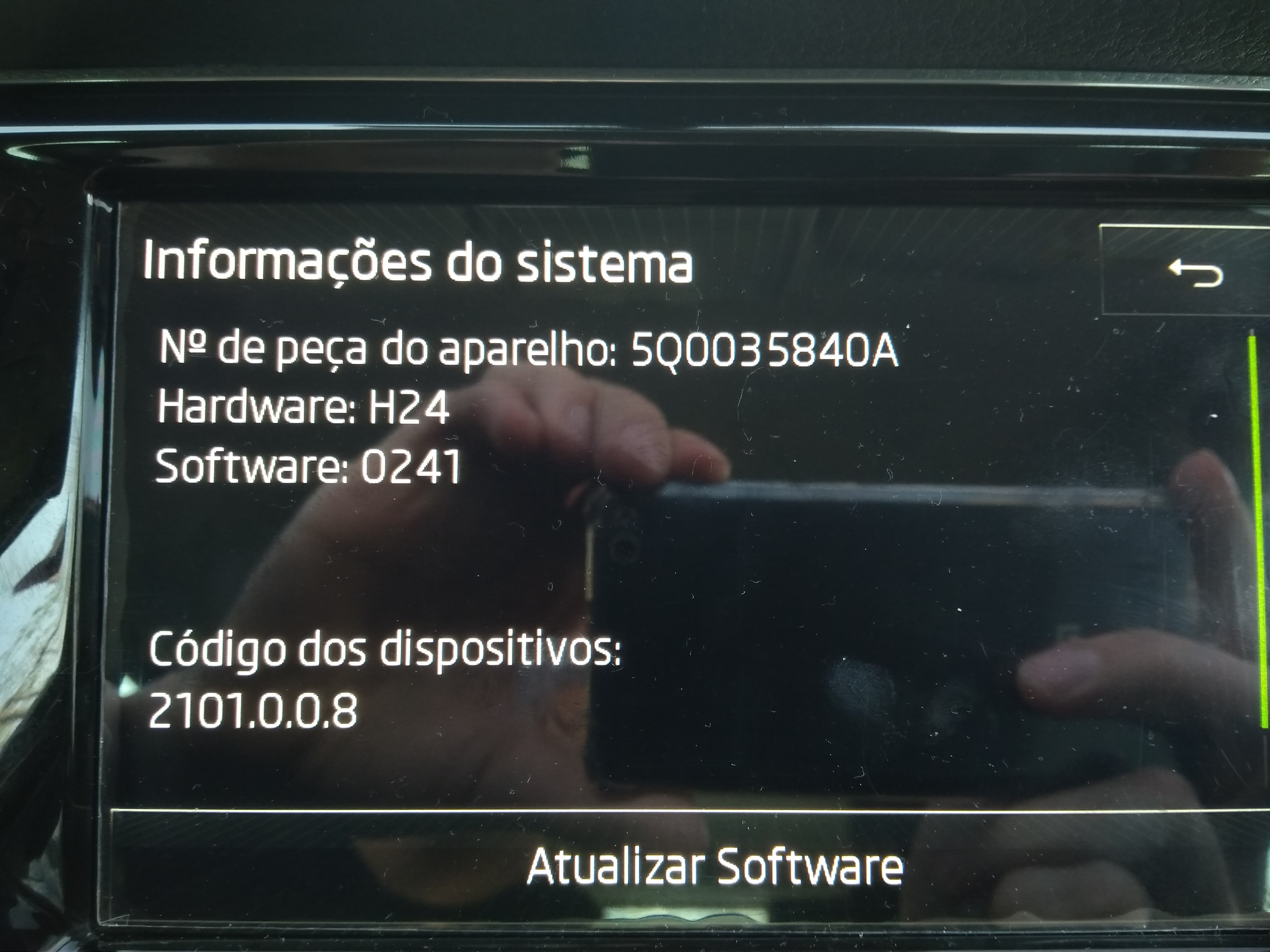

Exact model number and SW version of Bolero unit?
I hope this can help:

Sorry I missed your post. With this unit RVC should be possible :)

My kit looks like this one:
I'm my unit there's no input for the rca cable. Should I cut it to connect  it directly to the pins 6 and 12 of the blue socket?

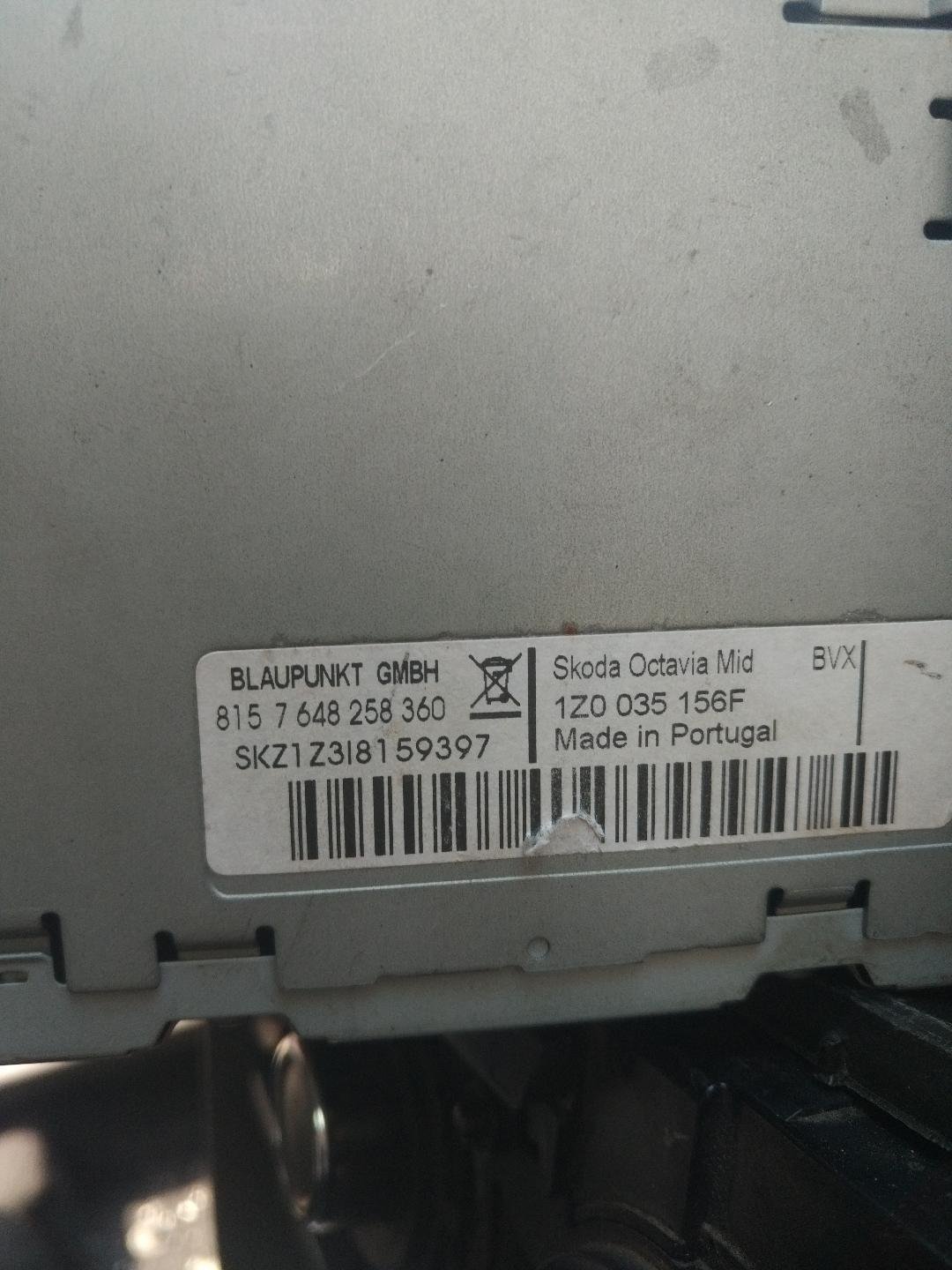

hello \i have a 2009 skoda octavia mk2 with the bolero head unit without navigation or PDC, I have installed the rvc to pins 6 and 12 please how do I code the vcds
What is your Bolero model number? Because pins 6&12 refer only to MIB units and octavia mk2 didn't have MIB factory installed.
If you don't know then post a picture.
As I expected... this is NOT MIB and it does NOT support RVC at all...
oh wow thanks a lot.Please  what OEM head unit can i get that support RVC and will fit the stick wire harness
