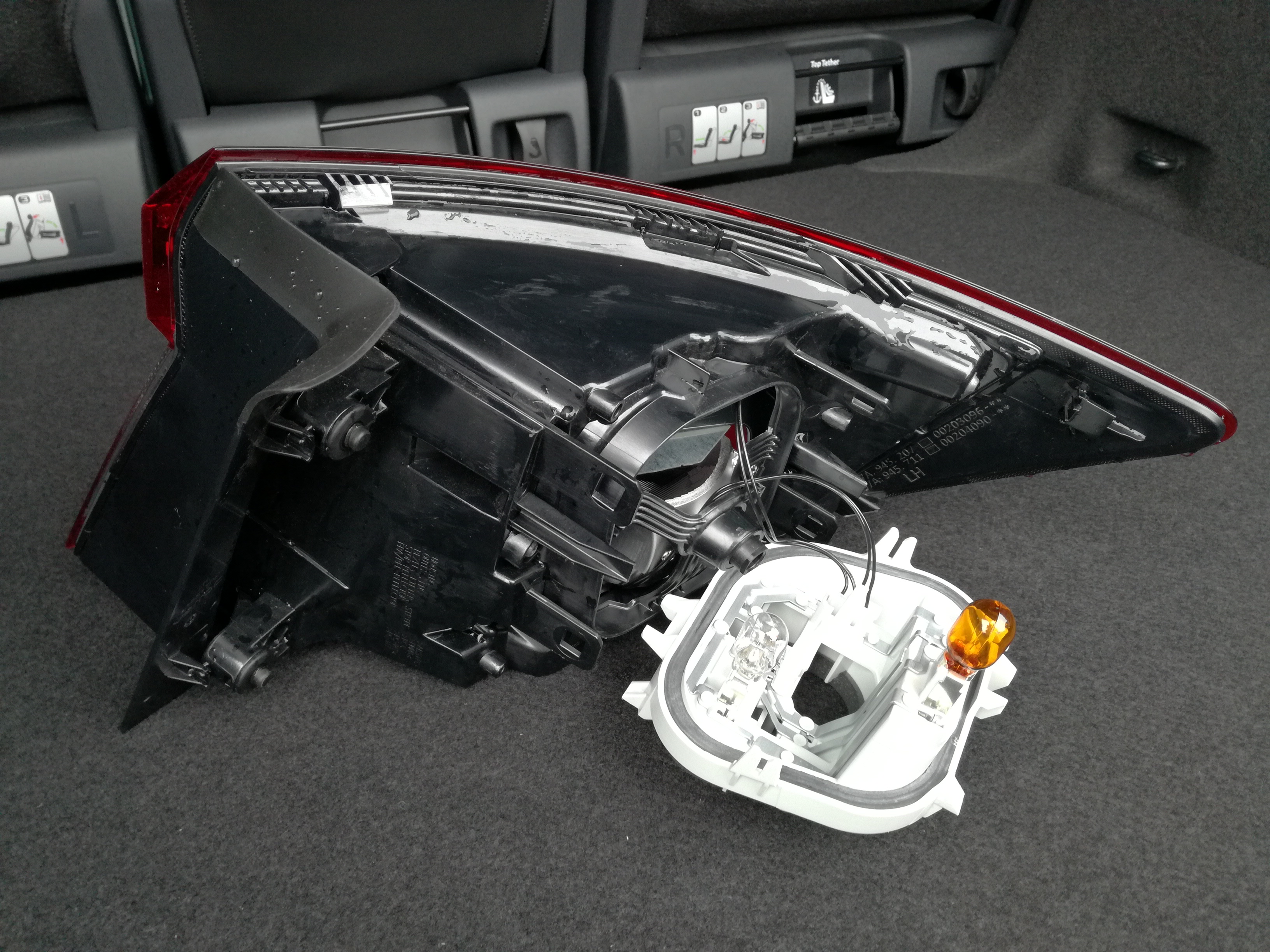

If anyone wants to convert their reversing bulbs to LED they are W16W bulbs in the edition model, not sure if all models are the same.
Its a bit tricky to change them as you have to remove the whole lamp cluster. Its only held in by one plastic screw though.
When I get my bulbs I'll put a quick guide together.
