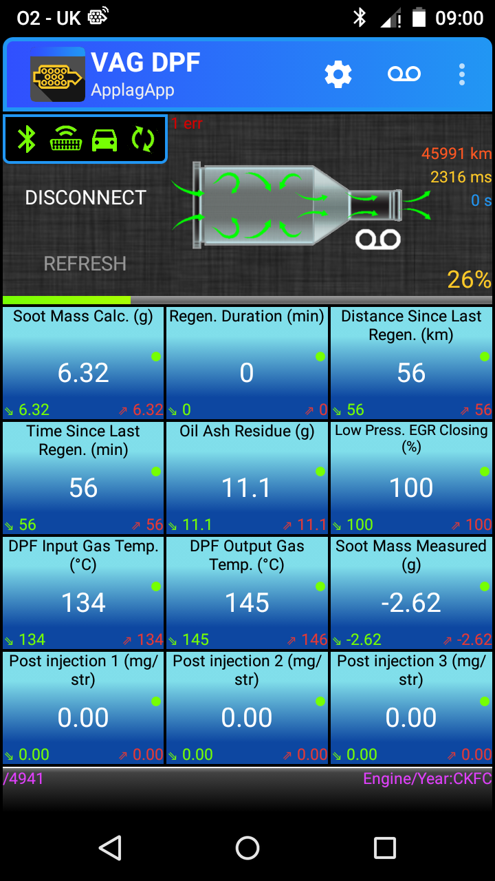

Being a diesel, I'd be nervous with a low mileage car. Bring along a OBD2 scanner and buy VW DPF app on Android. You'll be able to see how much life the DPF has left. I'd expect less than 15g oil ash residue (my one is at 28g IIRC)

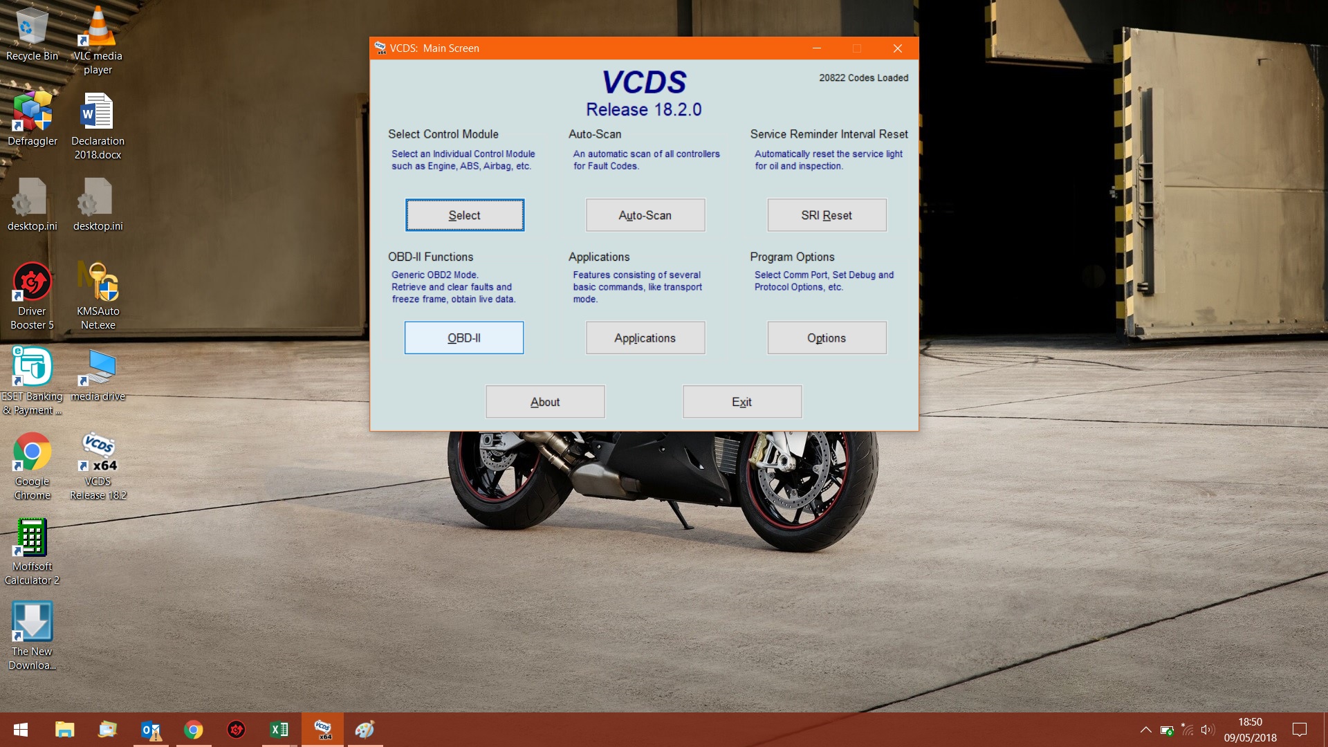

This menu which I am navigating you to has everything and anything to do with the engine. It's live data as well, as my 'soot mass calculated' went up by 0.01g when I was sorting the screenshot out.

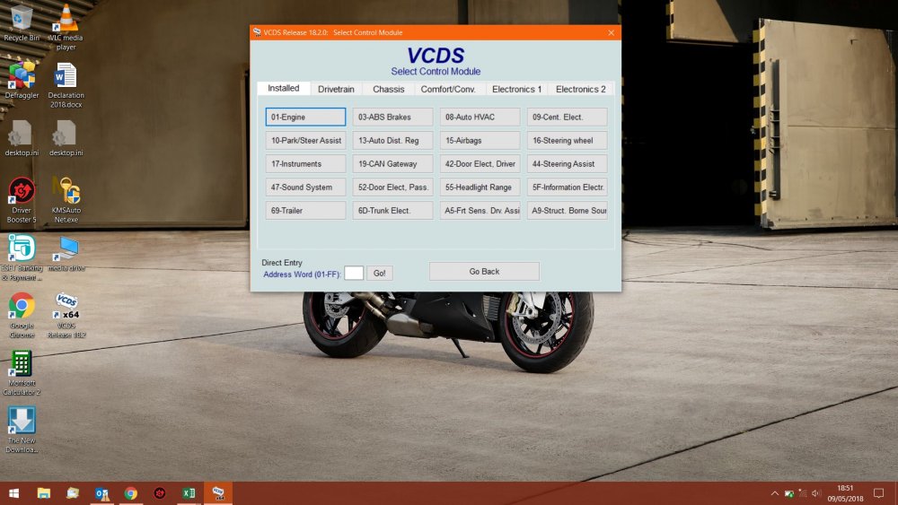

First of all, go on to ' Select Control Module'
Then click onto '01-Engine'

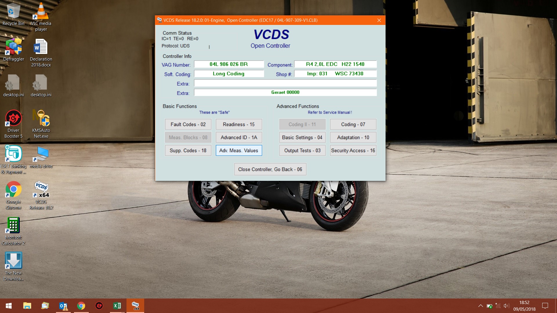

On the 'Basic Functions' section on the bottom left, you click onto ' Adv. Meas. Values'

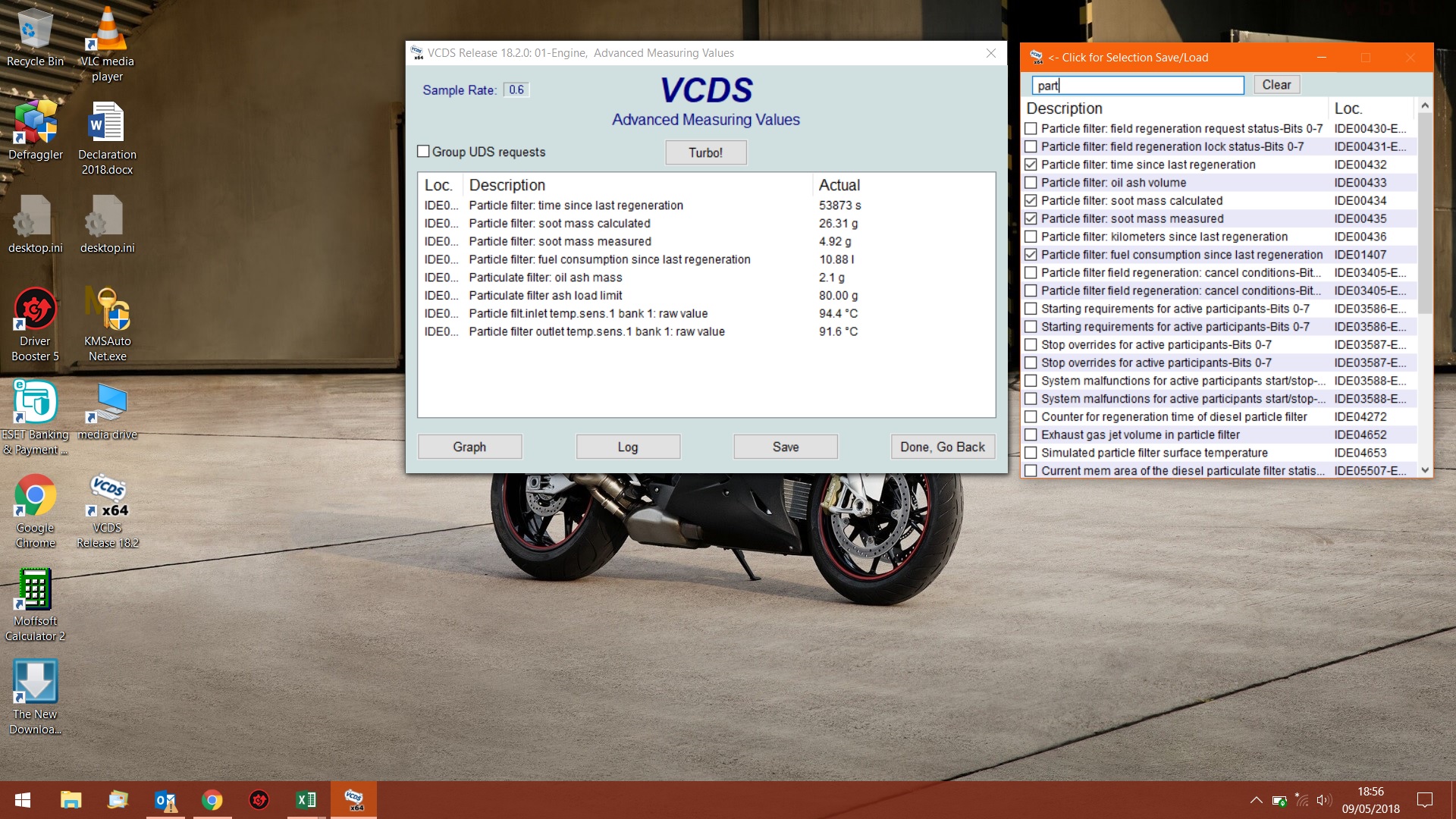

And then the below menu will appear. On the box on the right hand side, you just need to type in whatever it is you're wanting information for and then tick the box, so the relevant information appears in the results box on the left hand side. I started typing particle in (dpf doesn't bring up a lot) and I selected the bits you can see below. Soot mass and oil ash mass are the main ones to be concerned with. As is the time since last one and what the temperatures are (I'd imagine they'd be considerably higher after driving a bit. I only turned the car over on the drive)
Hope this is of use to you all.
