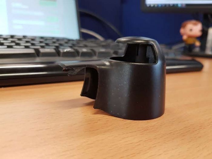

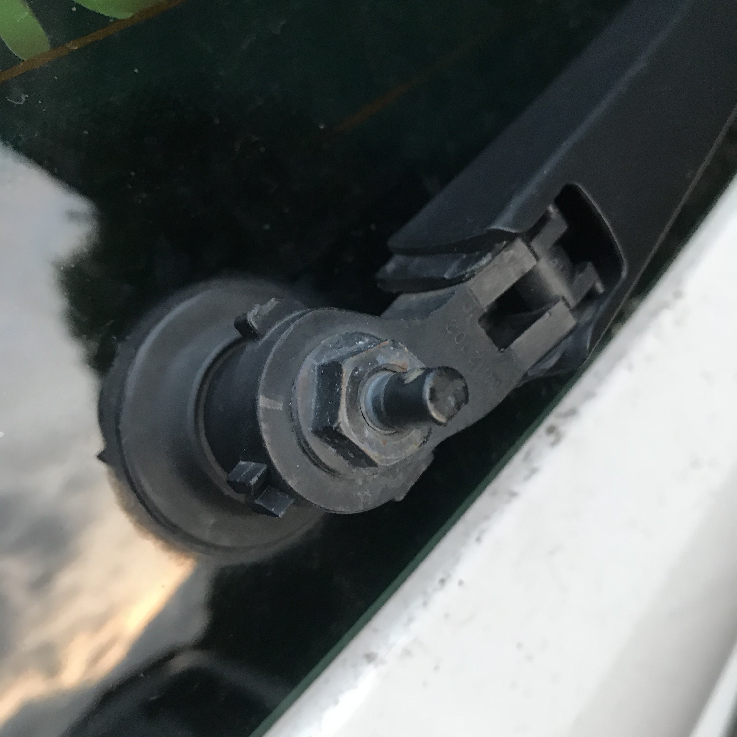

So somehow the cover over the rear washer on the wiper arm went missing from my car a few weeks ago.
i ordered a new genuine one and it doesn’t seem to remotely fit.
Anyone had had to replace this before? Is there a specific way to fit it or himageproxy.php?img=&key=66c1d7df650950daave I got the wrong part?

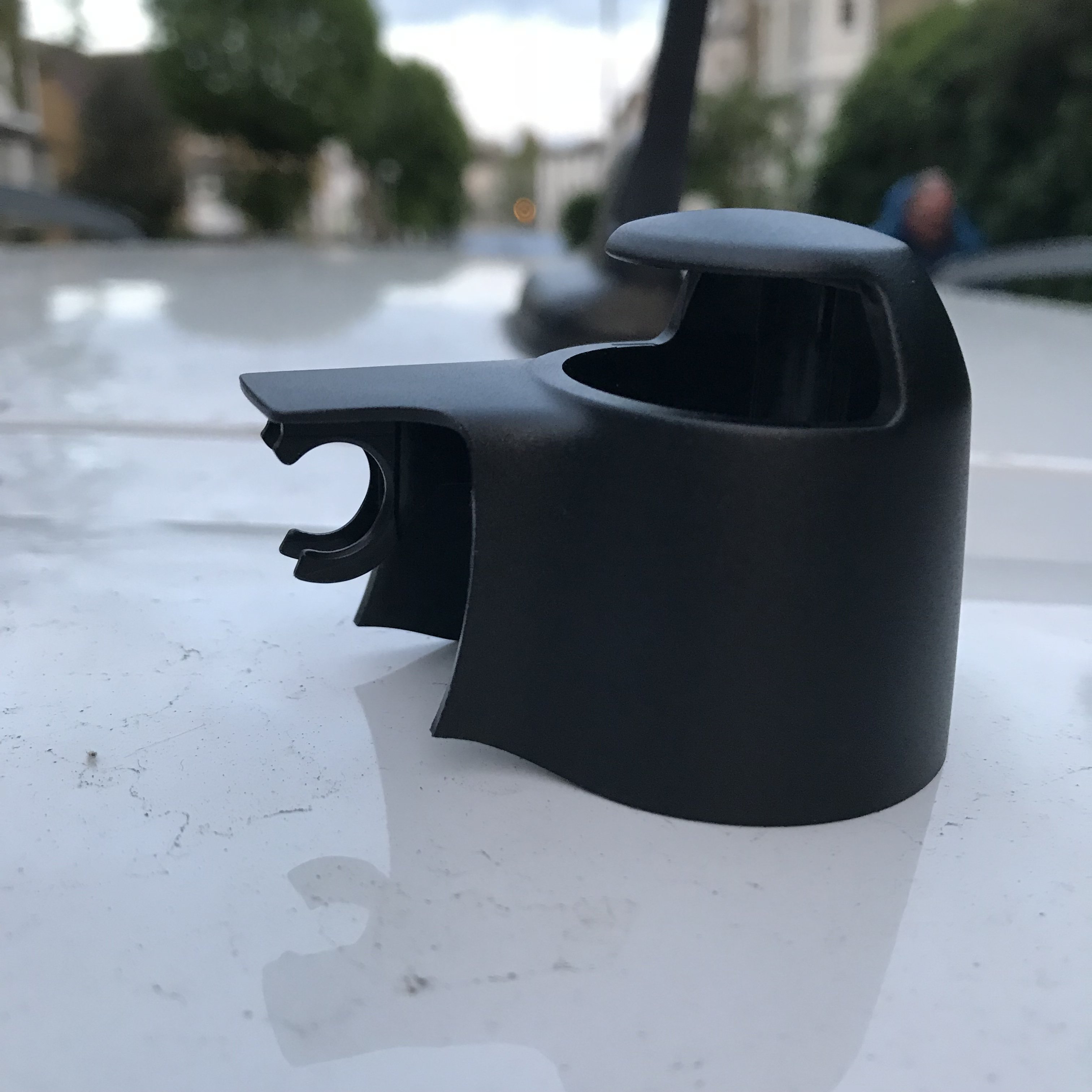

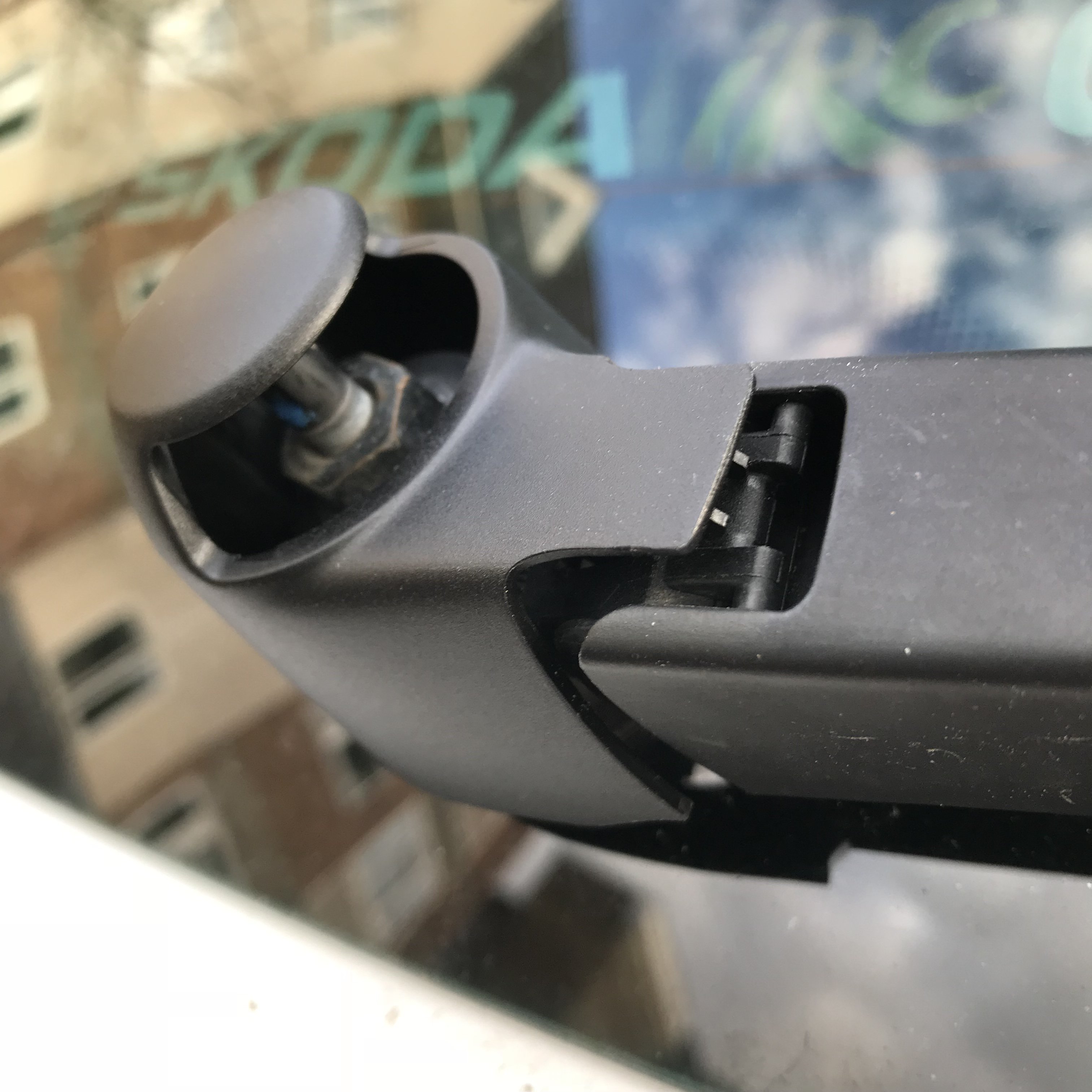

It looks like there is a change to the wiper from May 2013 onwards. My car is registered Feb '14 on a 63 plate which means it has the rear aero wiper, which the earlier cars don't seem to have.
This one looks like it should fit, part no 1K8955435
