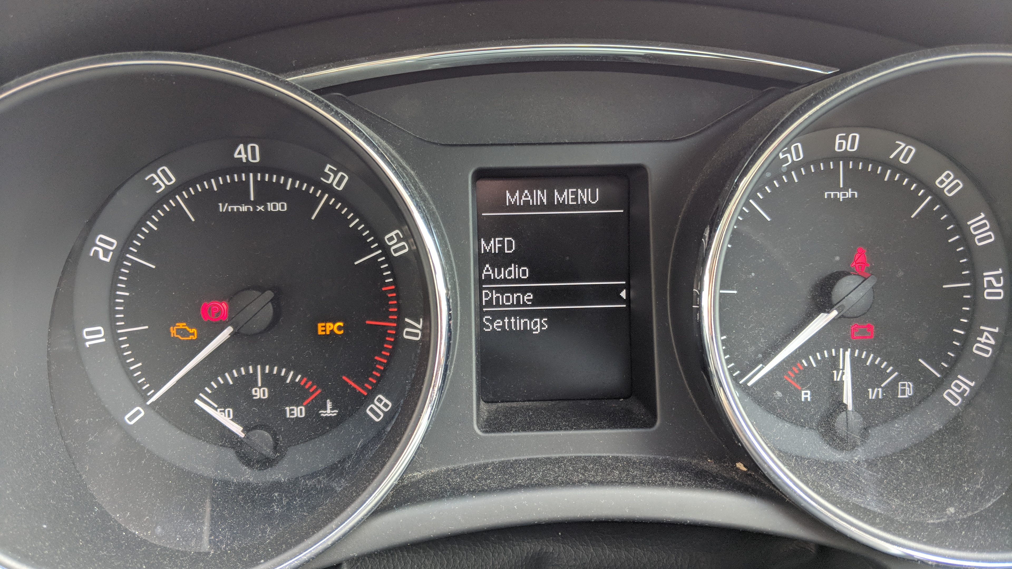

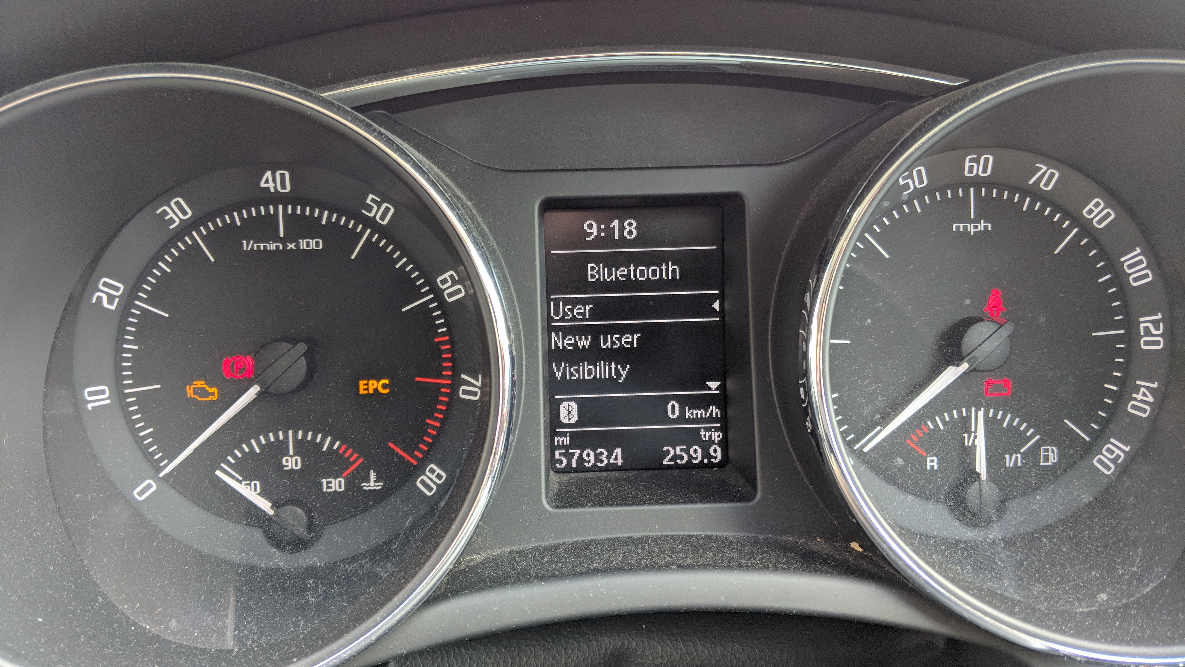

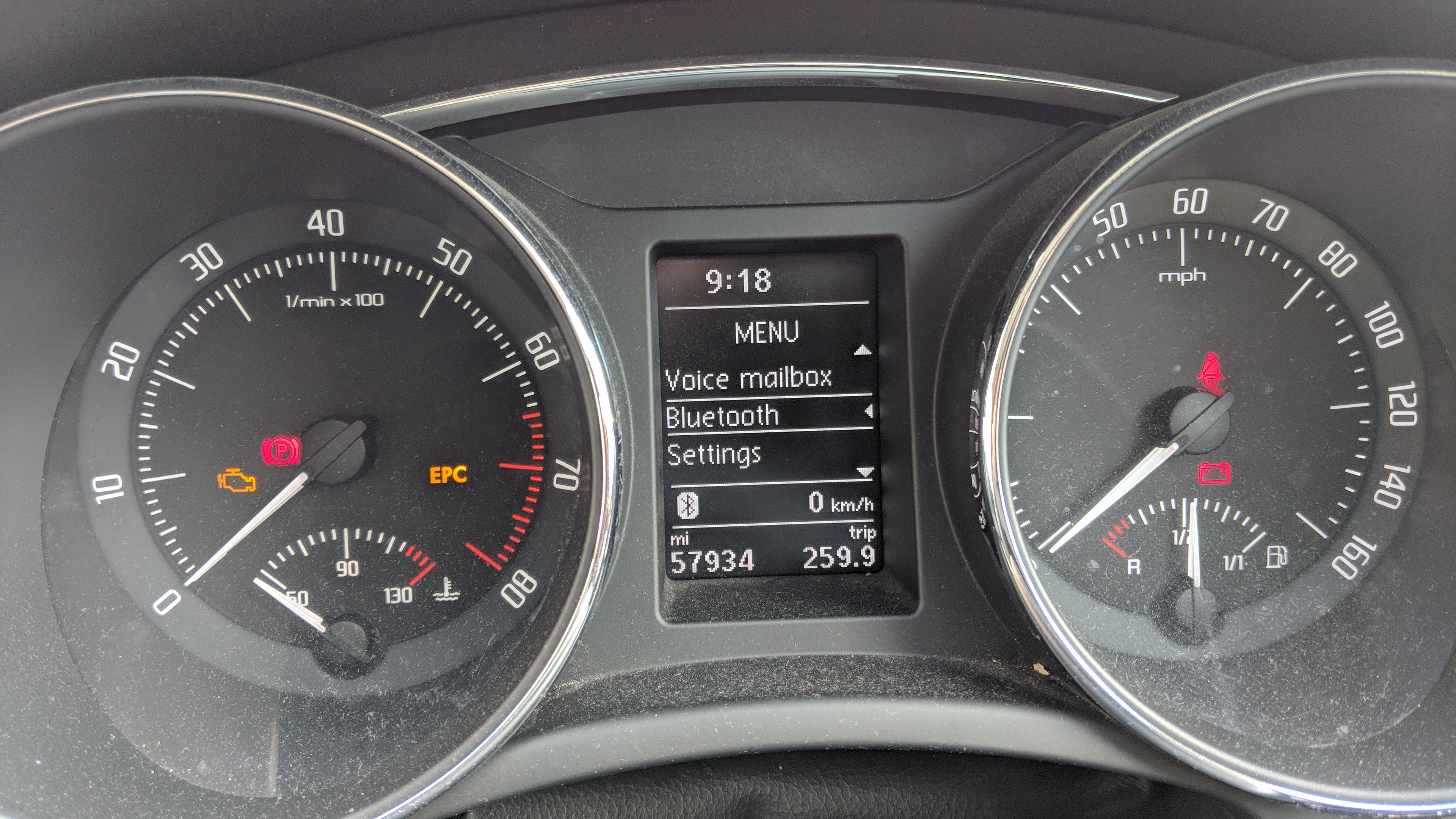

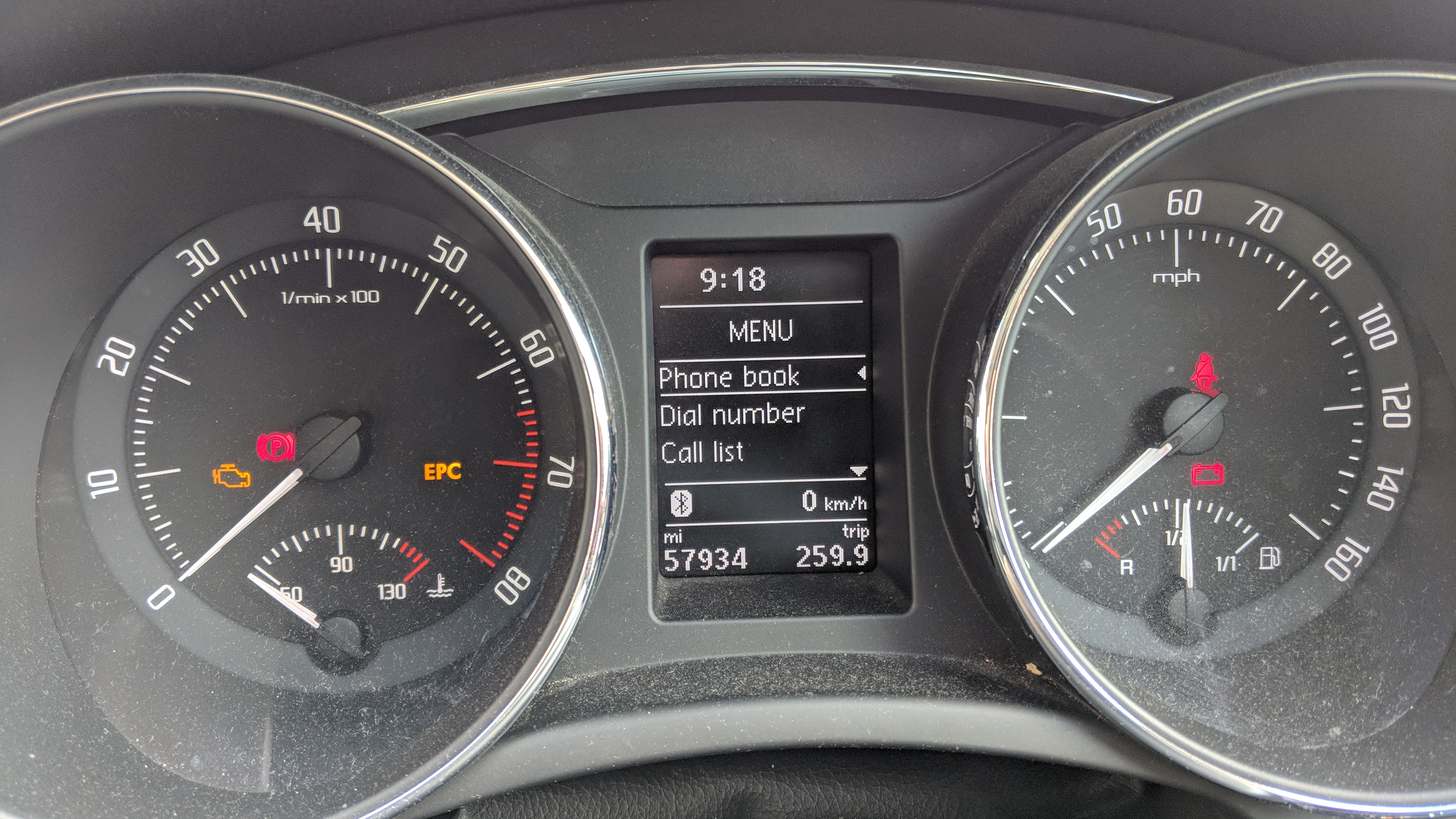

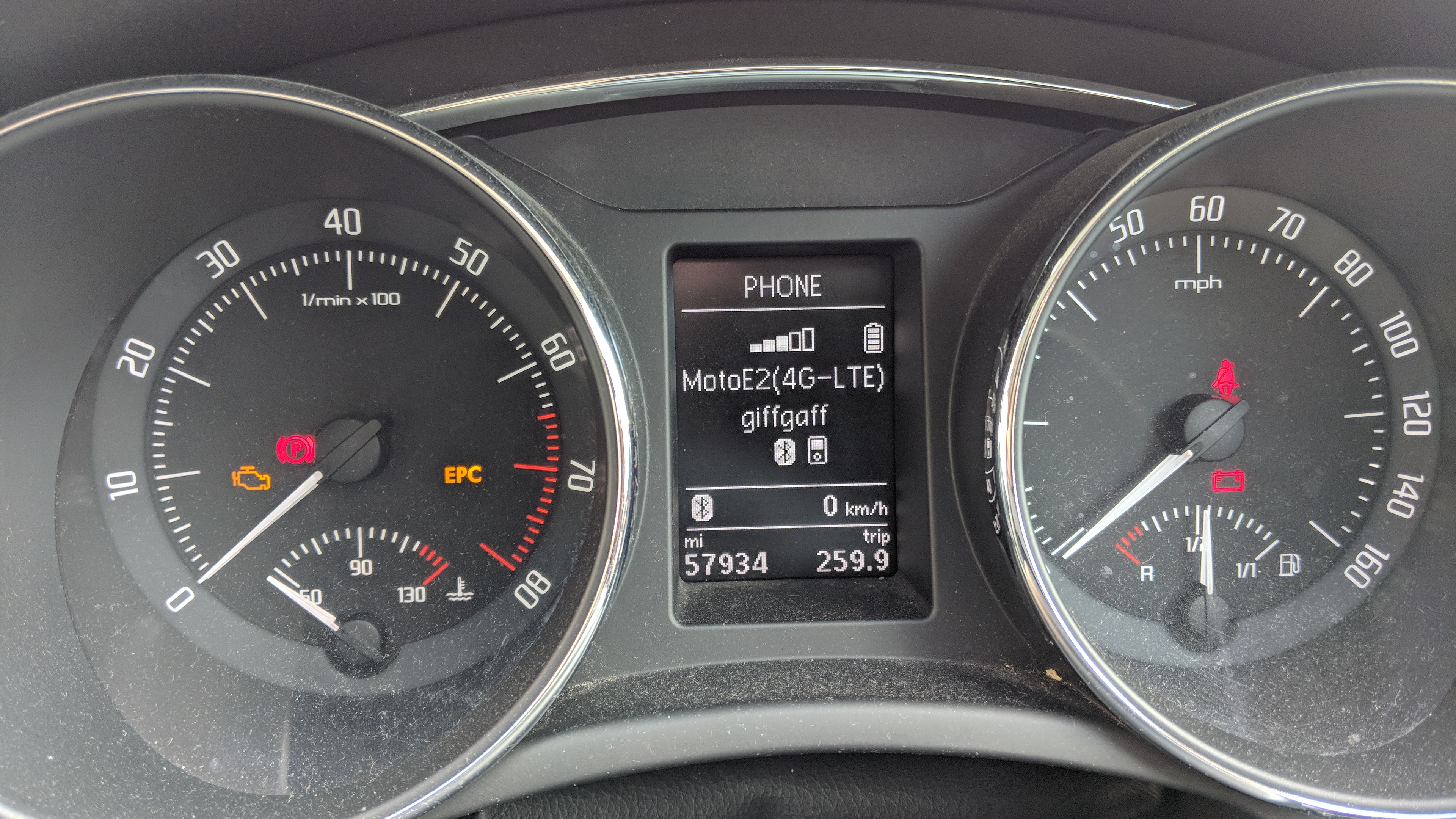

I've tried to screenshot showing bluetooth menus

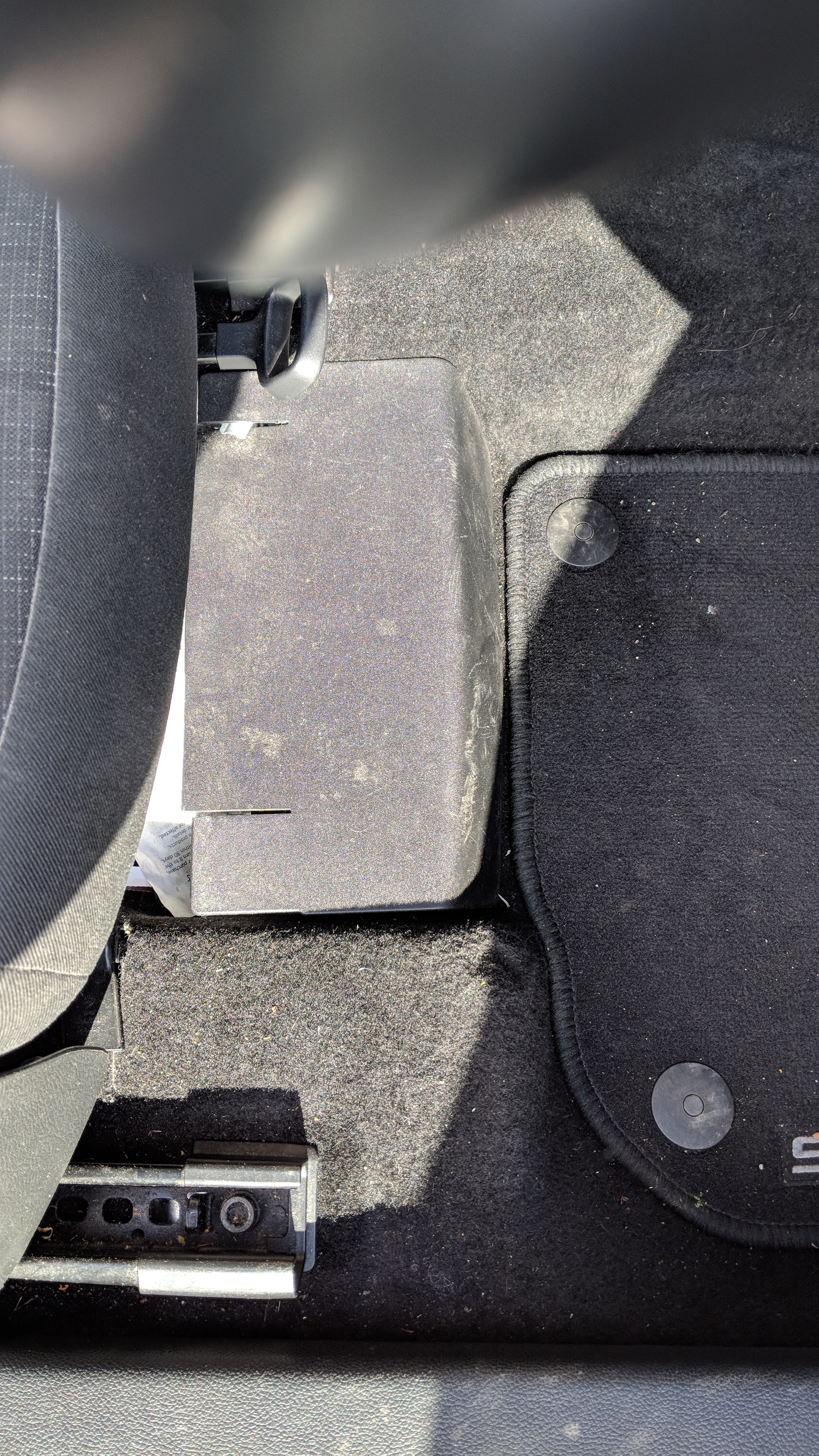

Note to self , time for a spring clean inside the car!

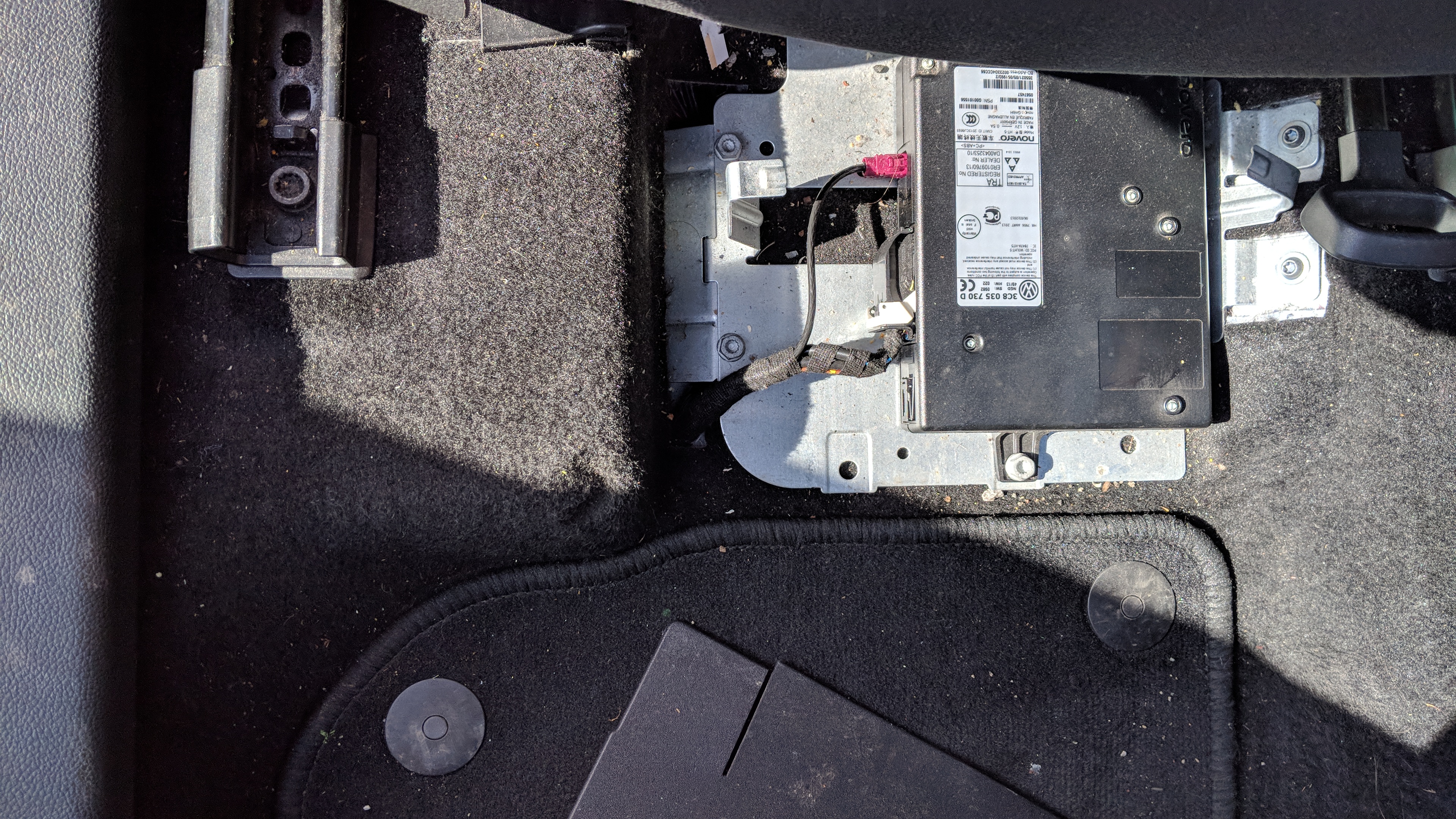

Bluetooth module under/front of the seat , and with it's plastic cover removed:-
Edited by bigjohn
