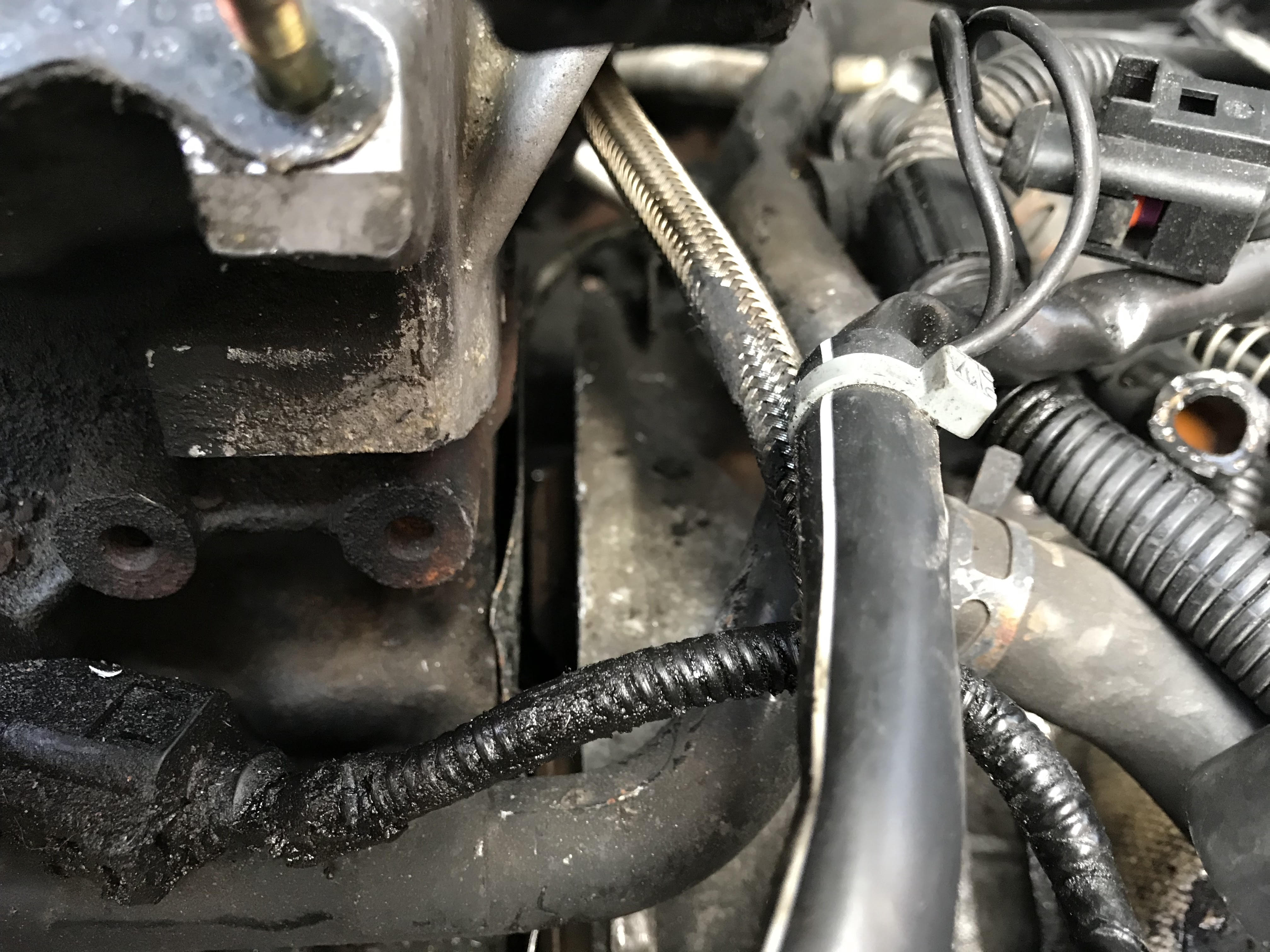

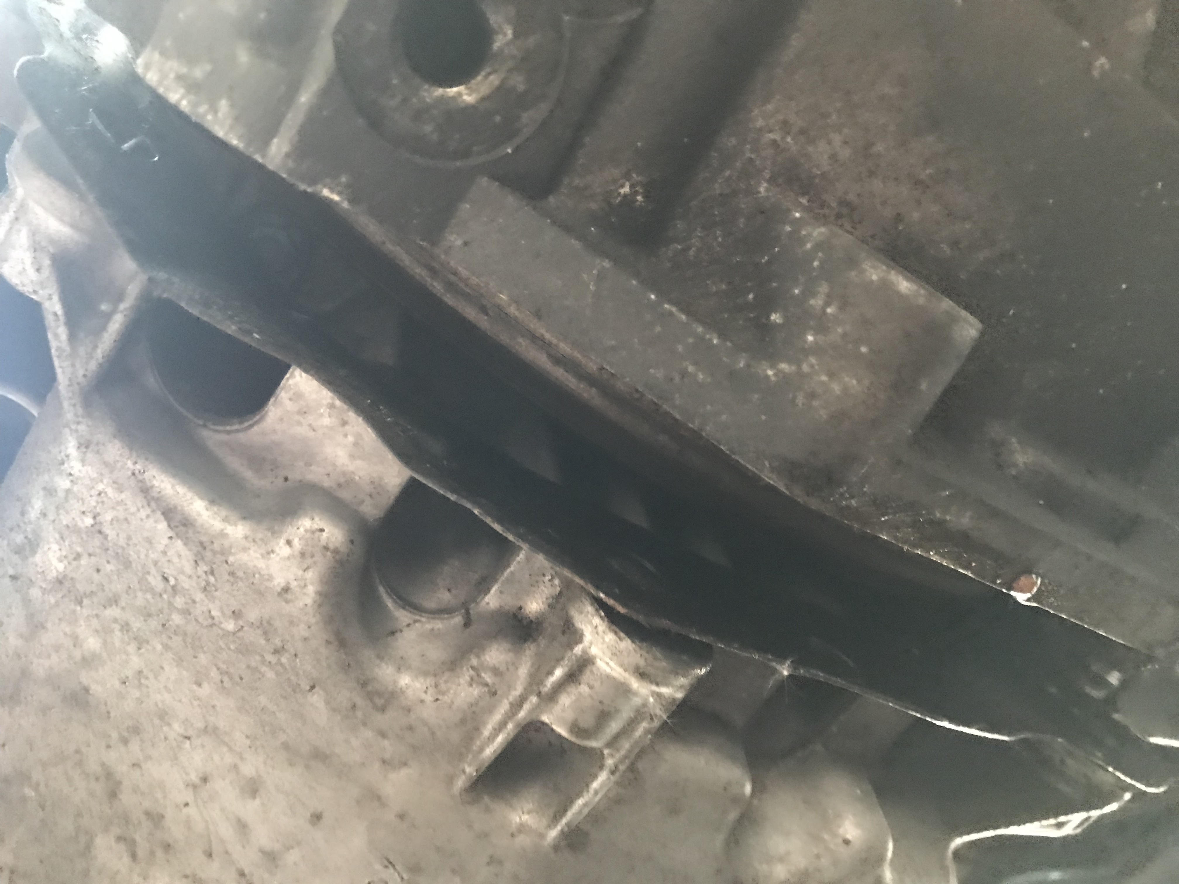

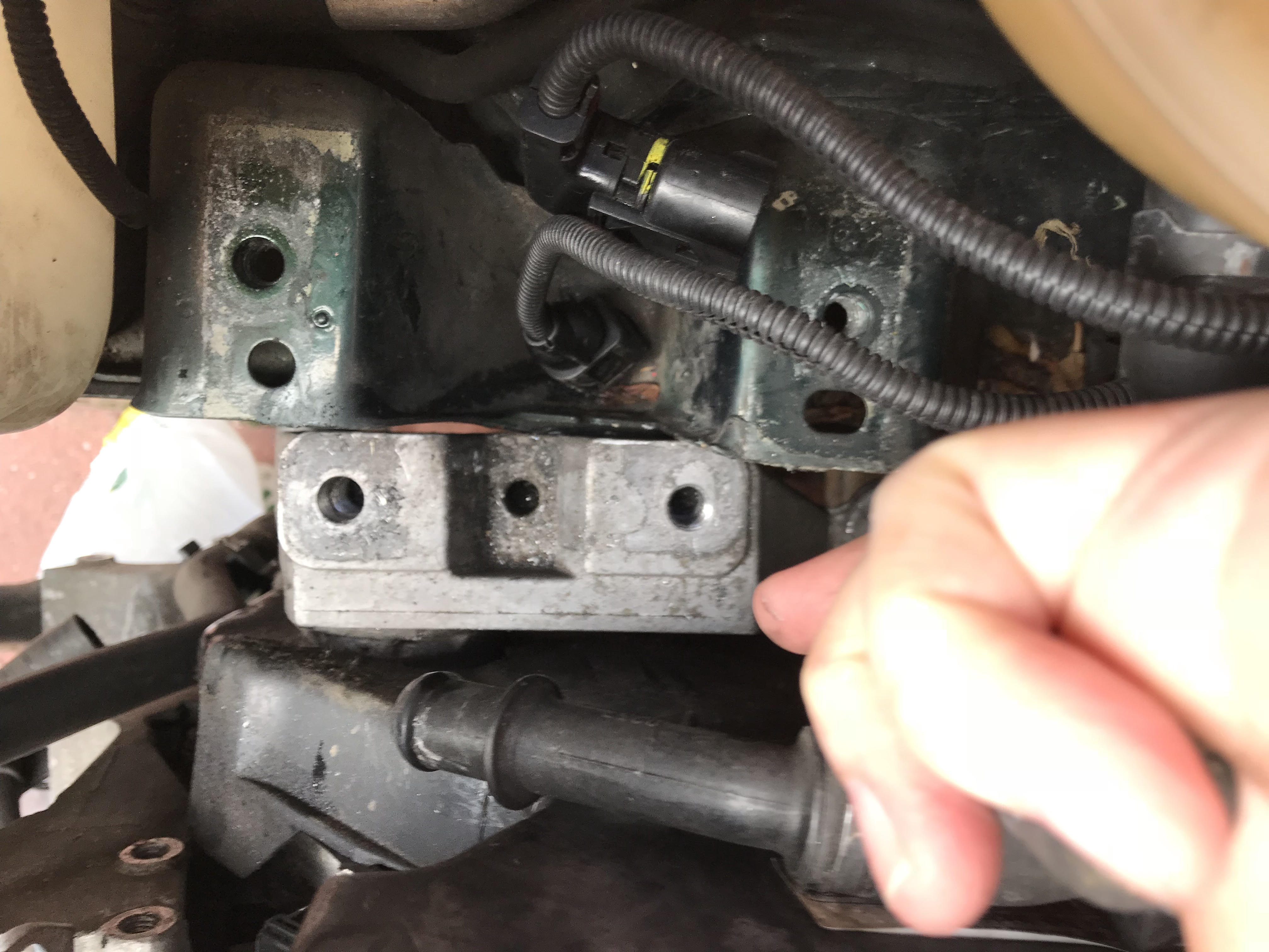

Could do with some advice from someone who has done this before because there must be something I have missed somewhere.  I have removed pretty much every bolt I could locate apart from the 4 down pipe nuts, they are rusted on solid so I decided to unbolt the entire turbo from the engine and turbo manifold.  Removed all bolts from transmission and unbolted upper engine mount and dog bone mount.  I`m lifting the engine and using a crowbar to help pry it away from the transmission.  I can see a gap growing between the transmission and engine.  But when I get it pryed so far the other side the lower section of the upper engine mount is pushed up tight against the chassis... so the engine cannot move any further, its like jammed between the chassis and gearbox...  I really am confused as to how I am going to get this engine out?  I lift with my engine crane and it gets to a point where it starts to lift the entire front of the car.  :(
I have attached some pics.
top of gearbox  - 1st pic
bottom of gearbox - 2nd pic
upper engine mount side where the bracket is coming into contact with the chassis. - 3rd pic

The input shaft will still be engaged with the transmission, you need to pull the gearbox quite a long way off to give the shaft enough clearance to get around the clutch.
You'd be better off leaving either removing the gearbox on it's own first or just leave the engine and box bolted together and removing as one complete unit.

Ok update, I got the engine out without removing drive shafts or gearbox.  It is possible... but my god it was a pain in the ass!
When the bracket below the upper engine mount is completely removed and the gearbox mount is removed there is enough room to wiggle the engine off the gearbox.  But in future I will definitely remove the two drive shafts and remove engine + gearbox together!  :)
