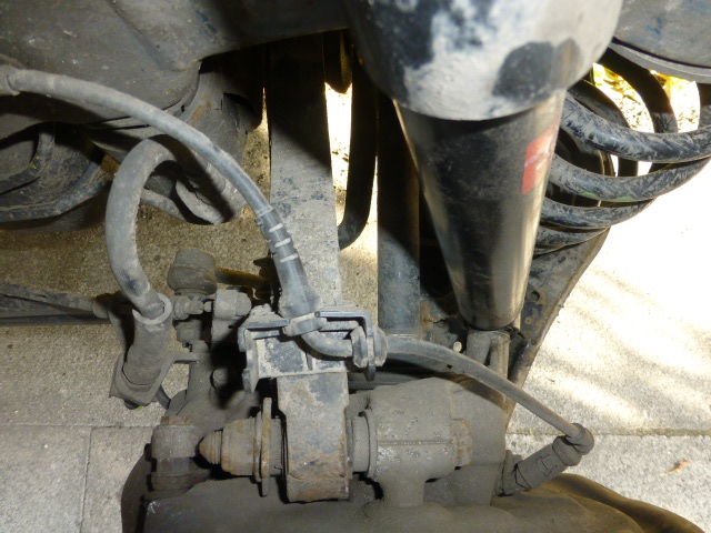

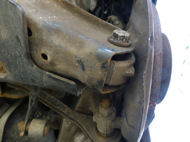

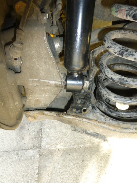

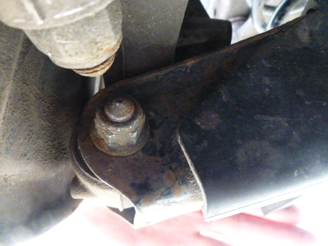

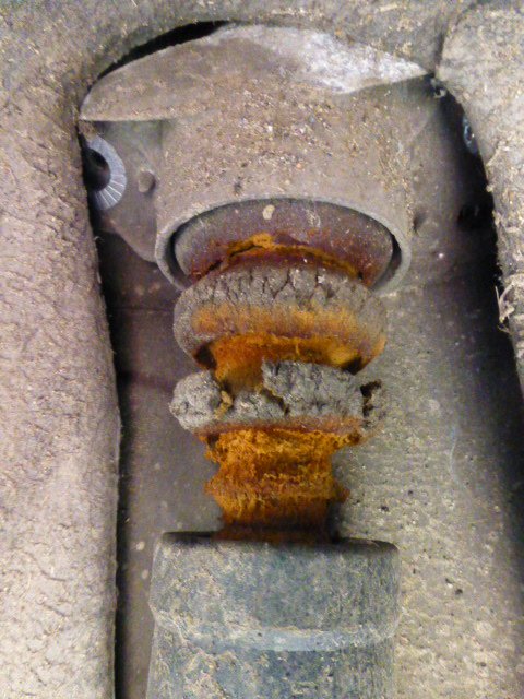

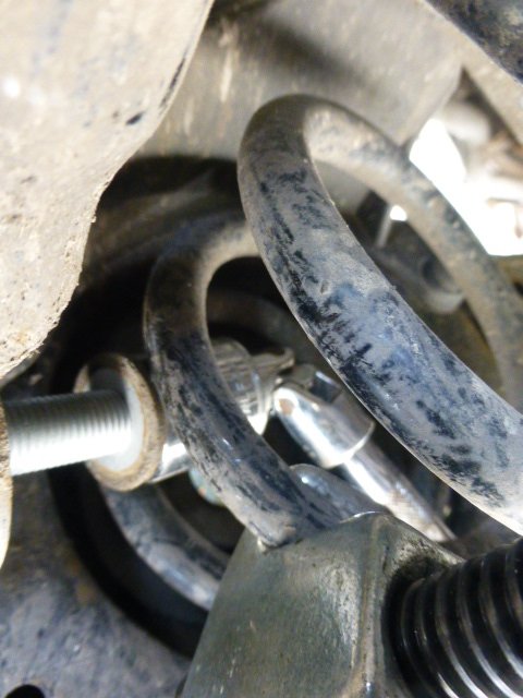

Hi All, Managed to fit one shock absorber but on the second one the lower bolt is a pain as it wont go in straight as the spring is in the way as the extra long bolt comes out even after using a spring compressor you cannot get a spanner in ! also changed the bump stops, please see attached pics as there is a driveshaft in the way on the scout, I am suspecting a bush under the control arm ? that the spring is mounted on (see pic) anybody know what its called or a part number ? cheers Stuart
All you need to do is jack up under the lower wishbone, undo wishbone bolt, lower jack to release spring tension.
Then you have access to the shock bolt and you don't need to faff around with spring compressors
After you have done the shock, pop the spring back in and raise the lower arm with the jack until you can get the bolt in. Simples
Edited by SuperbTWM
Thanks for that I will try it tomm  :cool: I did try to support the wishbone and hammer it back but the bolt was solid,  do you know what the bush is called at the end as I presume its seperate and replaceable ? cheers Stuart
Before you go replacing bushes I would give them all a good spray with a silicone based lube. There is likely plenty of life left in the bush they just sometimes get a bit dry and creaky
Hi thanks for that, I bought some bushes thinking they were worn but when I dropped the arm they were solid so I didn't change them, just waxoiled some metalwork on each side so I will put the car back on the road in the morning and have a test drive to see if the noise has gone ! ps  I presume if I needed to change the bushes they would press out ? cheers Stuart
