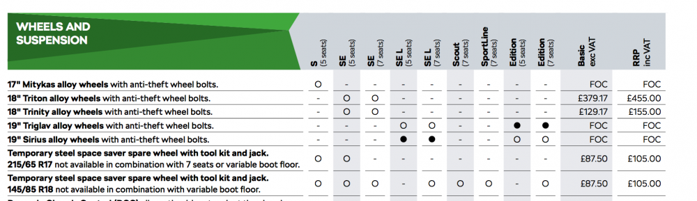

Its nice that you had that option! In the UK they most specs can only have space saver spare wheels (All specs except "S" have 235 width tyres, "S" has 215/65 R17). On some specs you cant order any spare at all!
5b07bba4be181_ScreenShot2018-05-25at08_29_33.thumb.png.dc766a729aa82387dbb2c4a4089fda2f.png
Most dealers can now supply an add on kit that allows a space saver tyre, jack etc to be installed on those Kodiaq’s that don’t have it as an option. I’ve one installed on my five seat SEL.
Do you have any part numbers? They'd be very handy.
