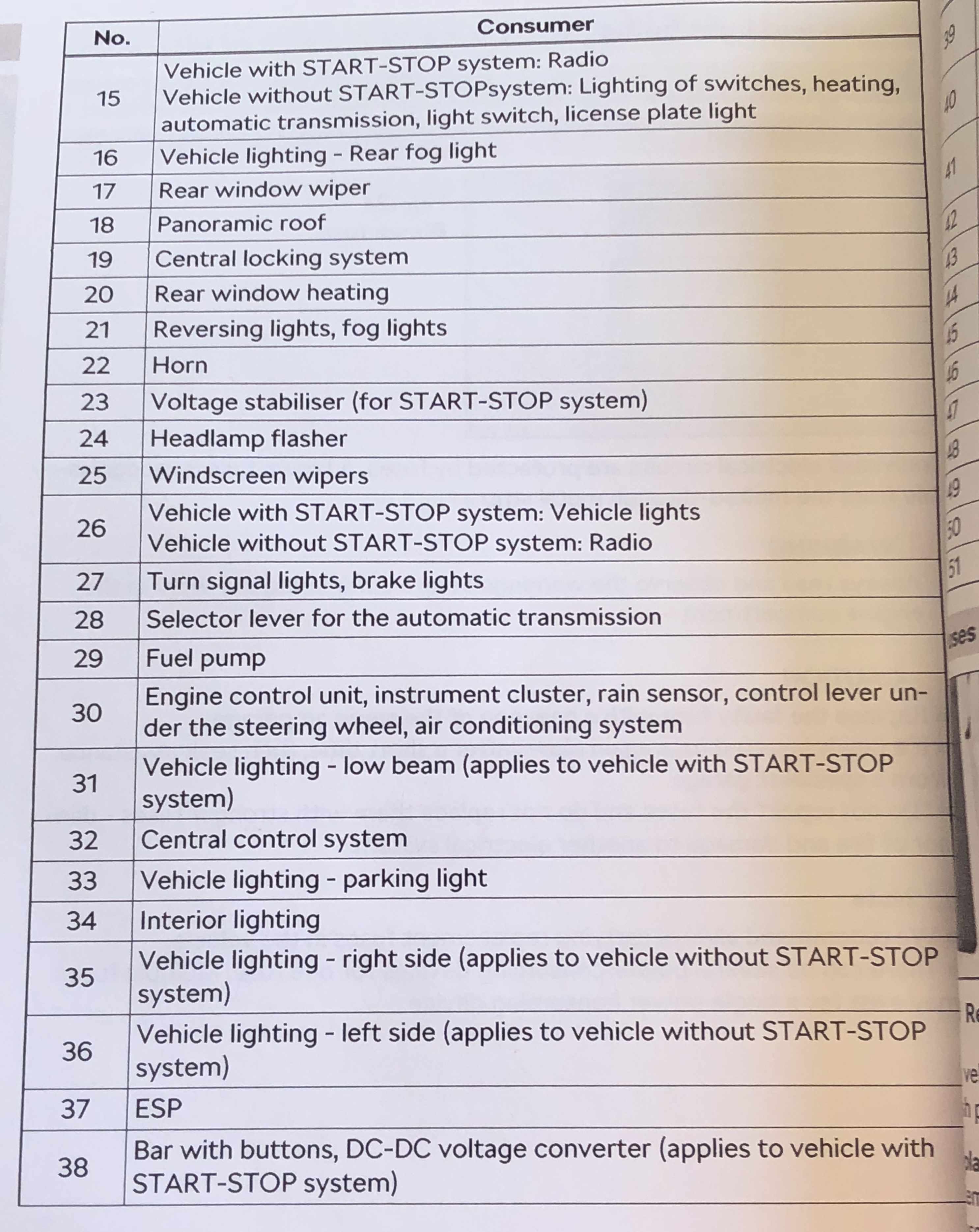

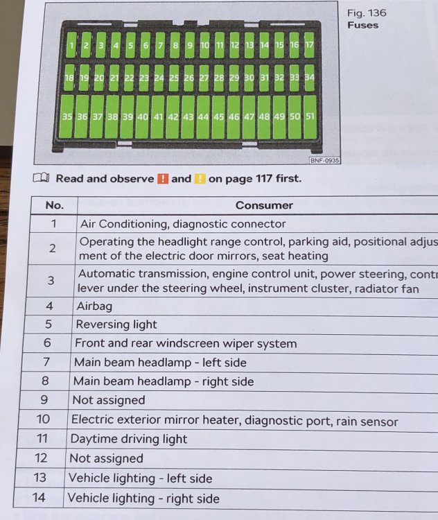

I'm attempting fitting the Dash Cam to the Wife 18 plate CitiGo. I'm hoping to piggy back the rear wiper fuse.  Looking on page 118 of the handbook there are 3 fuses for the wipers
Fuse 6, Front and rear wiper system
Fuse 17, rear window wiper
Fuse 25 Windscreen wipers
 Can anyone advise me please on which one should I use ?
Thanks AG

If you have a multimeter then check slot 12 to see if it’s switched or constant live.
i.e becomes live when the key is turned on. If it’s switched then then that should be fine to use.
Only caveat is It then depends on whether the camera has a parking mode where if it’s bumped when your not there then it auto starts recording. In that case if it has no internal battery, or a small capacity then it will need to be a constant live I think and not just switched.
What do the instatallation instructions say about power supply??
On ‎25‎/‎05‎/‎2018 at 13:43, Auric Goldfinger said:
Can anyone tell my please which fuse is  "Switched Live " or which fuse/holder to use. ( a photo would be helpful please )
I'm going to attempted to fit the dash cam over the weekend.  I have already informed the Fire Brigade of a possible call out
Thanks
AG
From the Citigo manual online (latest one) fuse 46 is the 12v-power outlet (AKA cigarette lighter). This is normally a switched live and would be useful to piggy-back off. You didn't show fuses 38-51 assignments in your photos...
