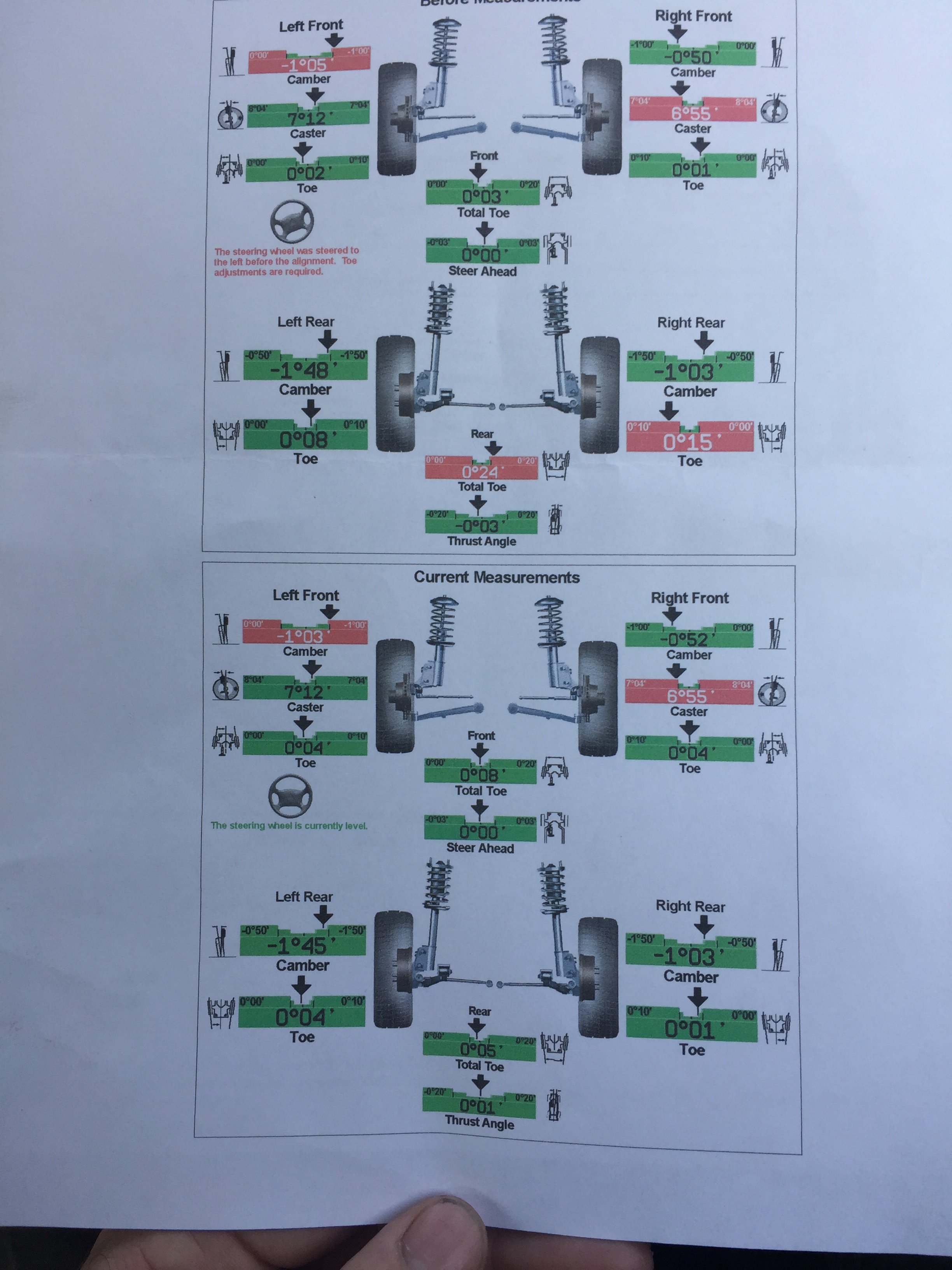

Just had 4 wheel alignment done, back tyres wearing on outside
picture of before and after, so am asking if any one with experience knows of what’s been done will cure the problem before I swap the tyres front to back ???
cheers

Presumably based on rear toe being out when you went to have it checked and adjusted could have contributed to the wear?

why am asking is all I could hear was f*** this and f*** that.  I said the front was alright but he said the steering wheel wasn’t straight, I said thought it was and never noticed before and said I was more bothered about the rear, reply was machine sez. But how does it know the steering wheel isn’t straight ??? Any ideas ??? Does he line it up ??? Because I now think am pulling down to the right cos when I level it up the car goes to the left

Once you adjust the back the front goes out anyway. They told me that and it happened too a couple of weeks back on my Superb. Depending on the tyres and road cars can pull sometimes. Try on a flat road.
Right I see, didn’t think that would effect the front
