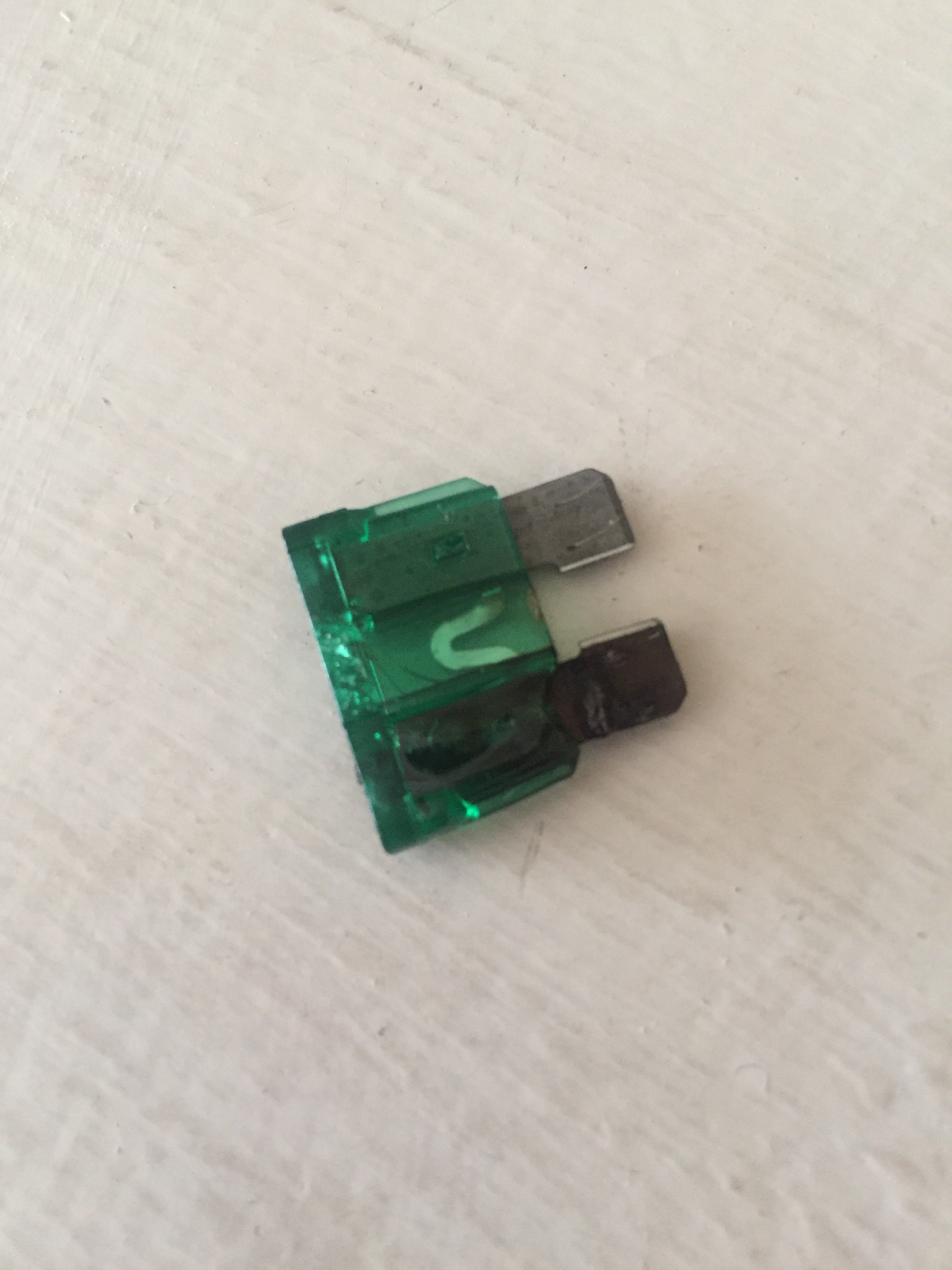

Thanks very much, you helped me out big time, I opened up the fuse box and and took out the fuse and there it was, the melted fuse. You have been a great help, much appreciated..
