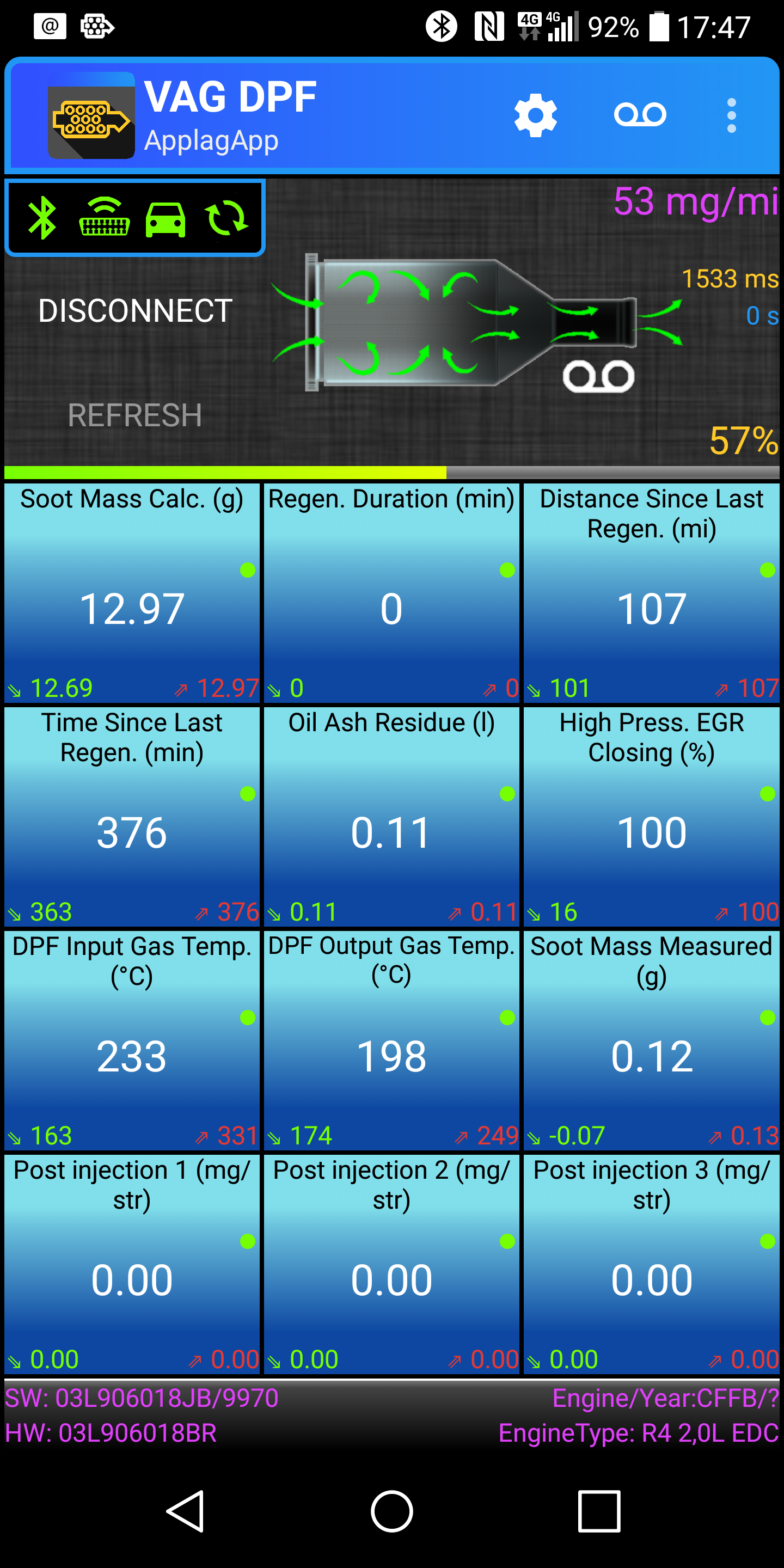

Roll back went without a hitch, now on 9970 software. Didn't have the car long enough to compare much, post injection has stopped completely unless a regen is active. I'm happy and got an oil change planned for Saturday along with gearbox oil and wipers while I'm in there. Its worth it to avoid the oil dilution alone to me!

The 9970 was confirmed by the guys on the Facebook group and is one of the later non fix files. I used to get post injection on all 3 boxes when monitoring via vag dpf. Now 0, so that's an improvement. The FB group has loads of verified people. So I'd just get it done ASAP.

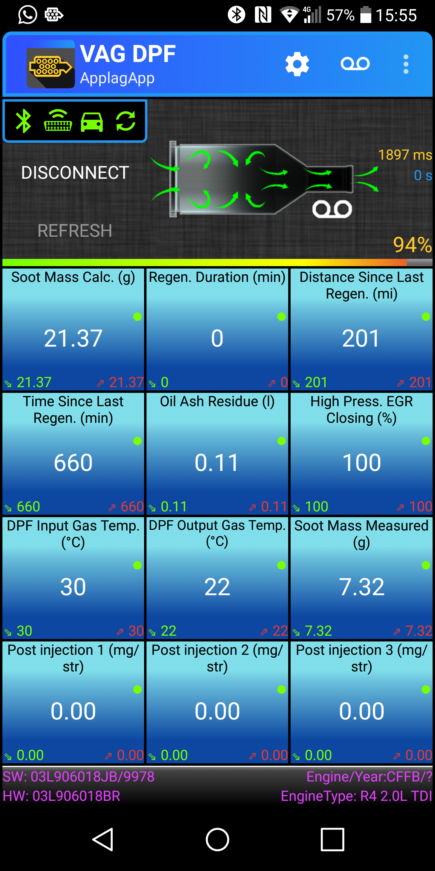

Just to clarify my 2 files that I've been running.

No, they were oblivious to the rollback issue and seemed happy a remap would remove all the symptoms. This is against all other advice I have found online. So I wanted the rollback more than anything else. In the end I went somewhere else.
