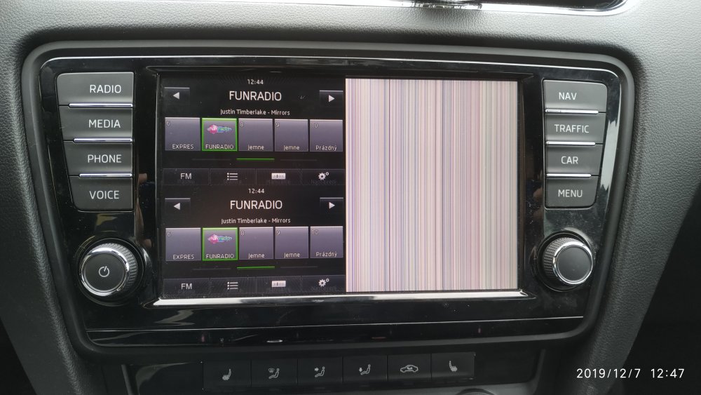

Hello i have amundsen MiB1, and i buy lcd columbus and replace it. All work good, but lcd have problem... Can anyone help?
Old amundsen:  5E0 919 605D
New columbus: 5E0 919 606
Primary Machine with CD a 2x SD:  ZR_StdNav_MOST: 5E0 035 864 A
