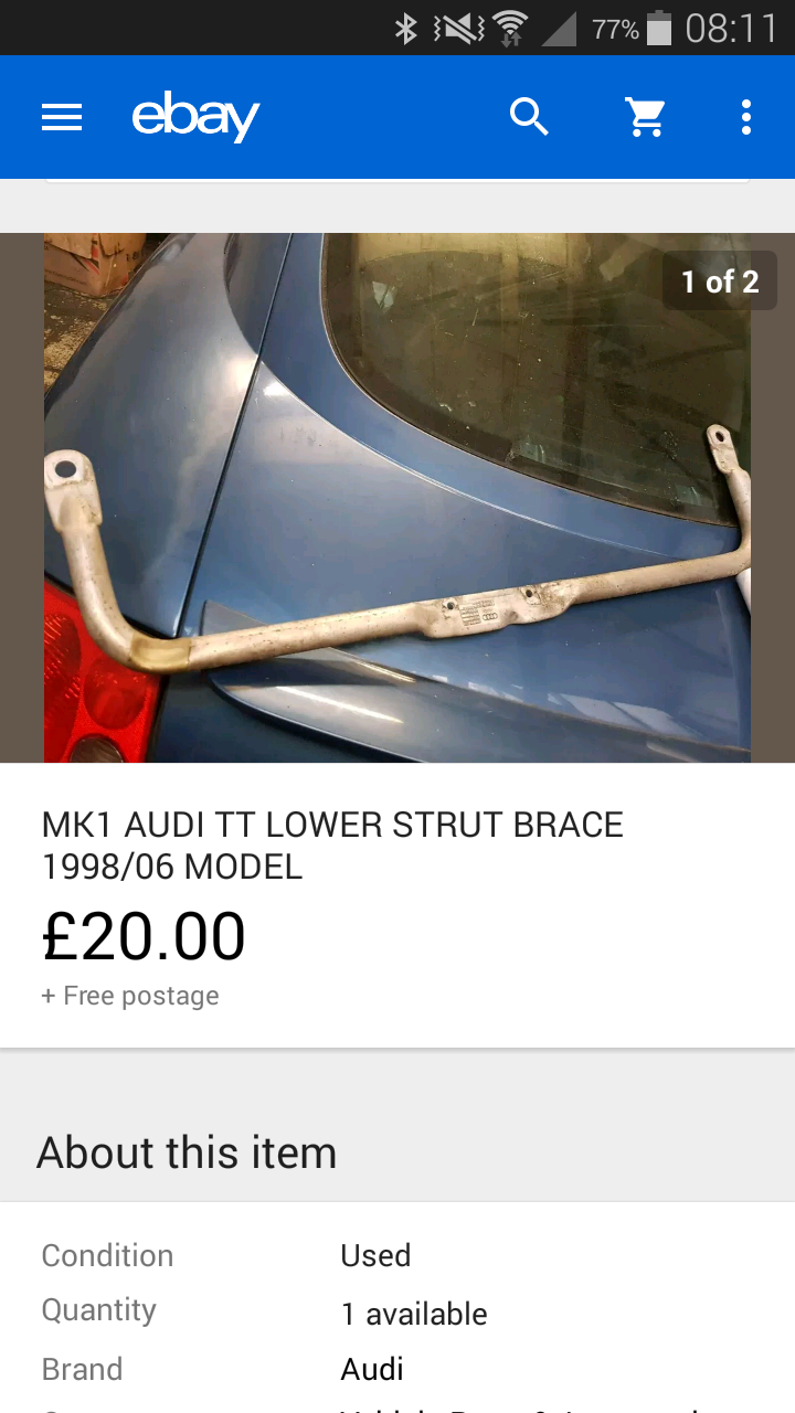

Different type of TT lower brace?
Just wondered if anyone has fitted one of this style before at all?
I purchased it a few weeks ago but my axle stands are all holding my mk1 golf up at the moment so haven't fitted it
I assume riv nuts are in order but I've searched on here and only found the flat bar type on the Leons fitted

its for the front of the car. the Octavia has a very strong slam bar and wont need that, also i dont think it will fit anyway . you can get a OMP strut brace to go between the front control arm bolts that stiffens it up a good bit

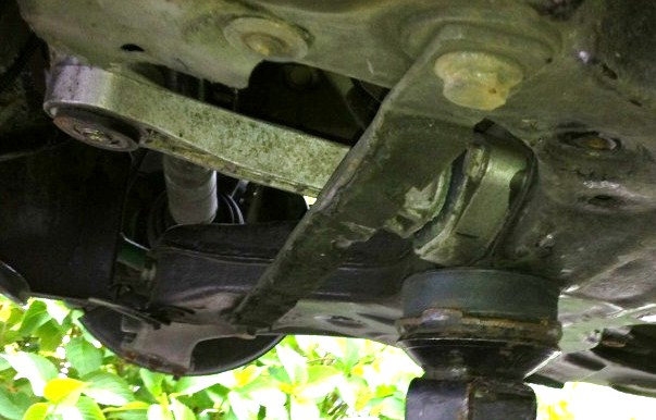

Anyway I found a picture of the Audi lower brace (thanks to Bowders), as you can see its just a bar bolted at each end with a strip of foam
on the lower side.

No I found that one already several times, I meant the one I purchased, I've not even been able to find a pic of it in its original location on a TT

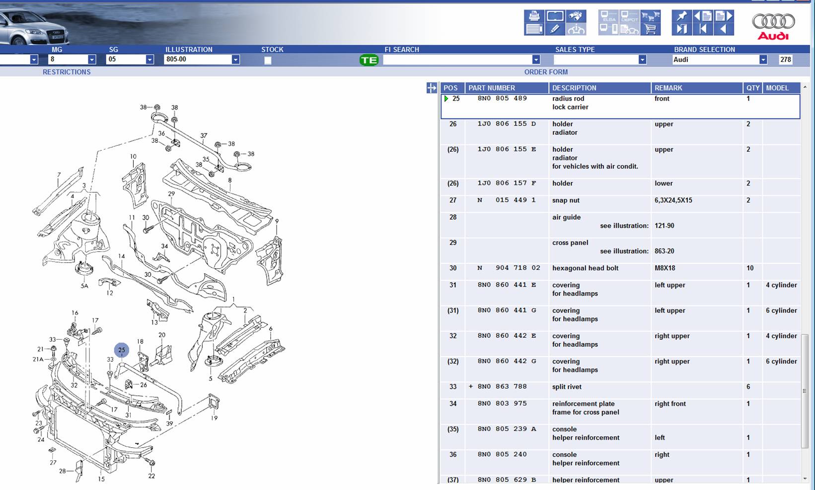

He is correct I did a search on ETKA for a 05' TT see pic below
yea i looked into this before the panel is very weak on the tt and needs this bar. omp make a nice bar to stiffen up the sub frame along with the audi tt brace on the subframe
Wow really pointless for our cars then.
Cheers guys makes sense now
