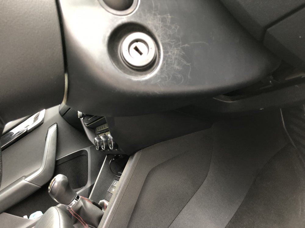

I’m stuck how to remove the cowling due to previous owner being blind and ramming the key anywhere but in the hole.

the state of that! they must have had spacial problems?

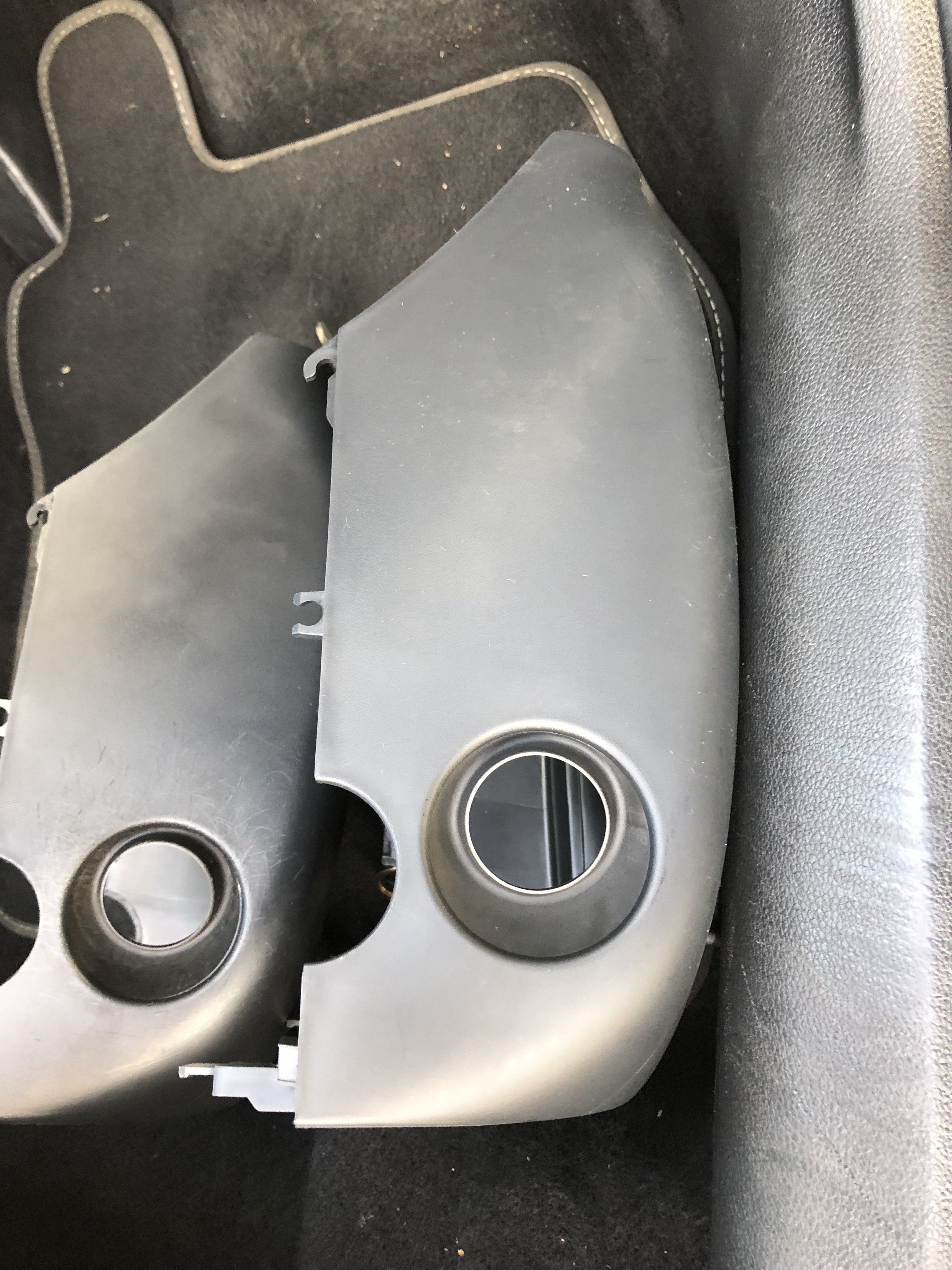

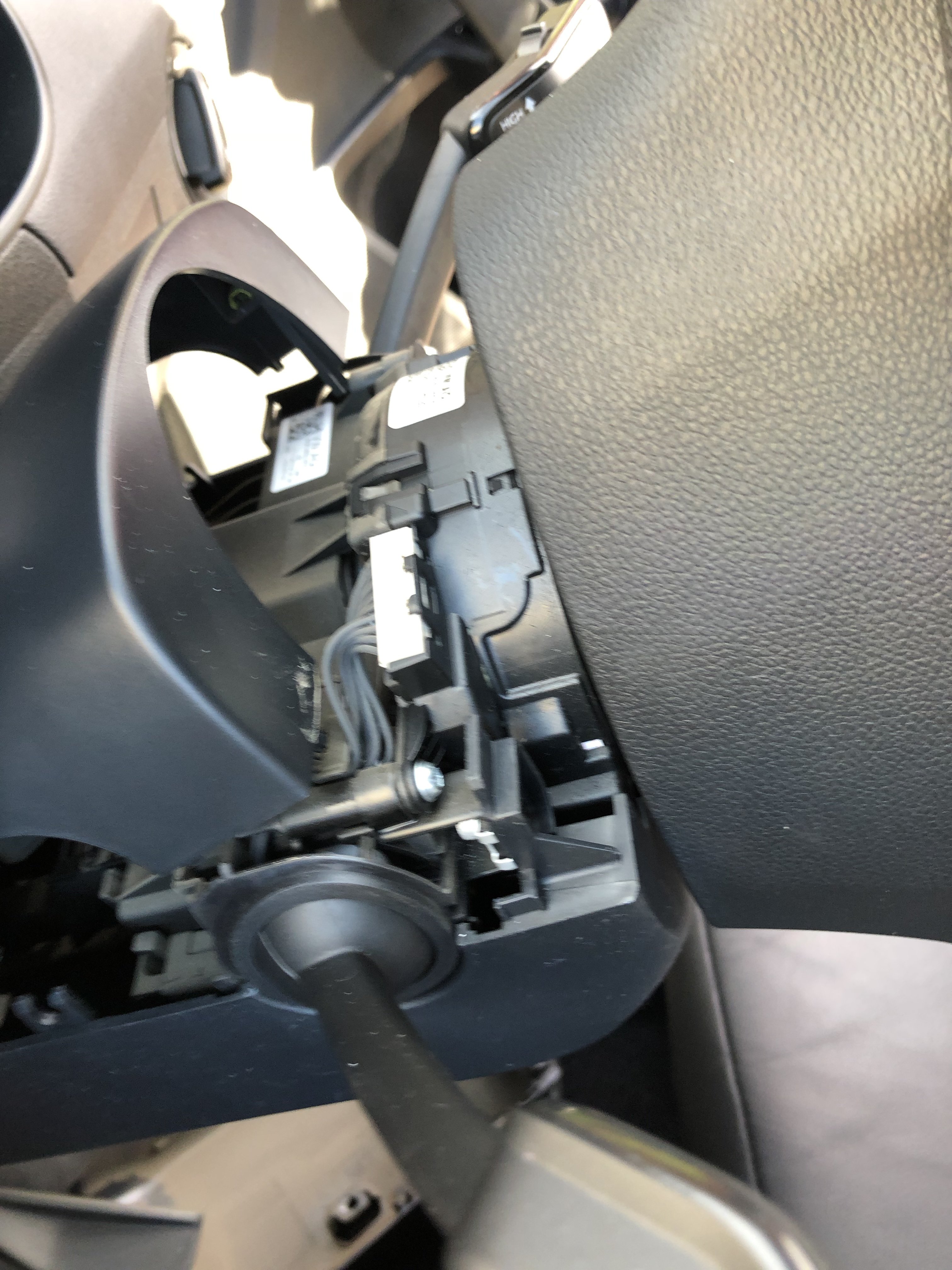

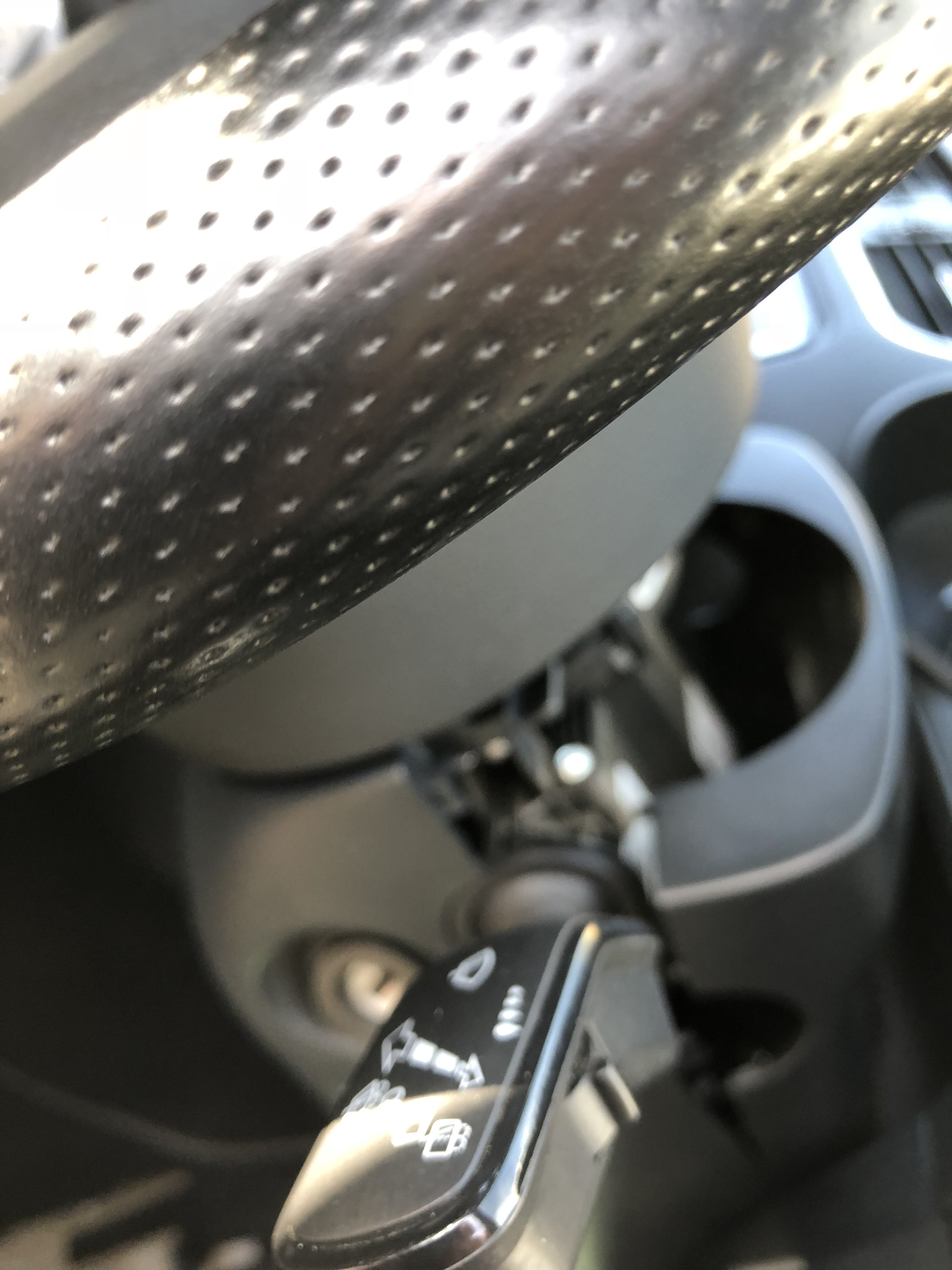

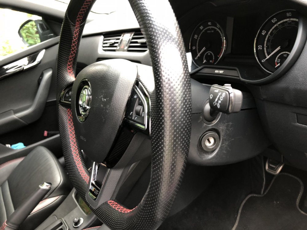

I’ve managed to change it.
Have some pictures I’ll add to help others.

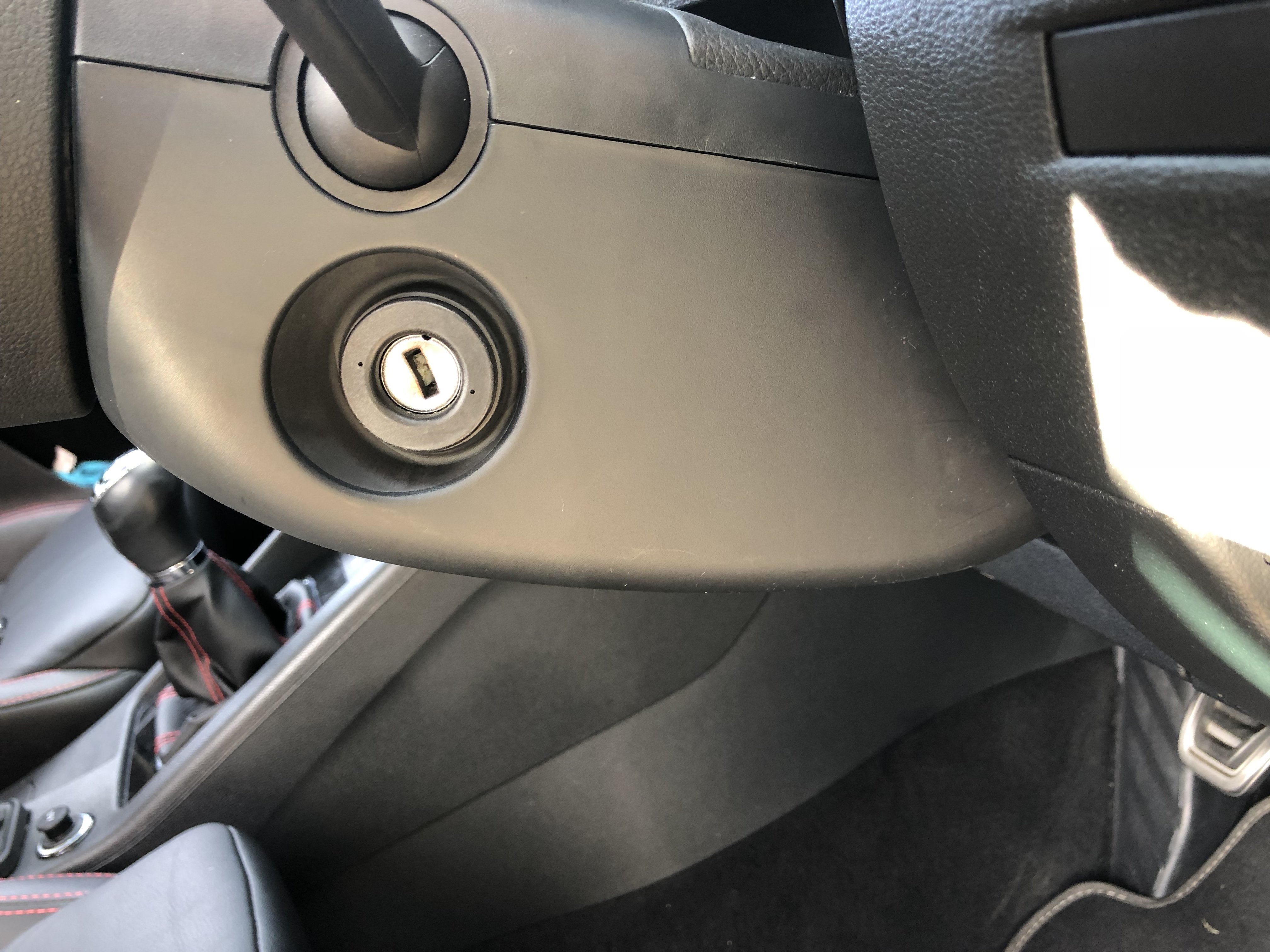

Completed and changed over.
No more scratches!
The PO of my car must have the same problems, mine’s just as bad! @Rybu79 how much was the new trim may I ask as mine need doing soon. Thanks :)
£12 and a few pence.
