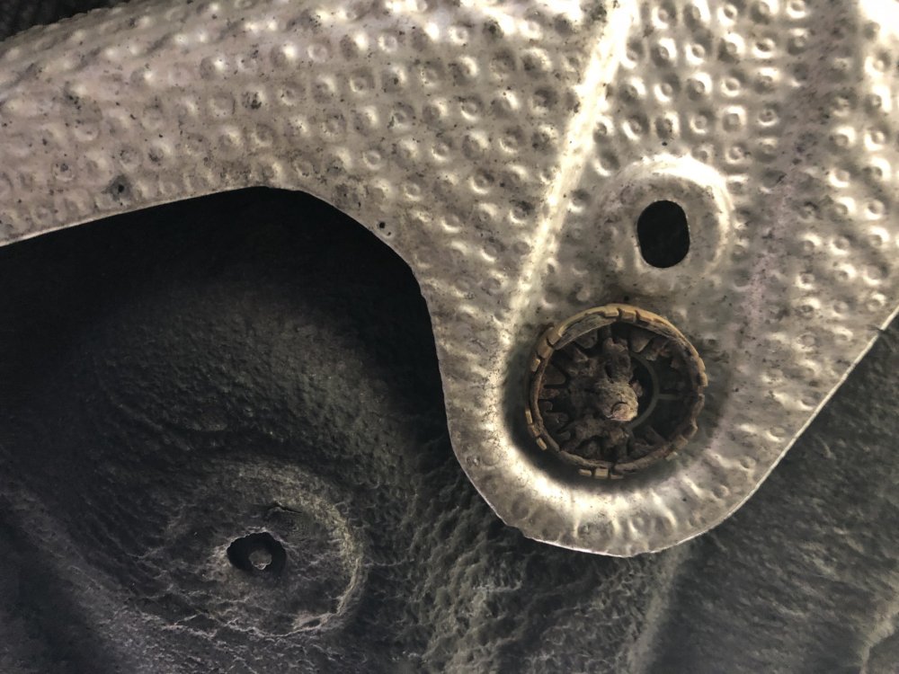

i had the wheel alignment done the other day and whilst it was up on the ramps and they were working on the wheels it became apparent that the rear heat shield above the exhaust had started to come loose as it looks like a couple of the clips/screws that hold it all in place had gone.
I’m not sure if they screw in or are pushed in to place and click into position?

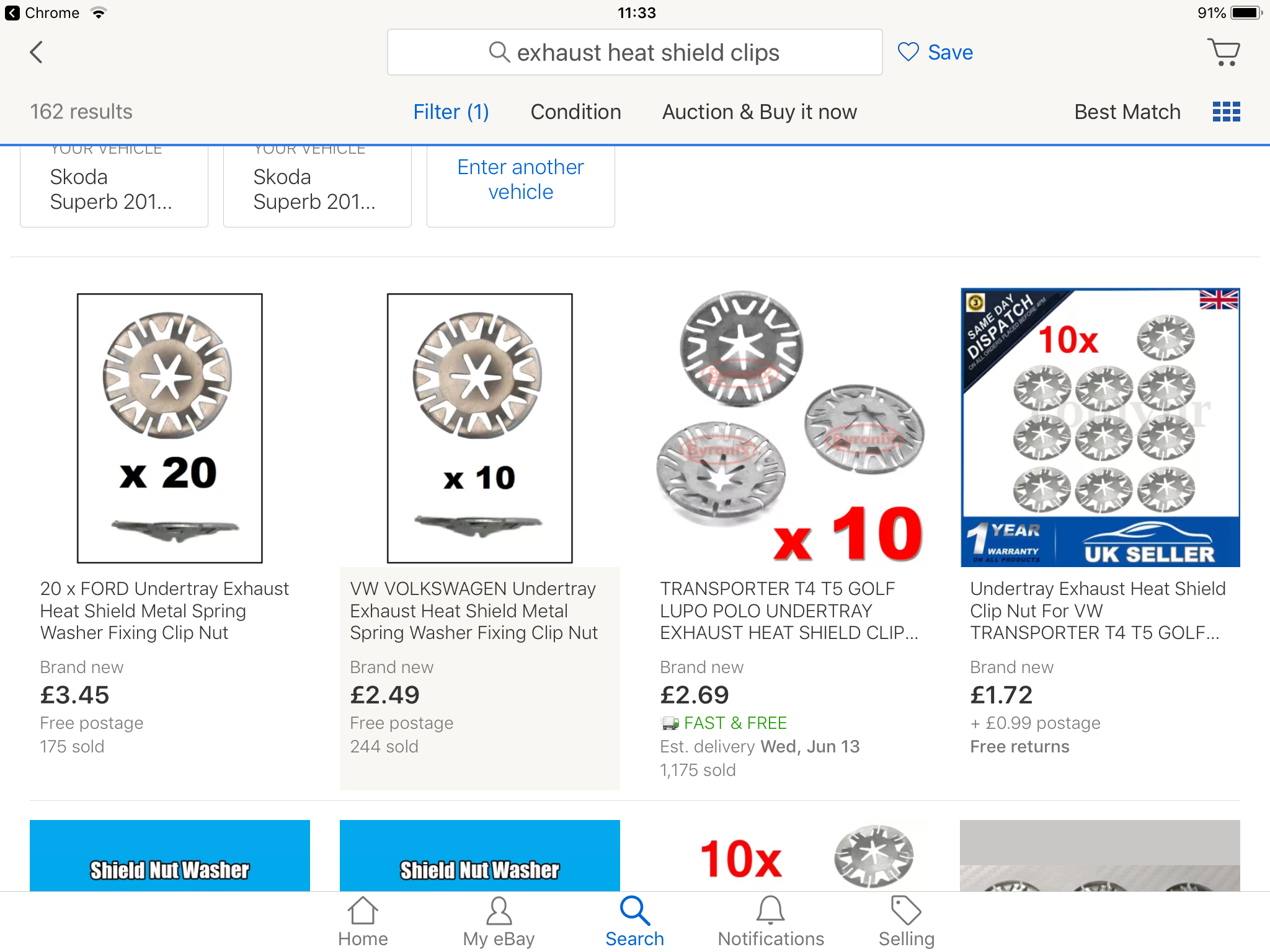

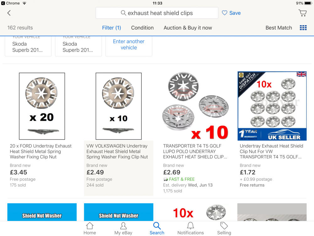

I think I might have answered my own question.........
I managed to get a photo of one that is still in place under the car and i think they are these things I’ve found on eBay???
a 10 mm long socket or similar and a small hammer --spot of rust protection helps too
