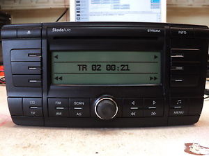

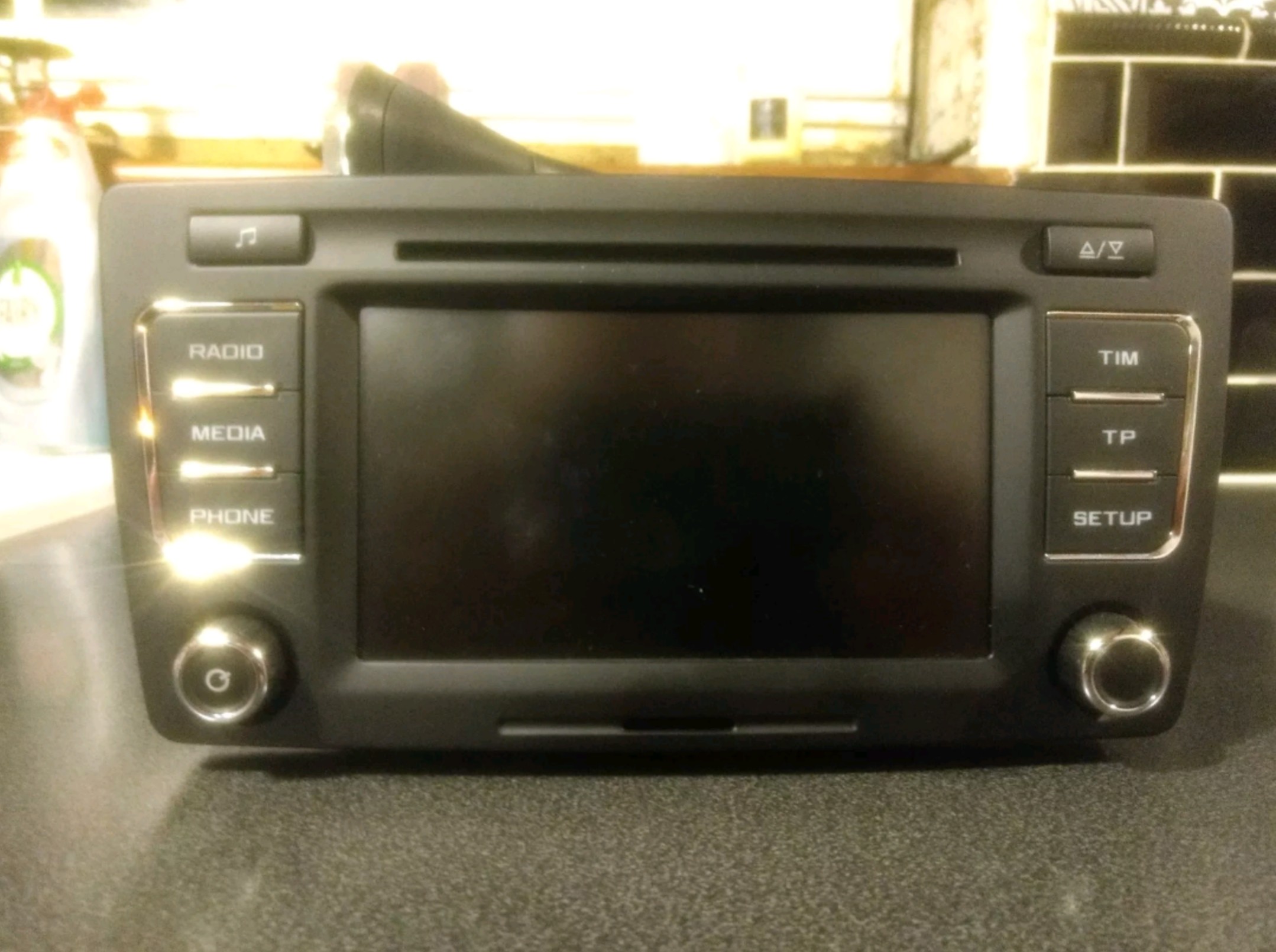

Now... A week before my first battery died I've purchased form a gentleman ho took it off from his SKODA Yeti 2013 a Bolero 1Z0035156N and had it fitted since then. My old radio was a stardard radio/CD player 1Z0 035 161B.
Now... Maybe is just a coincidence, but is it possible that the Bolero radio is the problem???

It could be the known battery drain issues on older cars when fitting newer head units. Think you are affected. Take the stereo out for a week. Hopefully someone with be along to confirm this.
Yes it is the new stereo causing the battery drain, you need to get a newer canbus gateway and you be sorted.
