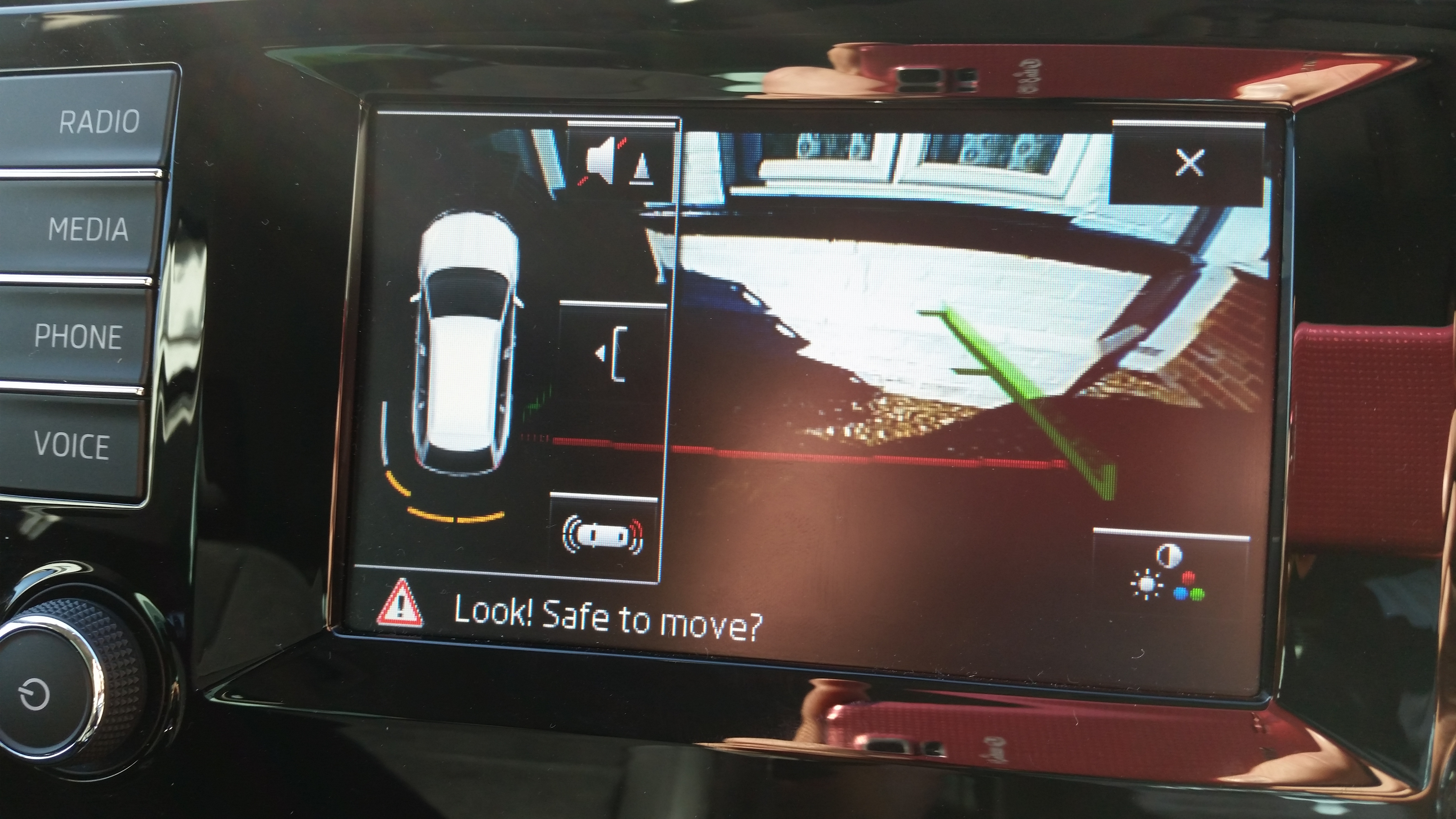

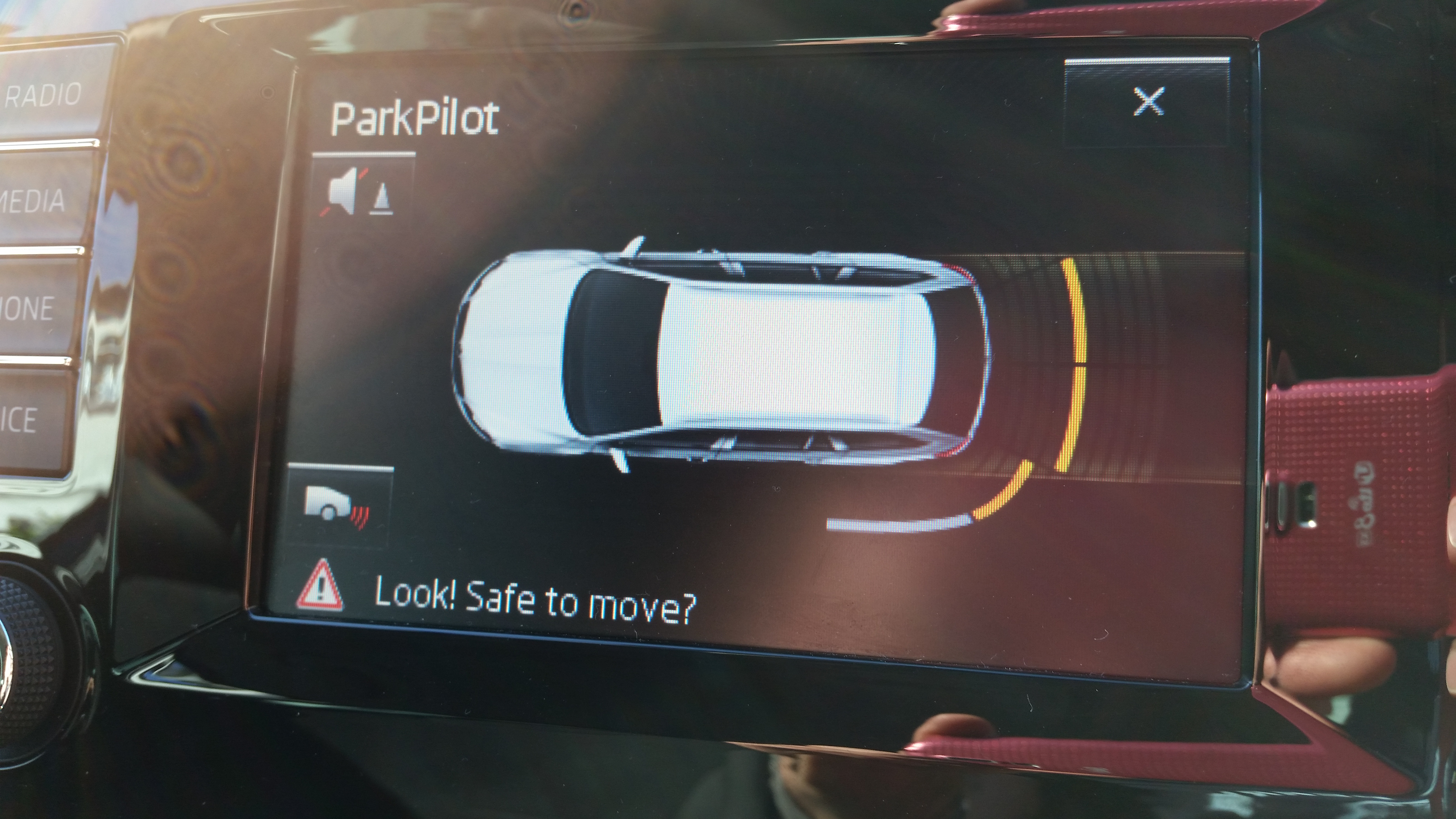

Hi all, do you know if there is a VCDS setting I can change so that when I put the car into reverse it shows the parking sensor screen as default rather than the camera display as it does now.
Weird request I know, but I dont really find the camera a help and would rather have the traditional parking sensor display when reversing.
These are the two screens:
Thanks!

You can completely disable the camera on the 5F module by unticking byte 19 bit 4.
The default screen probably can't be changed.
Thanks, nah I want my cake....so I want to reverse the default action, so when putting it into reverse it just shows the sensor screen as the default. I still want the option to press the button to choose camera though should I feel a weird need to use it ;)
Don't want to disable it ...just swap the options around.
