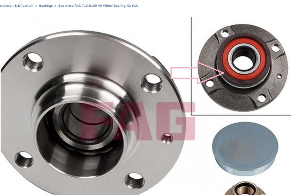

Pink arrow is pointing at the ABS magnetic ring (please ignore the fact that it's a four-bolt hub in this picture, Fabia one has same sensor ring). It is an integral part 8of the bearing/hub assembly.
I see so what happens to the ring does it just break up and come off bit weird that it chose the n/s sensor first now it's changed and gone to the o/s should i just take the leg off and buy a secondhand leg with hub and try that or just replace the hub and bearing i guess ill need a decent puller to get the bearing and hub out.
