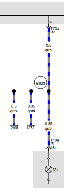

Looks like it might be a BCM/Onboard supply control unit - J519 problem. Seems to be a vulnerability with recent-ish Skodas, especially when people try non-standard bulbs.
The output shown from T73a/41 goes to left front side light (M1, shown), left rear tail lights (box with 273 inside goes there) and left numberplate light (box with 299 inside goes there).
If that output isn't working, it's consistent with what you're seeing (not seeing) on the car.
