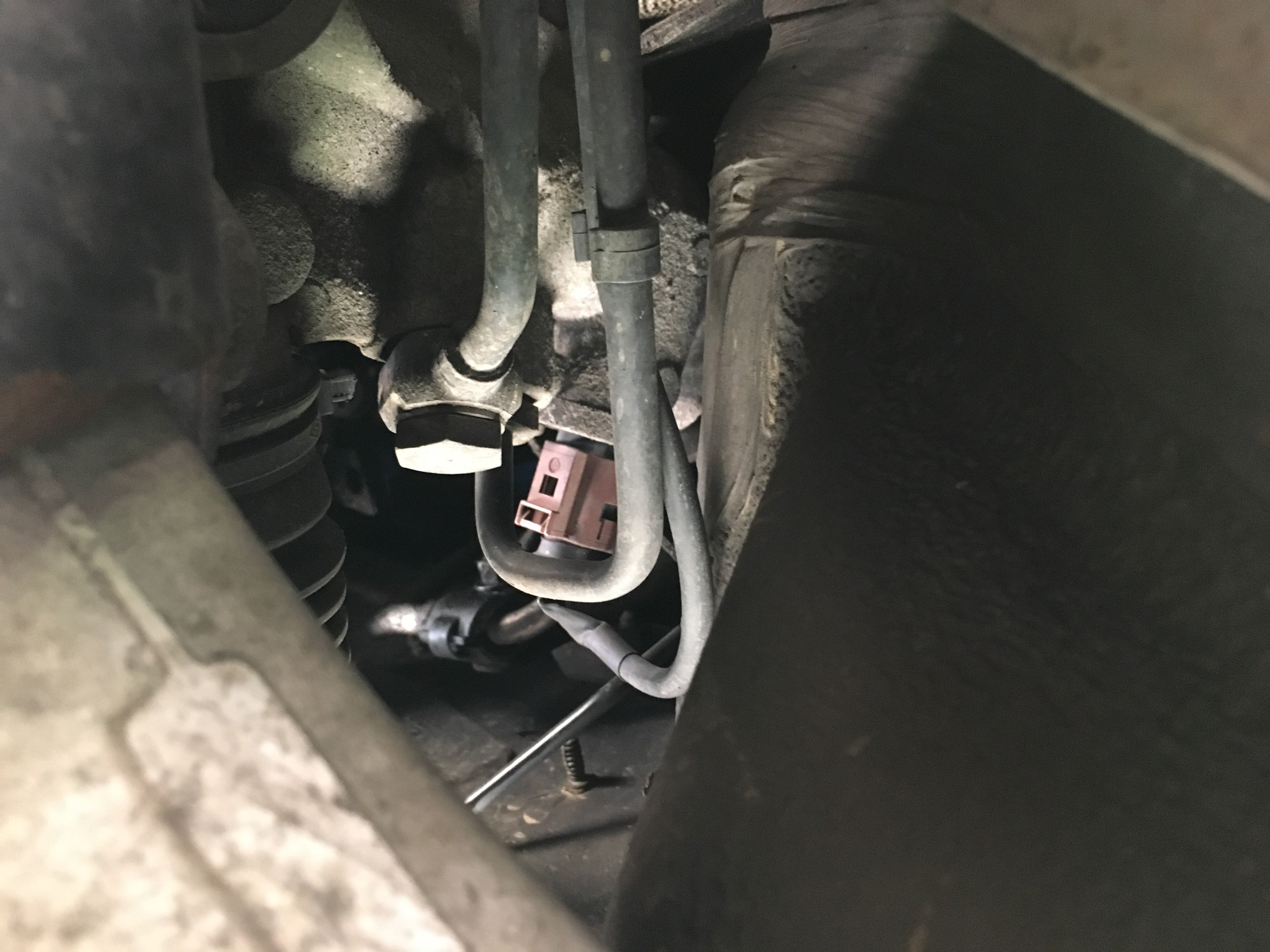

So slowly dive a whole circle on 1 lock then the other lock and it’ll recalibrate? Cars on makeshift ramps atm so is it worth checking the sensor while I’m under it?

You'll need to lookup the detailed explanation of the fault code then since it's not just a calibration issue.
See this page on the Ross-Tech Wiki 00778 Fault Code
