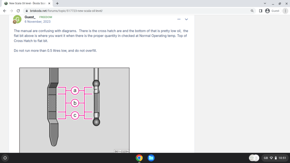

Nonesense. When cold it can be with oil filters on top of engines and the correct quantity of oil. Just go check. Too many cars leave oil services with low oil. PS. Go check Area A, dip stick. Owners manual. Cross hatch area and how to check oil and at normal opating temp VW engines.

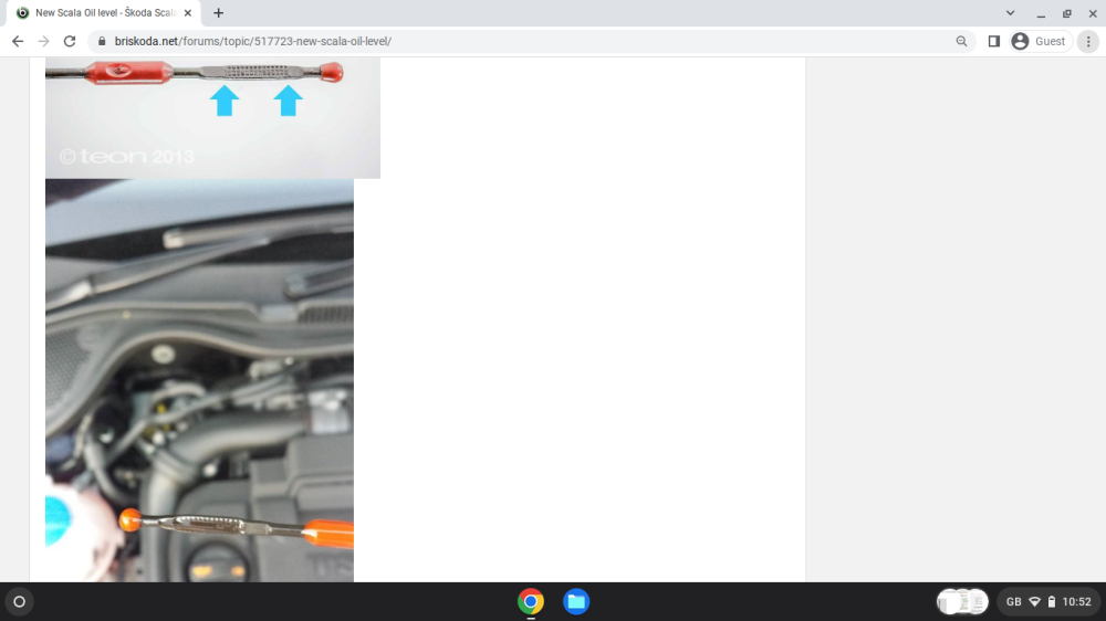

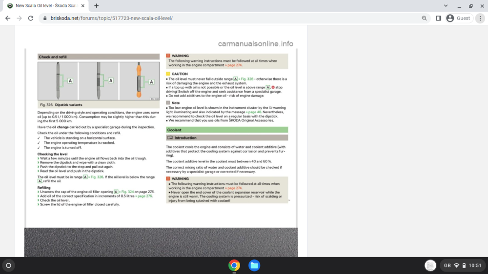

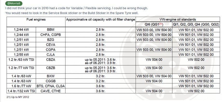

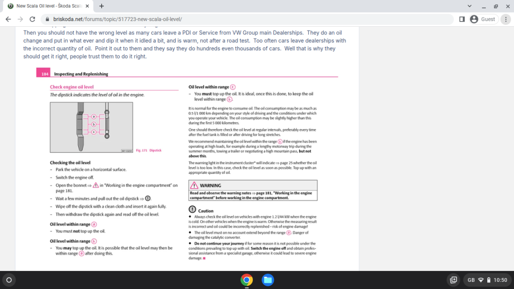

An engine running ticking over and stopped is not normal operating temp. Likely not indicating 50*oC. But likely fine. But still check when up to 90*oC and stopped on the flat that not overfilled. PS, The worst Overfilled & also underfilled posts are there in the Fabia Mk2 section regarding vRS 1.4 TSI Twinchargers where the official oil quantity is 3.6 liter and 3.9 liter is actually required. Then Mk2 Fabia 1.2 TSI,s when the changes in 2011/12 had the quantity change from 3.6 litre to 3.9. Different filters as well. Dealerships fitted the wrong filters and under filled oil for a long time, and some still do. EDIT. For mk2 Fabia vRS oil checks there is the Zoomba check. Cold engine. Dip it. Then Start engine. A few seconds. Stop it. Dip it. If it is the Silver OEM fiter there is 0.5 litre oil in it. After a drive if you check you have the same dip stick level as from the engind start and oil circulating.
