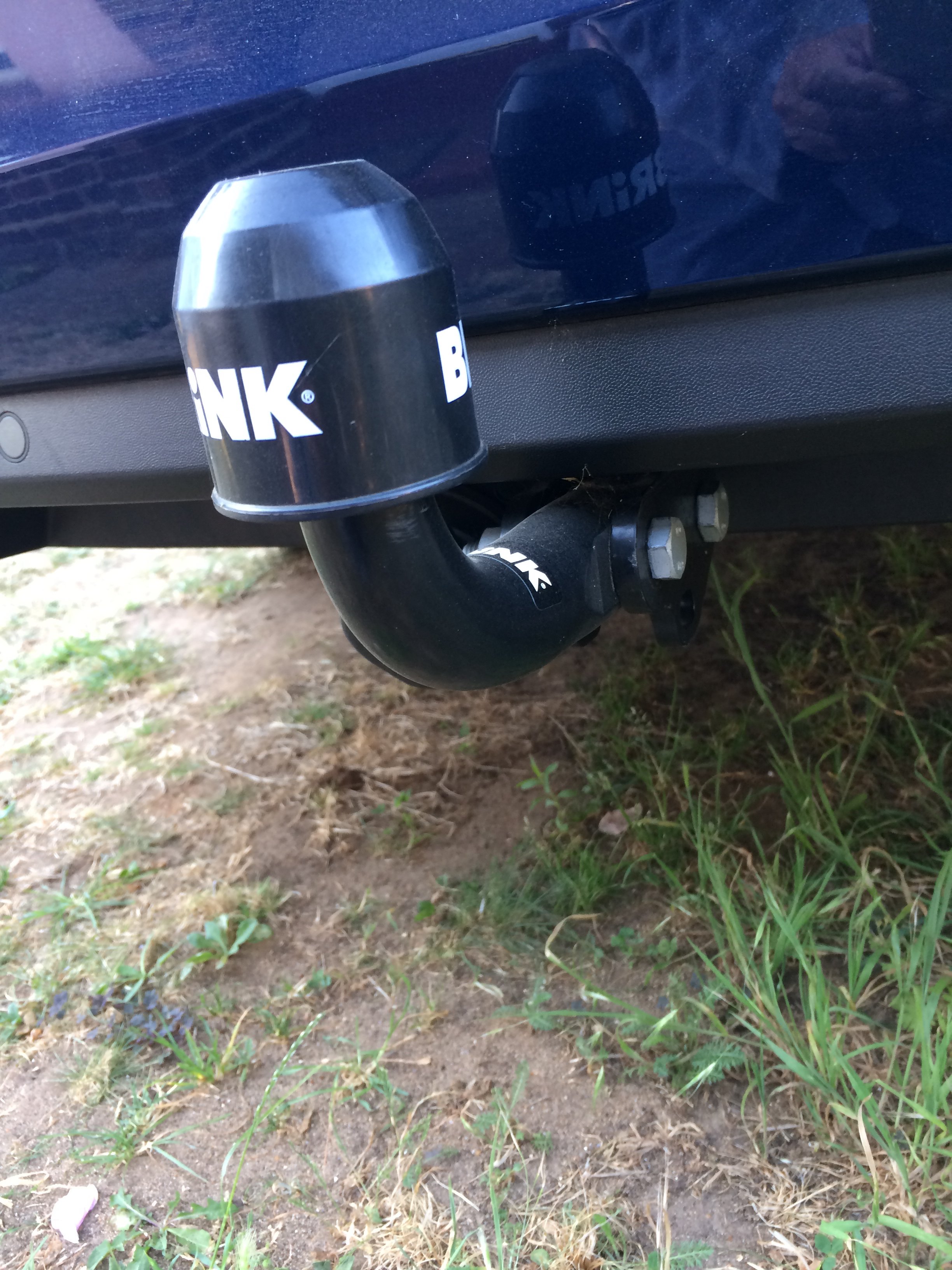

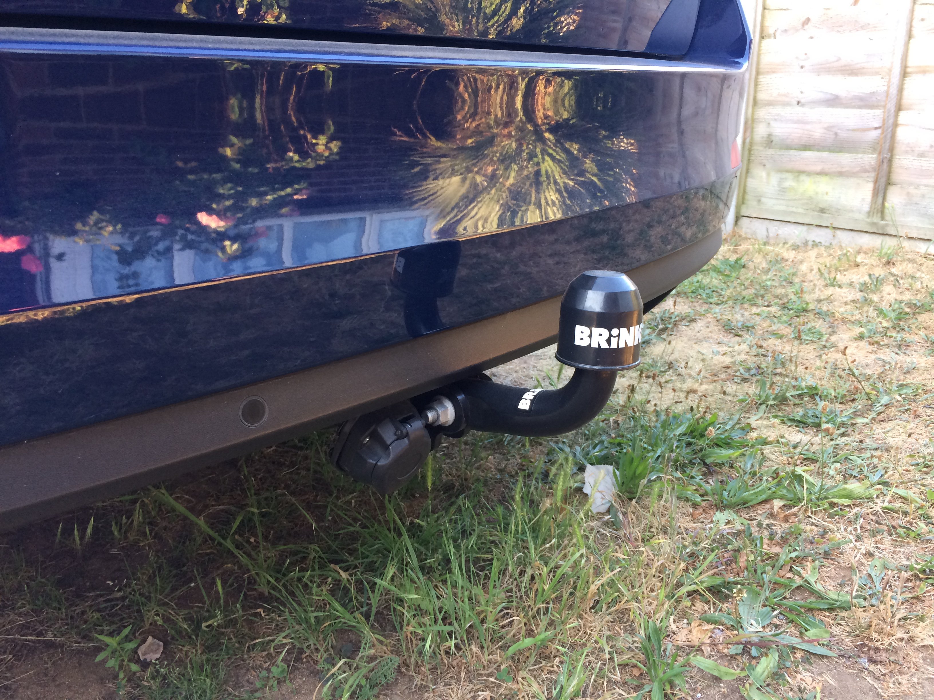

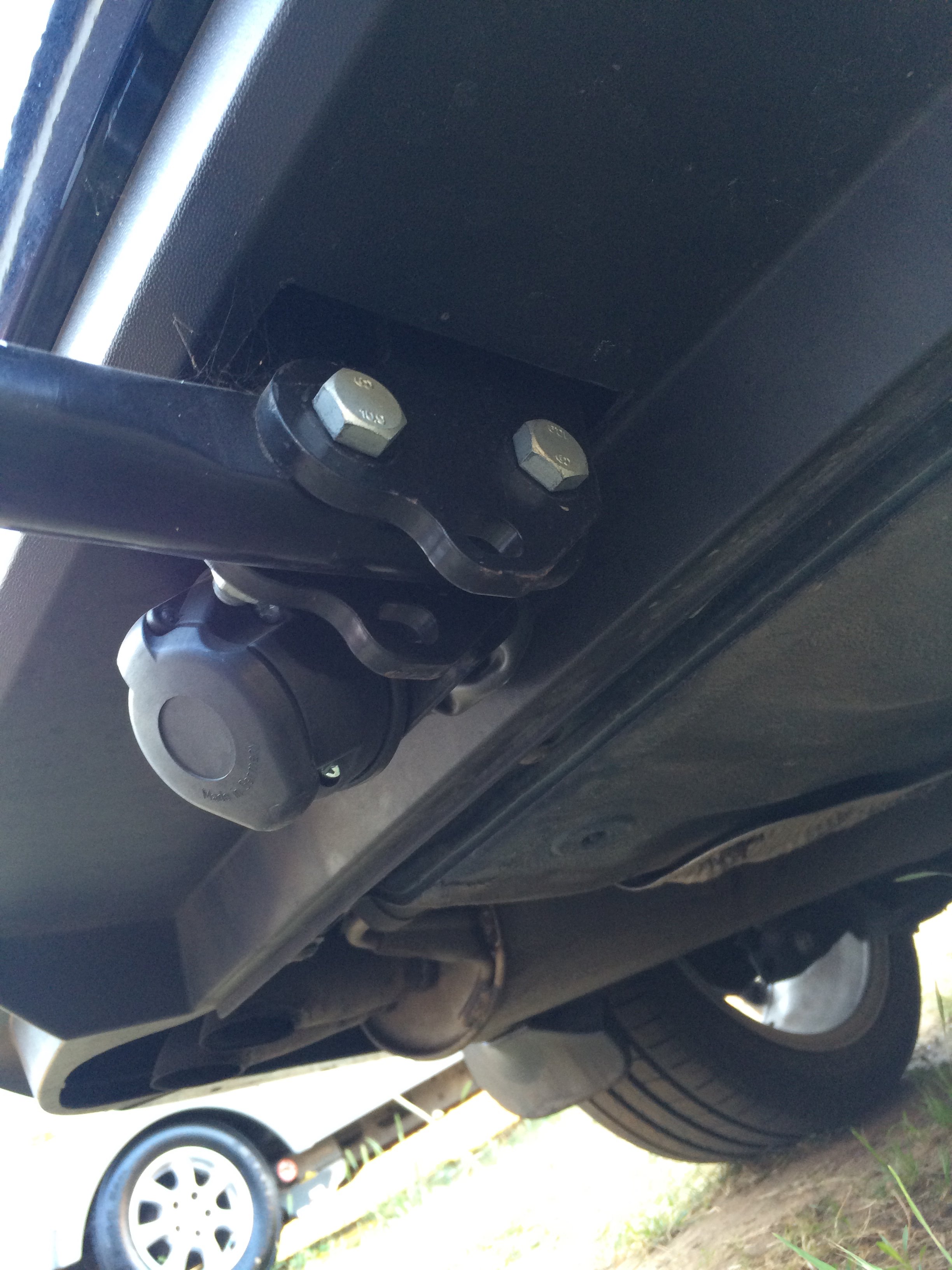

Just had a towbar fitted by Indespension  to my 2014 Mk3 Octavia Estate ..  the bumper is cut on the underside, the rear cross section of the chassis  is replaced with the tow bar ..
I waited while it was fitted, it  took about three and a half hours , lot of the time was spent doing the electrics for the lights and running the power from the fuse box in the glove box for the fridge and battery charging circuits.
Cost was £295 with 13 pin socket  for caravan electrics .
Very neat job and pleased with price..

It will need a cutout and if it has fully hidden metalwork there is a cover that will clip into the cutout if it is done to size. (although you cant see the hole anyway) If you look underneath you should be able to see the two separate bumper covers. The standard bit of the bumper should be underneath with the cutout marked in the plastic
