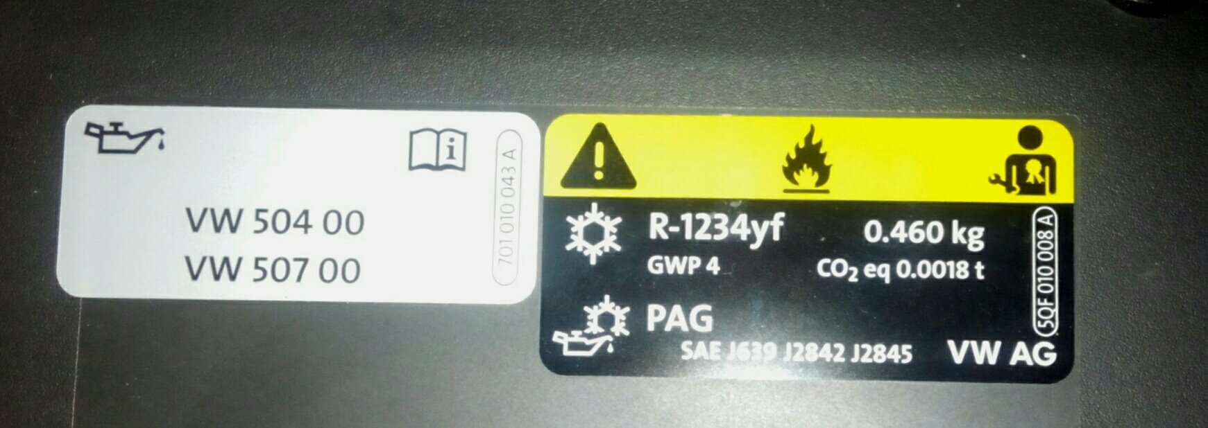

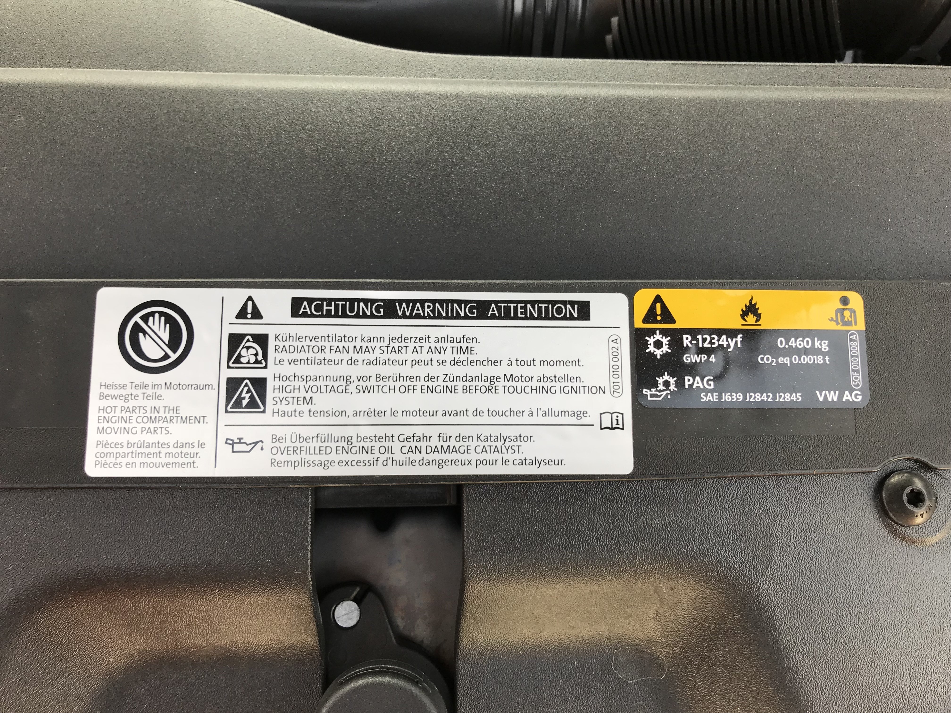

I have a 2018 built 1.4tsi 150ps engined Superb. There is a factory sticker next to the bonnet release that specifies oil as VW 504.00 VW 507.00
I suspect the engine is factory filled with 508 (likely Fuchs) as it is a very clear non coloured oil unlike Castrol Edge which is golden in colour. As offski states this oil exists so that VAG can squeeze their NEDC/CO2/WLTP figures down so reducing the chance of EU emission rule penalties.
But it is clear from the factory sticker that VAG think 504/507 is the correct service oil and given the massive price difference, dealers will continue to use 504/507 anyway.

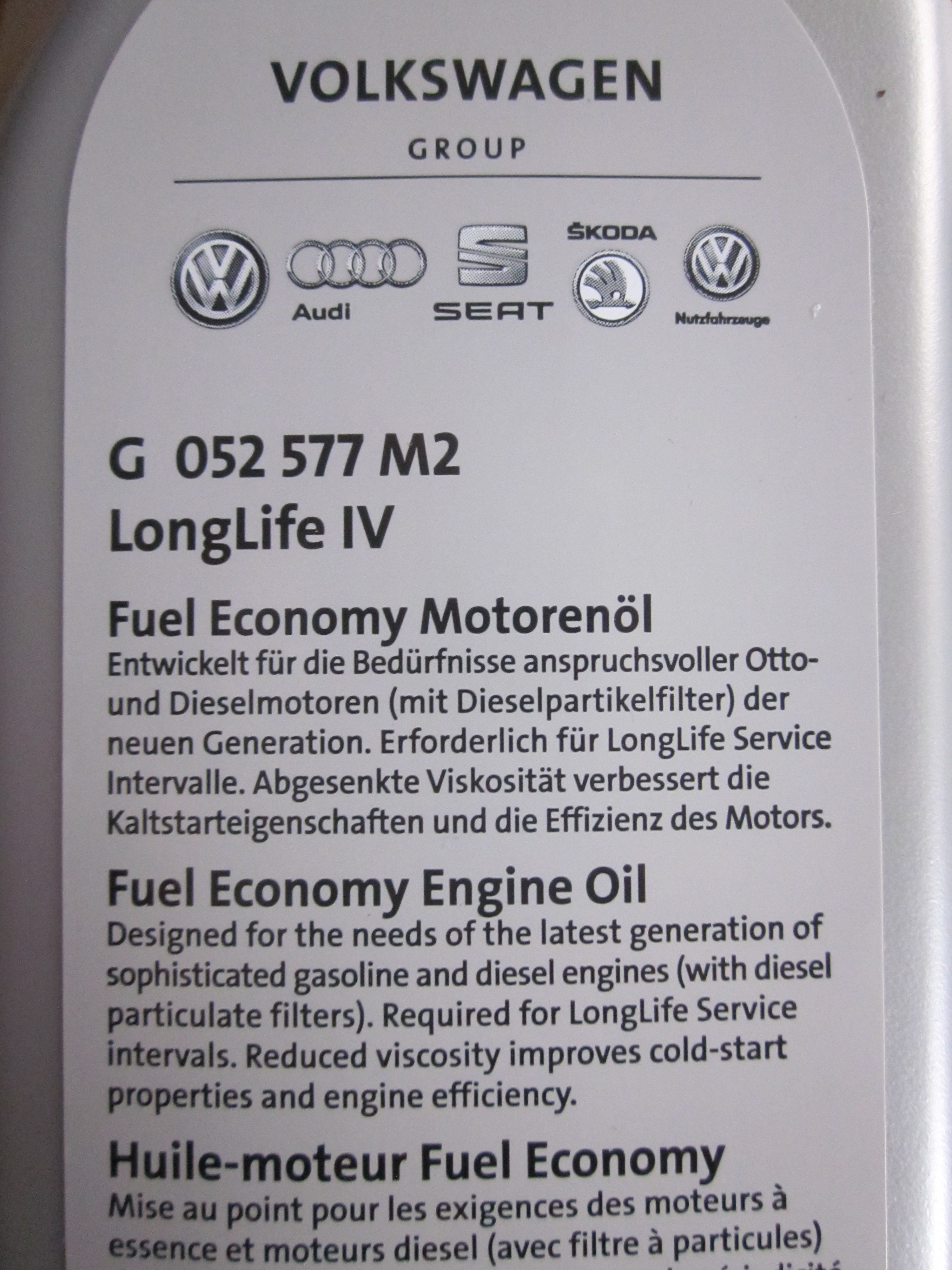

More information about VW oil specifications
Take note of the warning anout 508/509 oil. So look carefully for the engine bay oil specification sticker located next to the a/c refrigerant spec sticker next to the bonnet realease catch!
VW 508.00/509.00
    This specification combo (508.00 for petrol, 509.00 for diesel) requires a 0W20 viscosity, fuel economy oil with long life additives. These specifications are NOT backward compatible with the eariler VW specifications
The same warning is repeated across all oil manufacturers.

Basically you can use 504/507 without problem but you can only use 508/509 if the engine is designed to use it. The factory sticker in my 1.4tsi engine compartment suggests that 508/509 should NOT be used on this engine, so I've just checked the latest Skoda download user manual and its states......
To find out which type of engine oil you can use for your vehicle, contact a
specialist garage. If this oil is not available, other oils can also be refilled. To prevent engine damage, a maximum of 0.5 l of engine oil with the following specifications may be used until the next oil change:
▶ Petrol engines: VW 504 00, VW 502 00, VW 508 00, ACEA A3/ACEA B4 or
API SN, (API SM);
▶ Diesel engines: VW 507 00, ACEA C3 or API CJ-4. Engine oil VW 505 01 can optionally be used in diesel engines without a DPF.
Castrol oil selector also says 504/507 only, not 508/509 also (1.0tsi engines can have 508/509)
It seems 504/507 is the correct oil for 1.4tsi as fitted to latest production models.
1.4tsi engine sticker (2018 superb)
Edited by xman

Is the sticker anywhere else? Mine is different. The production date is the 3rd May 2018. I can see a lot of Audi and VW logo’s everywhere lol
Edited by atki81
Hmmm. Superb and Kodiaq are made in the same factory. My Superb was built end of Jan 2018.
Confusing.

No oil spec sticker on the slam panel of my 2018 1.4 TSI 150PS Kodiaq either.

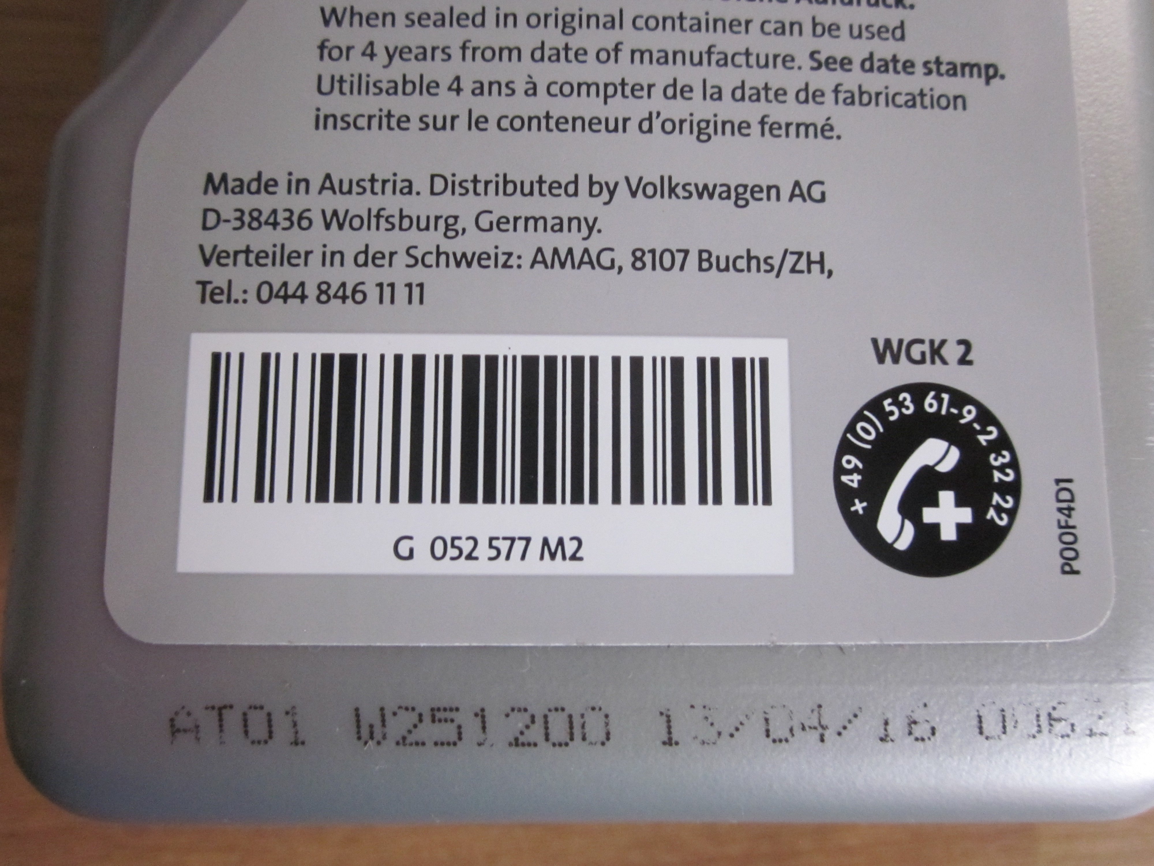

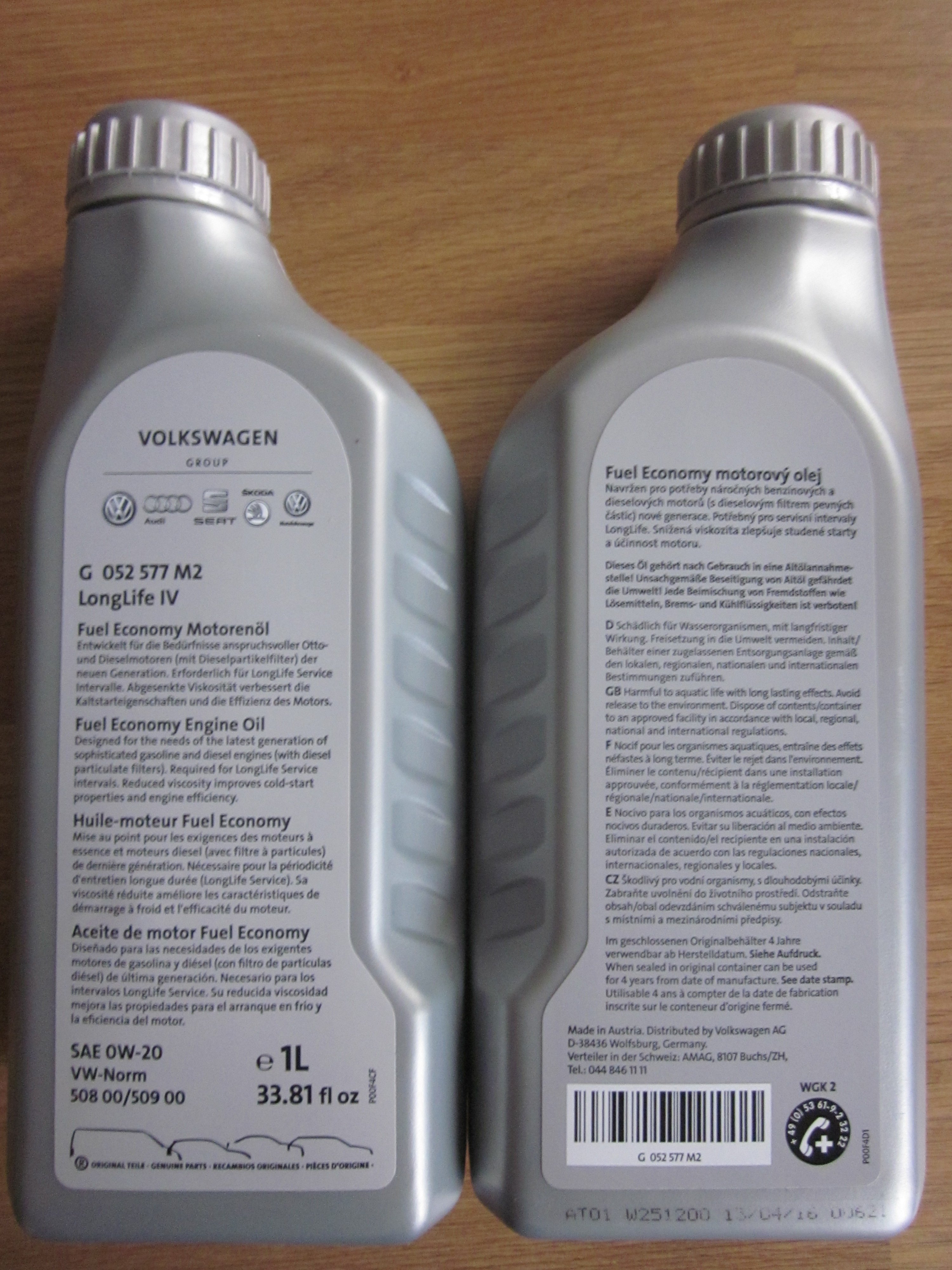

Top-up oil arrived...
Some people are greedy buying 2!! No wonder the prices are getting pushed up lol
So... when it is sealed in the original container, you can use it for 4 years from the date of manufacturer. The one bottle (maybe both) are already over half-way into that time period. And as you have a brand new car, it is very unlikely that you will need to top up the oil within the first couple of years (or ever!) unless you are going to be doing some seriously high mileage.
I'm afraid it looks like you've wasted a bit of money there, IMHO.
Not true.

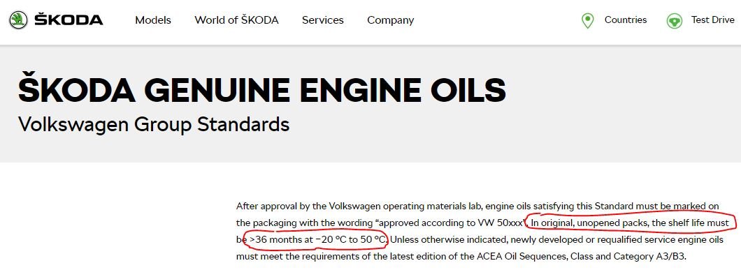

It's actually three years according to Volkswagen.
http://www.skoda-auto.com/other/oils-standards
However, opinion varies wildly depending on where you look, and as with cambelt intervals, which market you're in. This is why a production date, and not an expiry date is printed on the bottle.
As long as the oil remains sealed, is stored in optimum conditions and is shaken well before use, it is perfectly reasonable to expect the oil to remain stable for extended periods.
Some oil manufacturers (Valvoline being one) promote this as a feature of their products.
You're also assuming that the oil is all destined for the Kodiaq, it isn't.

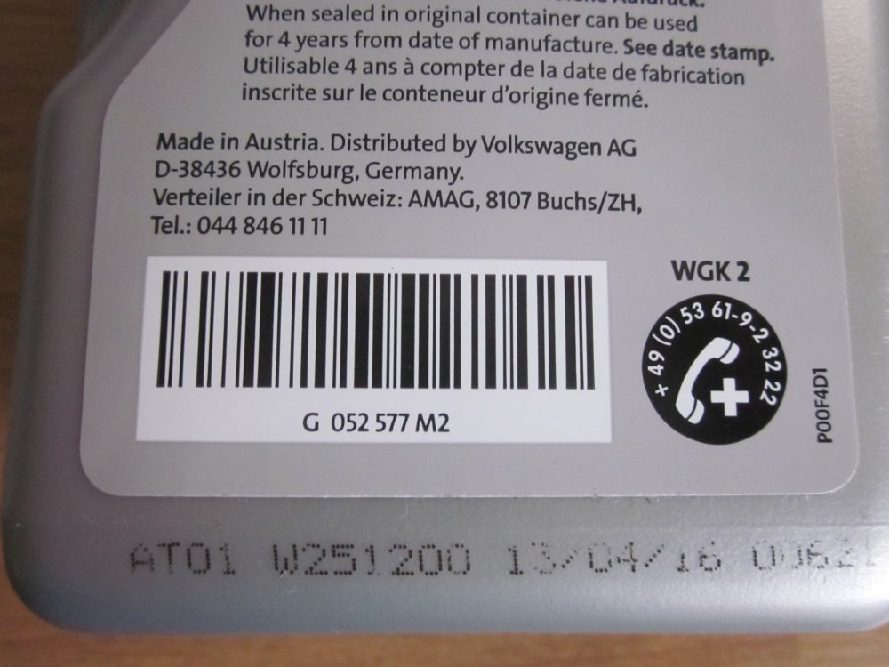

1 minute ago, silver1011 said:
Not true.
I'm only going off what's written on the bottle in the picture you posted! :D

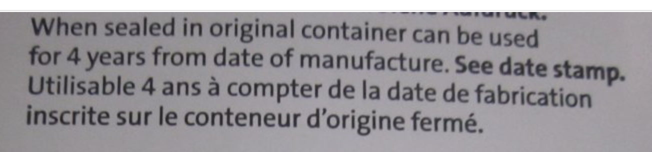

...you can use it for 4 years from the date of manufacturer.
This isn't written on the bottle.
Look at the third picture you posted...!
1462153310_ScreenShot2018-07-24at09_54_14.thumb.png.339e4e4b7aed96ccc3fea3d3e7765258.png
Edited by WiggosSideburns
Good spot, seems VAG's tradition of contradicting information continues...
Unless this is the minimum requirement for oils wishing to pass Volkswagen group standards...
Edited by silver1011
You do know what "must be > 36 months" means, yes? Last I looked, 4 years > 36 months. So no contradiction there.
Only your oil has less than 2 years of shelf life left.
