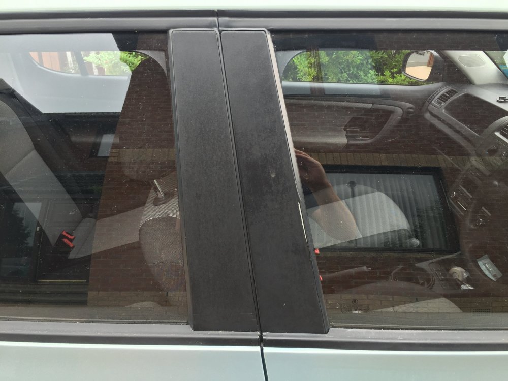

The B pillar foil stickers on my Fabia became damaged and started cracking/peeling (photo 1 below), so I phoned the local Skoda garage who got me replacement stickers for £5 each - quite reasonable. What was not reasonable, however, was the quote they gave me for labour, which was £70 per strip! So, I decided to do it myself - that was, until I discovered how tricky it was to get the window trim off in one piece (at least, it seemed quite easy to break to me).

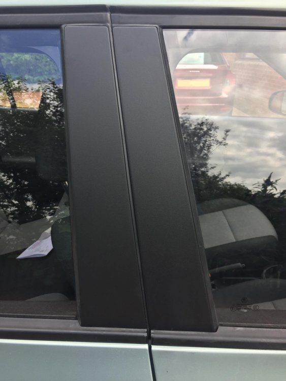

The car is just back and the before and after pics are attached. In total it cost me about £70 for parts and labour.

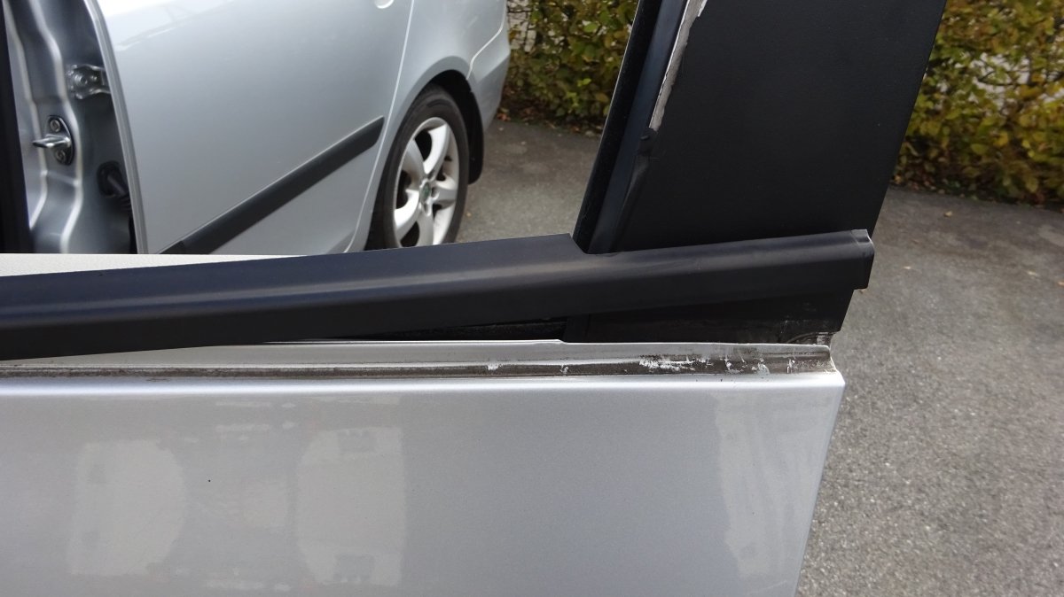

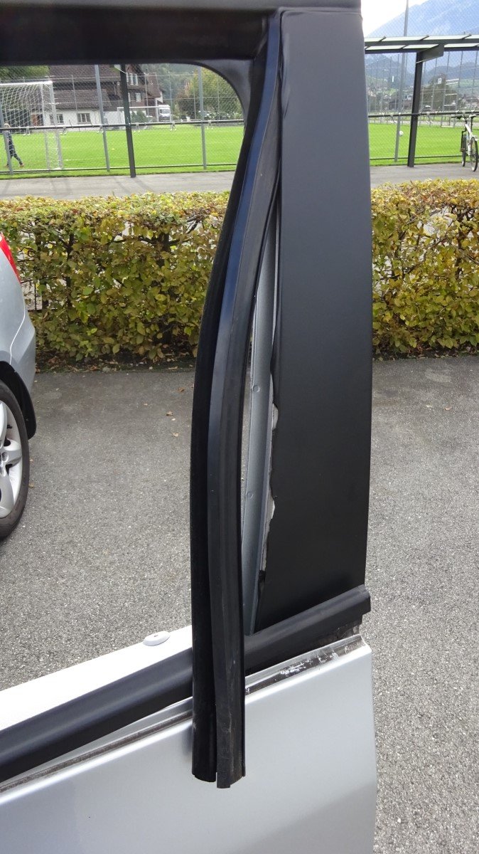

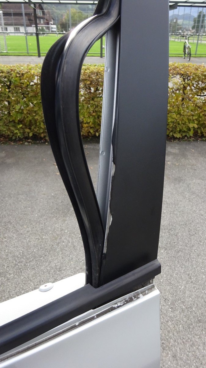

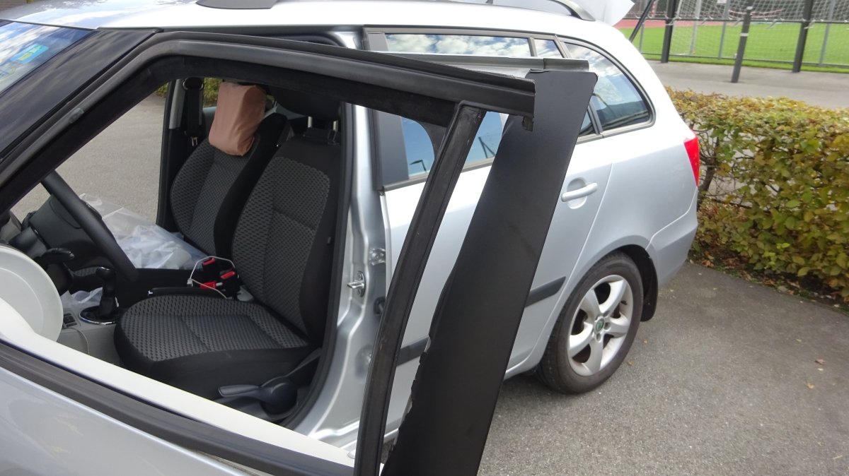

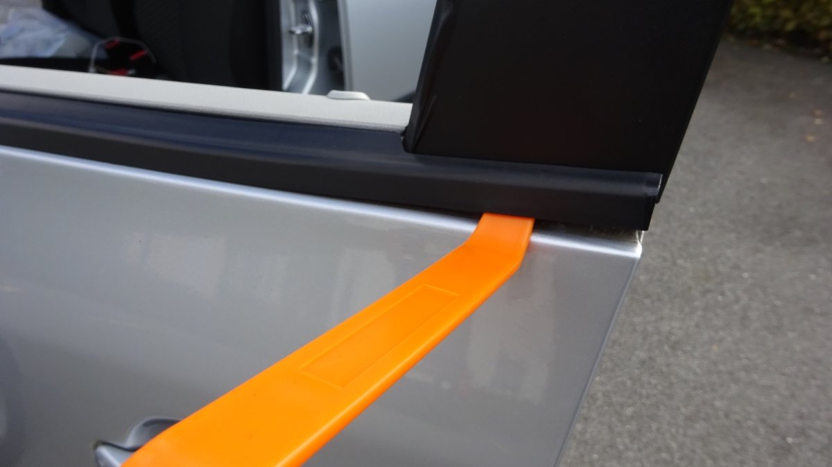

Well, it only took one year to plan and get organised.... 😀 but finally I got around to doing the job a few days ago, and here's the highlights with some photos:-
1. Fully retract window glass

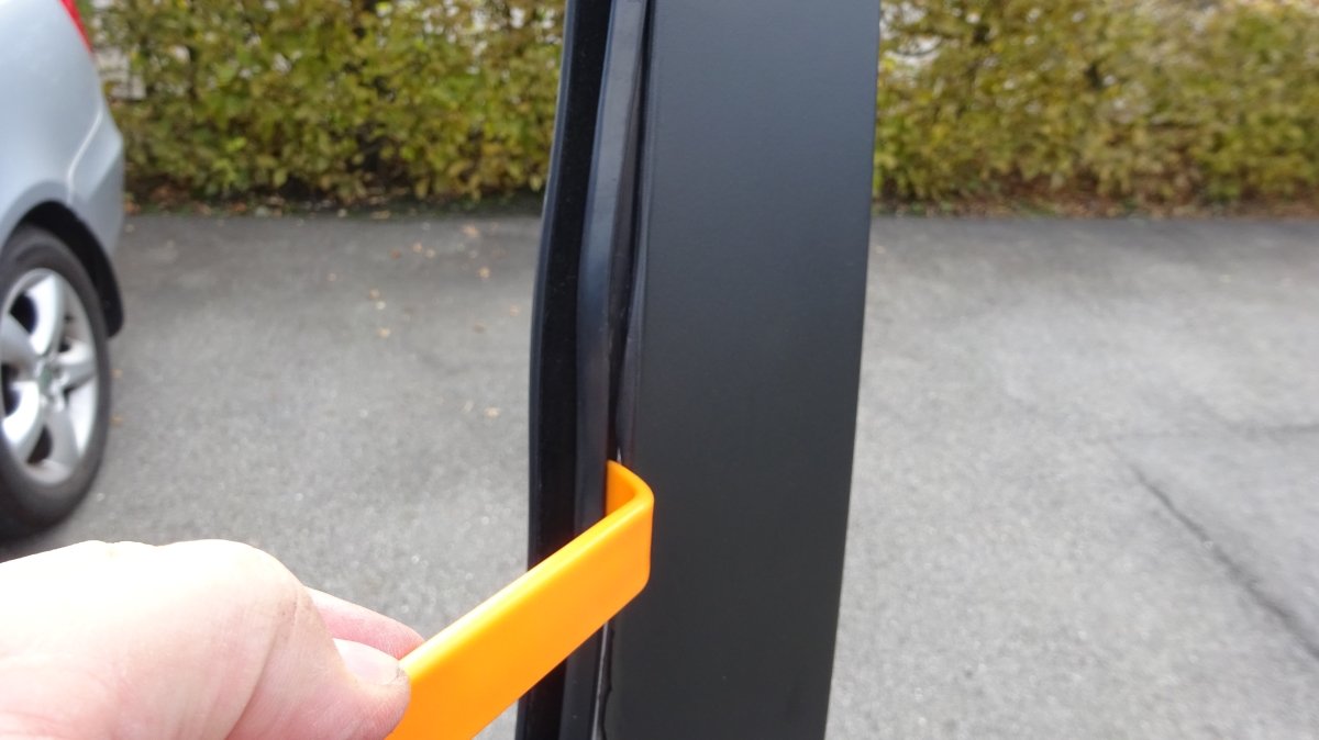

2. Use a trim tool to lift the outside weather strip until clear of the frame up to about halfway along the door (this just makes removal and, more importantly, replacement of the rubber window pillar glass seal/guide [next step] easier)

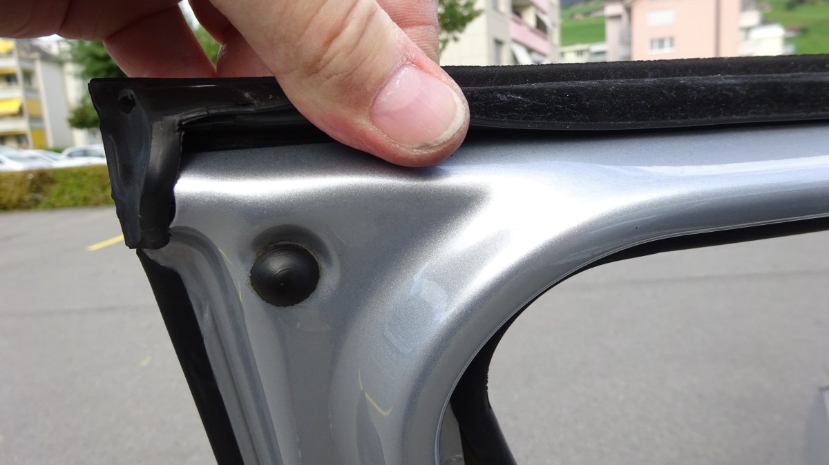

3. Prise out the pillar seal, and lift out the lower section from the door frame (nearest to the exterior door handle)

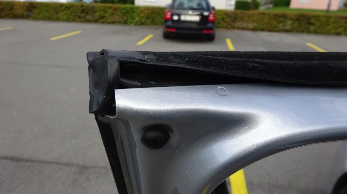

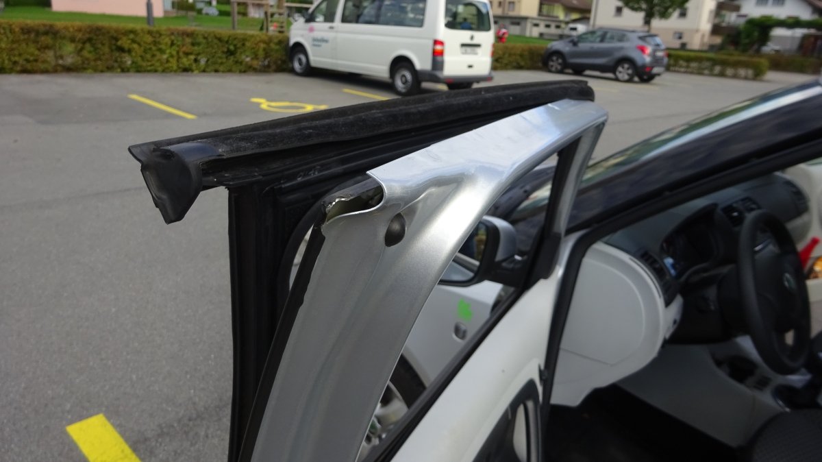

4. Photo 30: Carefully 'roll' the upper corner of the seal towards the outside of the door frame to release the seal, then gently withdraw about 8 - 10" of the seal to keep it out of the way when working on the foil. Don't release too much seal, particularly nearer to the bend in the window frame, as there is a small clip on the seal which retains the seal to the frame at this bend, and can easily be broken.

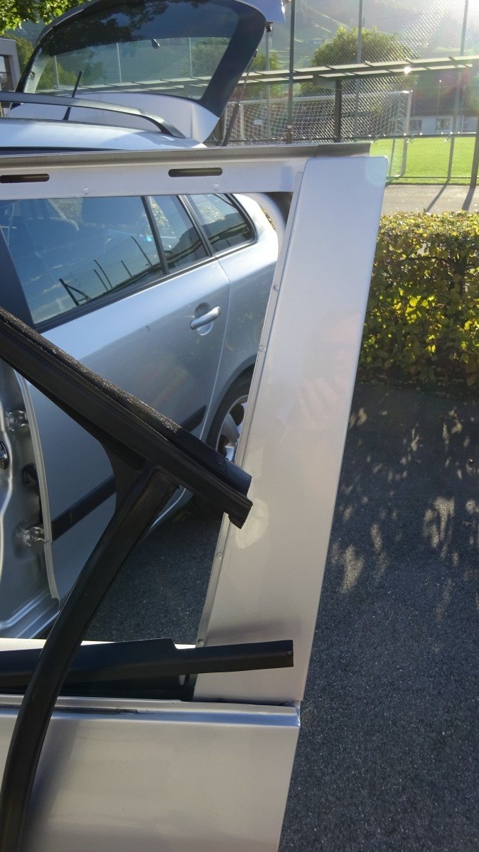

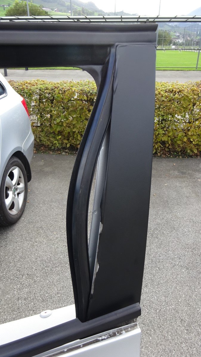

5. Now you have full access to the foil. I found removal of the old foil and cleaning the paintwork after to be the longest, tedious job, as it tends to break into pieces. There is always a residue of the adhesive left on the paintwork, and found that isopropyl alcohol wouldn't touch it; in the end I had to use petrol on a rag to firstly 'dissolve' the old adhesive, then use the isopropyl alcohol to totally clean the surface in preparation for the new foil. Make sure all of the old adhesive is removed, as I am convinced the new foil will show every defect underneath....
6. Attaching the new foil is relatively easy, as 3M have helpfully added to some tabs to hold on to so you don't get your fingers on the adhesive surface. Make sure you line it up to have the same size 'roll around' edges front and back of the pillar, and gently start at the top to smooth down the foil to make sure there are no air bubbles, creases, etc..
7. When the new foil is completely installed, replacement is the reversal of the above. One tip I found saved me a lot of time: apply a small amount of grease to the sides of the bottom section of the seal that is to be re-mounted back into the corner of the door frame at the lower corner of the pillar (nearest to the exterior door handle). This helps slide it back in, otherwise the rubber tends to resist and bind; and you might find (as I did), that if you raise the window glass very carefully to about an inch proud of the door frame, then you can lift and raise the glass forwards to enable the rubber seal to go in behind.
8. Finally, in short burst on the switch, raise and lower the glass to check it runs freely.
Set aside an hour for the first door....😉
