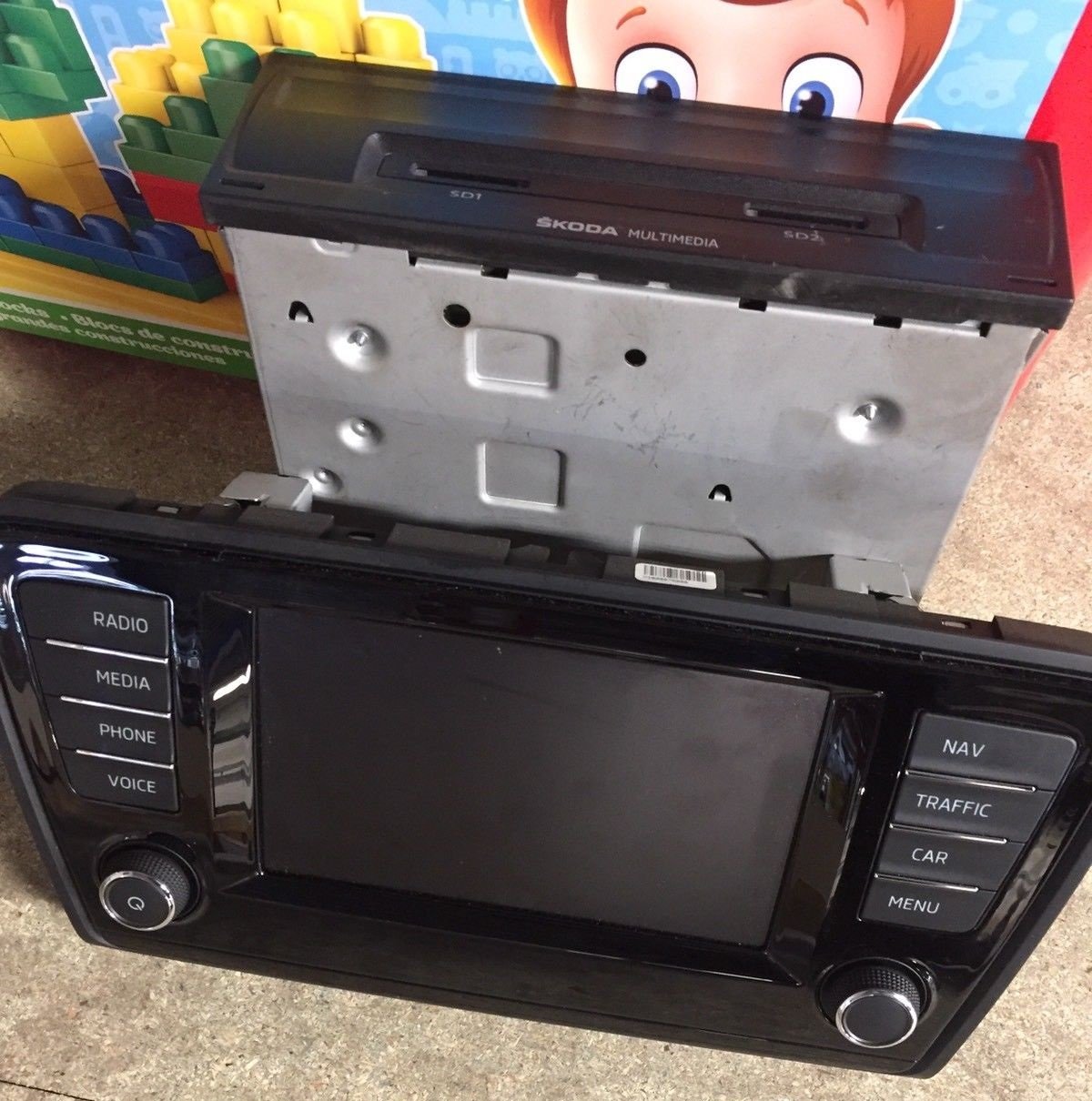

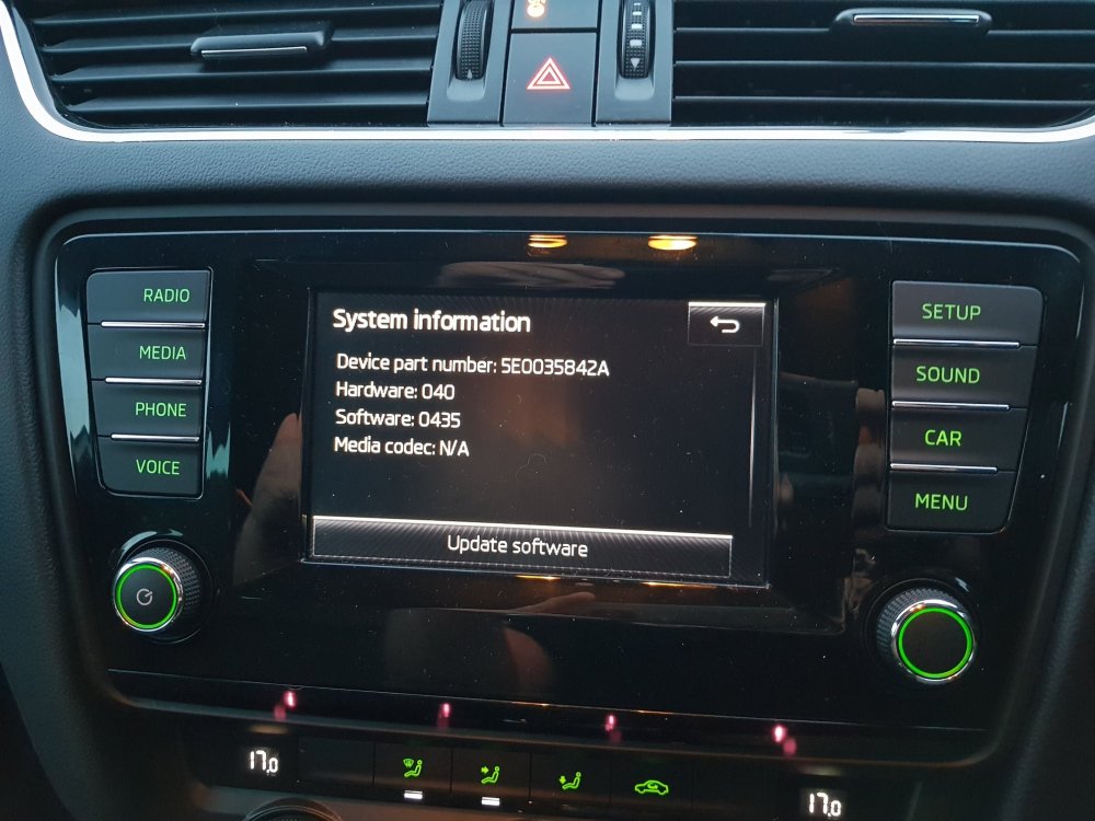

Hi all and TIA, my  Octy has the headunit pictured below (Bolero I think but unsure) I am wondering what my upgrade options are using Skoda equipment to get sat nav, car play etc I am looking at the model in the other picture from a breakers I know cp will have to be removed but is it a straight swap and will it give me the thing I listed earlier?

Yes and No. The stereo you have linked is an Amundsen MIB2 and it will fit straight in after CP has been removed but to get the nav and SmartLink working it’ll need extra coding done outside the dealer network. You will also need the green tipped CarPlay USB (5Q0 035 726 E) as well and a generic FAKRA connection GPS antenna for the factory nav. The install is plug and play after shaving down a couple of connector plugs. It would help for you to have VCDS so you can send an ad map to whoever is going to code the unit and to activate the nav menu and compass in the Maxidot.

@SashaGrace are you sure that is a MIB2?  looks the same as my MIB1 Amundsen.  Just don't want OP to go getting it thinking it'll work if it wont.  How do you tell the difference?  I thought the Amun' MIB2 unit had a bigger screen?
The 6.5 inch screen has less of a bezel on it than the 5.8 inch screen which uou can see if you look at the Bolero in the OP’s car and the unit linked very closely, and the glovebox unit has no CD drive which is the main difference. Only the Columbus has the big 8 inch screen on the Pre FL (though the 8 inch screen does work on the MIB2 Amundsen).
