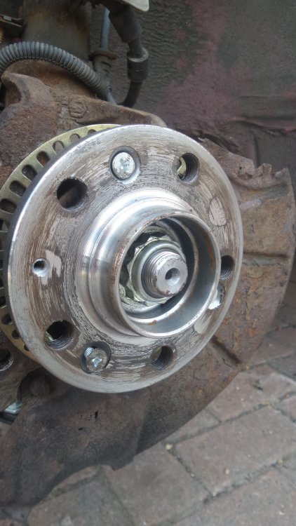

Guys does anyone know how the ABS rings are held on to the hubs?
I took my front hubs to have new bearings fitted the other week and had new hubs and rings fitted at the same time due to the corrosion on the original rings.
Just noticed a nasty noise coming from the N/S front and on inspection it appears the ABS ring on the rear of the hub has come loose.
How are these fixed to the hubs?
Last thing I want to do is get another hub fitted because that will involve another bearing and expense I could do without to be honest
They are normally part of the hub, unless you had a pattern part fitted which came in a diiferent condition to what is normally supplied.
They are usually fitted at the factory onto the hub, presumably by use of expansion techniques and left to cool ready for shipping.
Does the new hub you had fitted not come with a parts warranty?
It should do, they came from euro car parts.
Looking at other patern ones on ebay they have 3 large screws holding them on which would make sense as its not loose all the way around
But the screw heads are on the inside and would be flat against the inside of the brake disc so no way they can undo so something is very wrong
Edited by fwdnewbie
Error
Well it appears that all 3 screws are loose, probably started with one and vibrated the other 2 out.
Will get the strongest loctite I can to hold them in place and tighten back up.
Just hope it hasnt damaged the abs sensor in the process
