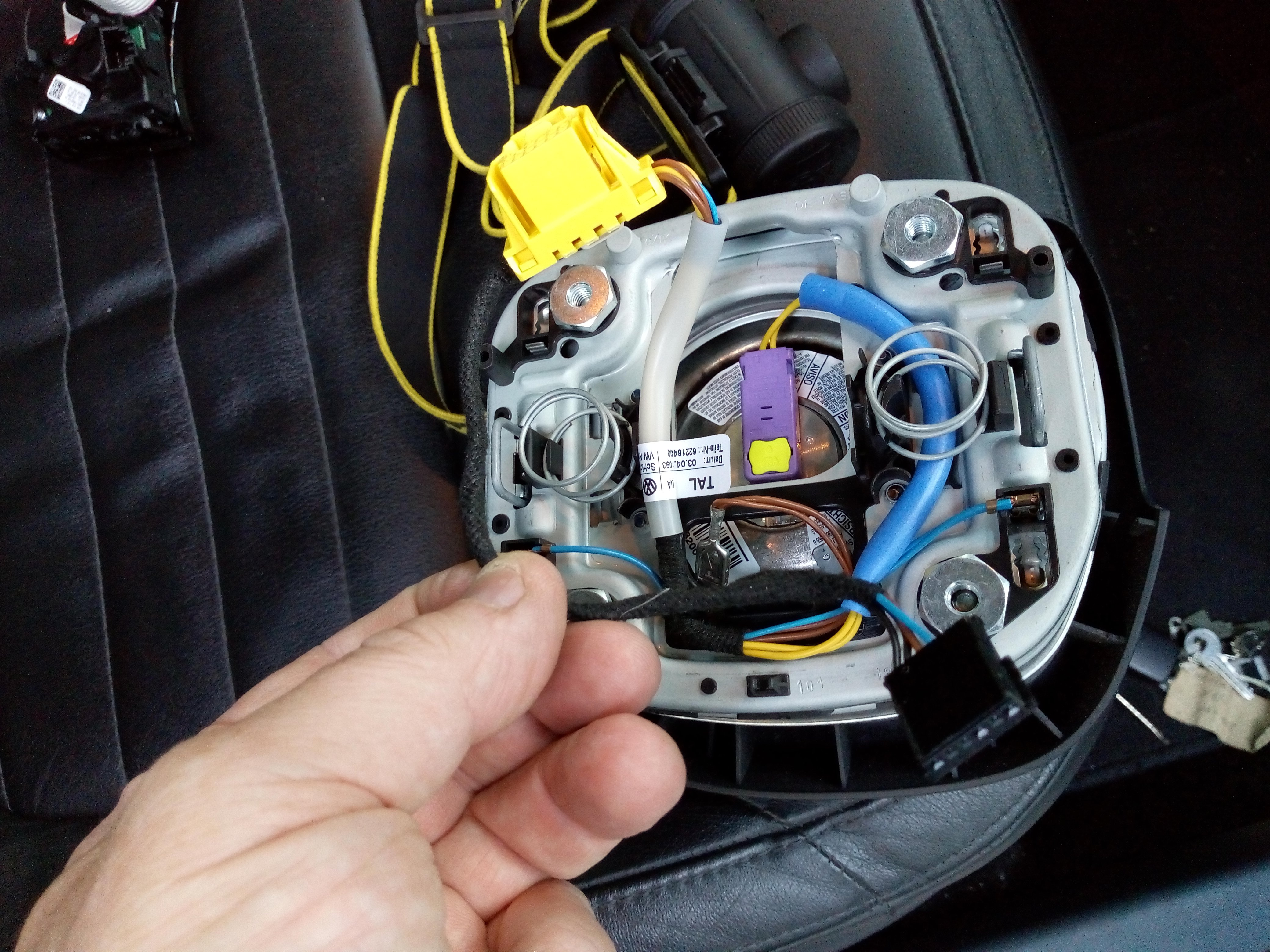

I took my wheels airbag off and there is one connection which has the air bag wiring and the switch wiring all going into the yellow plug

first picture is of the airbag that is on the car at the moment

the main problem is that the plug for the switches on my wheel
are a different size to the ones on the vrs wheel and are linked to the yellow plug for the airbag
(as seen in the first pic)
I understand that I will be swapping the switches but will the airbag that goes with the vrs wheel have a different size plug for the switches
could I take the wiring loom off the airbag from my car (so keeping the plugs for the switches)
and fit it to a airbag (which I have to fit the vrs wheel?)
What does your current mfsw look like?
The airbag and switches from your current wheel won't fit on the new one.

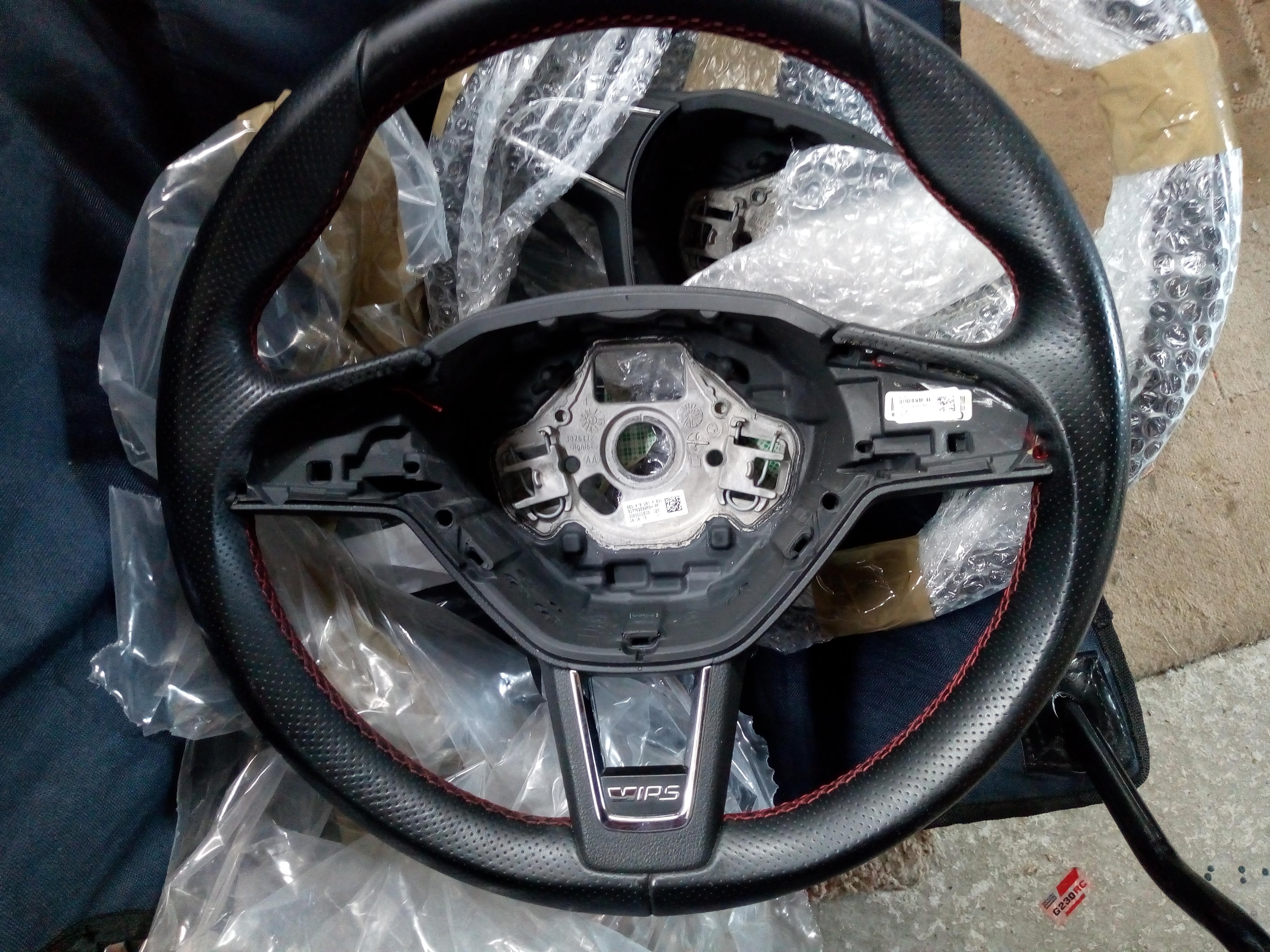

I have airbag that fits the 'new ' wheel

Your original switches won't physically fit on the new wheel, you'll need 5E0 919 719 F assuming you don't want DSG paddles. There should also be a plastic mount they sit in, it's not shown on your picture but you might already have it?
The new buttons have a different connector so you'll need a new wiring loom too.
5E0 919 719 L buttons might be OK depending on your MFSW controller, they have white illumination rather than green too.
Those buttons have the same part number as the ones I'm using so they should be fine.
I think the right part number for the loom is 5JA 971 584 but I'm not 100% sure.
I think that's a MK3 Superb not a MK2 FL so those won't work.
The second link for just the buttons and mount looks correct though.
