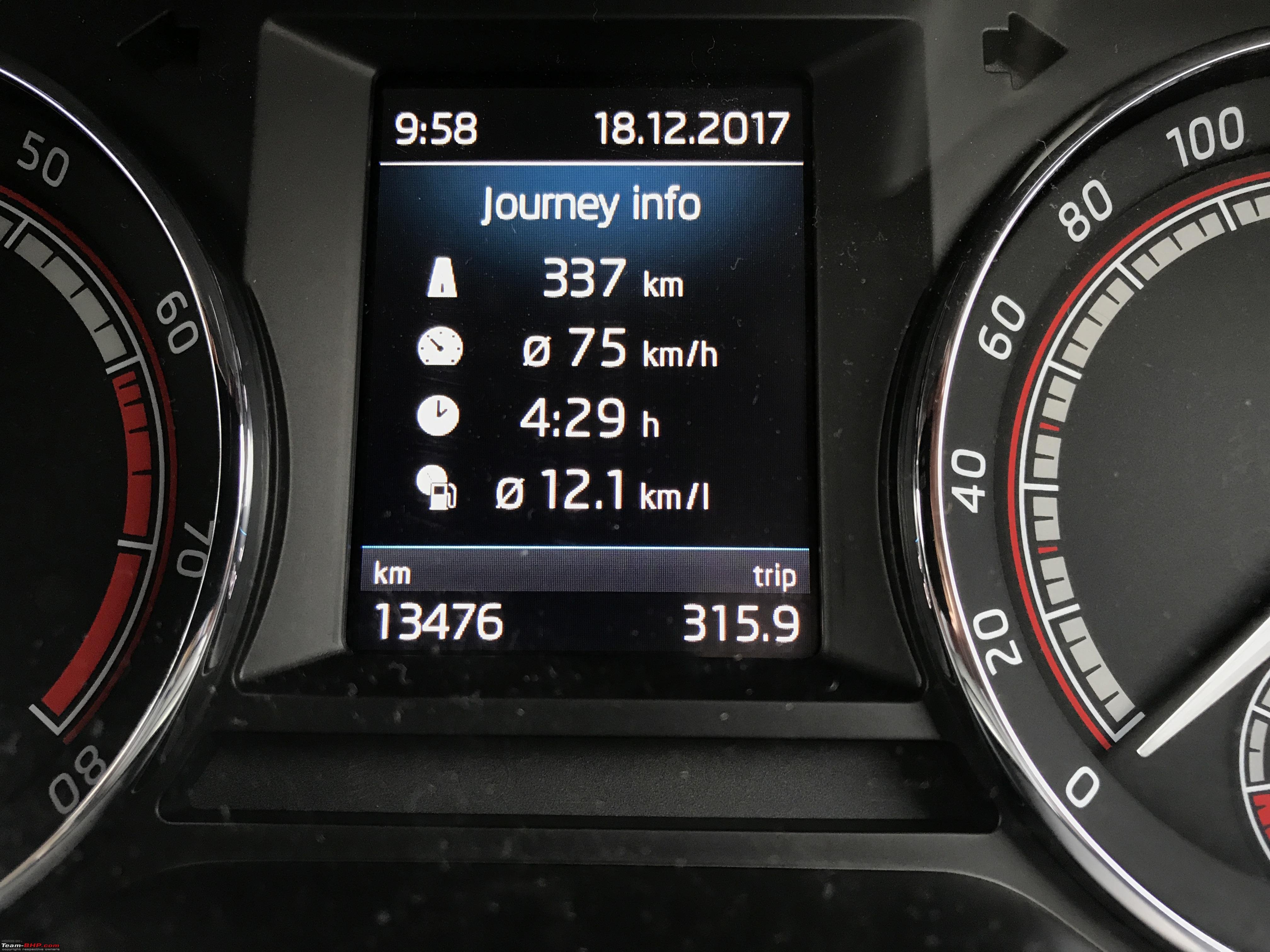

Attached image for reference only as to what I would like to see on my car
