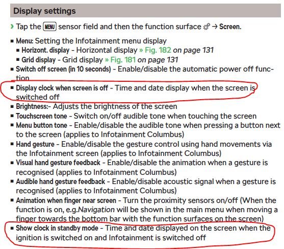

 Also on the home page on the infotainment screen, mine seems to be set on Nav/ radio/ phone status, is there any way to change this. In the settings menu the " show clock in standby mode" is ticked but the line is darkened and does nothing. Can I change the home screen at all?.

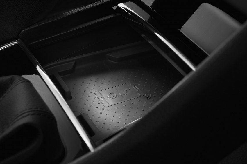

The wireless charging feature has been removed due to technical / compliance issues, cars already built and in the UK are supposed to have had the feature disabled. There is still some confusion though, some have noticed the wireless charging pad is missing, others have it there but instead the signal booster has been disabled.
Are you sure the wireless charging pad is present?

My Kodiaq Edition, has the wireless charging pad, but mines is a 2017 model.  Not sure if the wireless charging works though as we dont have a phone capable phone of the wireless charging.
If the wireless charging feature is fitted the rubber pad where you'd locate the mobile phone has an image of a charging phone on it...
skoda-karoq-india-mobile-holder-wireless-charging-pictures-photos-images-snaps-gallery.jpg.5868f83b32341c0a277498af10a24632.jpg
Those cars that were reworked, or that had the feature removed should have had the plain rubber mat installed at the same time.
There are two options for displaying the time / clock, does selecting one grey out the other or vice-versa?

 Secondly, thanks for the screen shot, my menu on the car is different, but was able to work out with my options what to do.

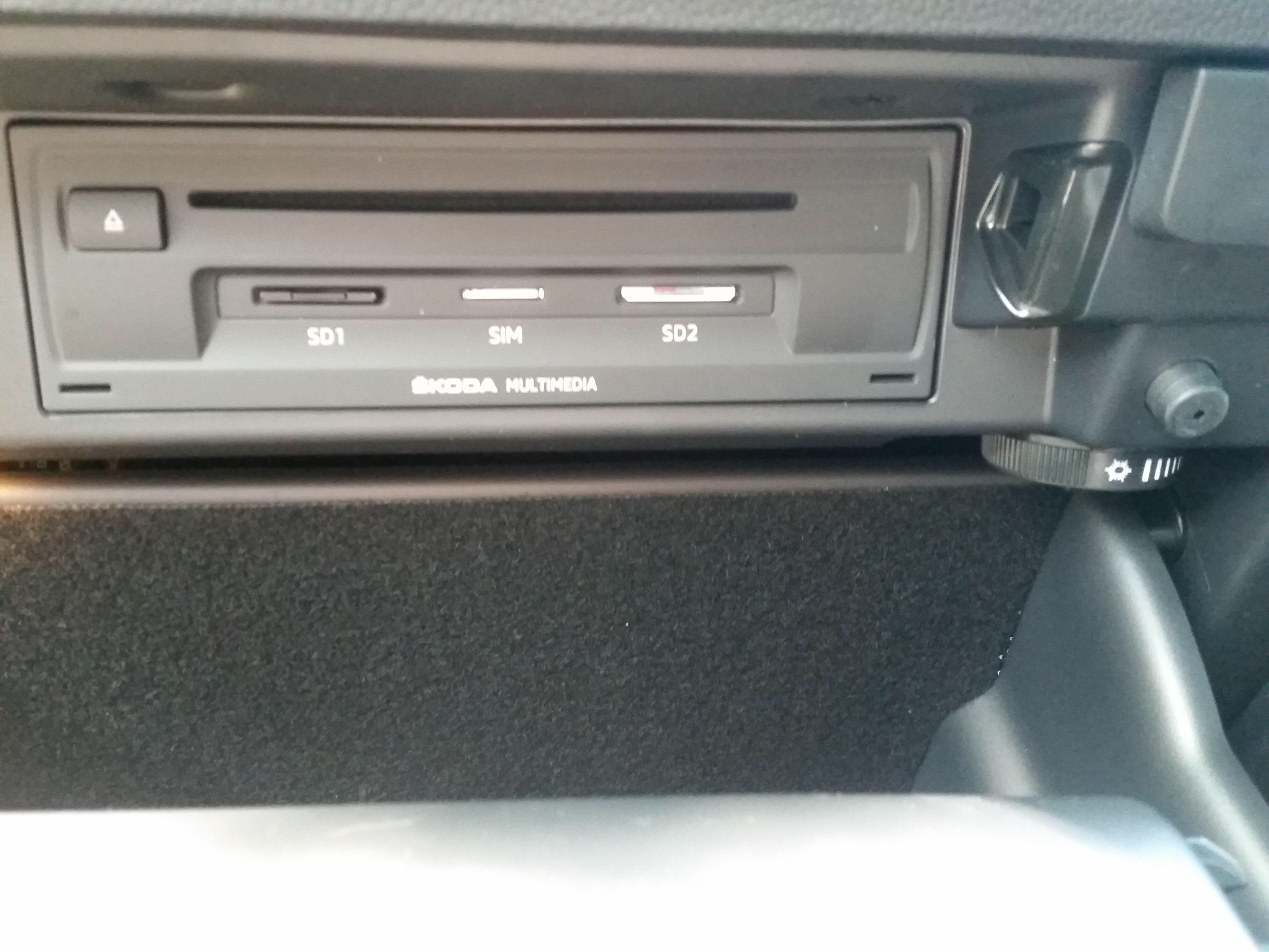

Ok,ok, it is probably me being thick!!. I bought a SIM card(vodaphone)and inserted into SIM card slot, could not get any connections and kept asking for network key. Rang vodaphone who told me I should have activated it first, despite me asking this question when buying it and being told to just put it in the car.
 Went to get the SIM card out but have no idea how, it is not showing, and being a bit slow on technical issues do not know if and how to retrieve this SIM card.
 Any (gentle) ideas?.

If  you look at the SIM card slot you should see a tiny bit of the SIM card sticking out. Push the SIM Card gently inwards and it should pop out.

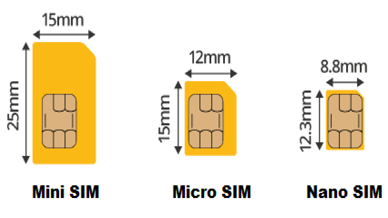

What size of SIM did you put into the slot? I only ask because I put in the standard size and it wouldn't  work. Read the manual and it said it takes micro so put that in then had to use tweezers to retrieve the card. Can you see any of the SIM?

If you look on the image, you’ll see the white edge of the SIM card if you push it gently it should come out, provided you used the micro SIM pop out from the Vodafone multi SIM card format card. Any Vodafone shop should also be able to activate the SIM for you.

If you've inserted the SIM but can no longer see it then it's been pushed in too far.
The head unit that houses both the SIM and SD cards will likely need removing, but you need a special tool, note the two rectangular slots on each of the bottom corners as seen in the earlier picture.
Maybe the sim you installed is the smallest type, micro I think, and the sim slot is for the larger type.

From the manual a SIM card size mini (standard size 25x15 mm) must be used.
