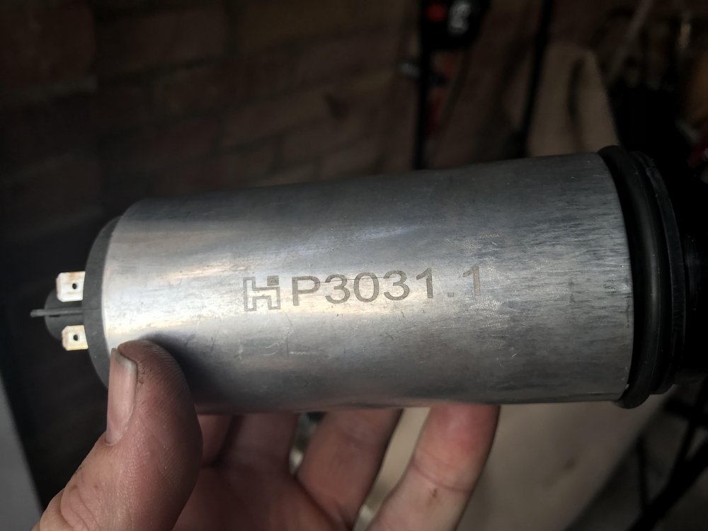

This is the uprated fuel pump I ran on my VRS.  I need an equivalent pump to this for the 4x4 Octavia, something with the same flow and bar.
I ran the same pump in my vRS as well. Can you find an OEM part number on the 4x4 pump inside the pot and see if you can cross-reference it with a replacement uprated pump that is straight fit?
I haven`t found a straight fit canister with pump in.. but I`ve found a suitable uprated replacement pump.  DW65v.
