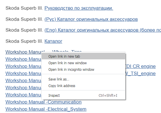

Hello, would you like to share again thr workshop manuals for superb 3 with us? The old link doesn't work anymore. Thank you!
On 24/05/2021 at 14:33, MartiniB said:
But I will insist with a more specific question. The car that I am driving is a Super 3 2016 2.0 dsg6. I can not find the service manuals on the russian website that you have quote. would you like to be kind and share other sources?
10 hours ago, DragosIonuts said:
I would like to thank you, dear sir!
Thanks!
But that weren't published by me, i just bookmarked interesting link
link looks alive:
