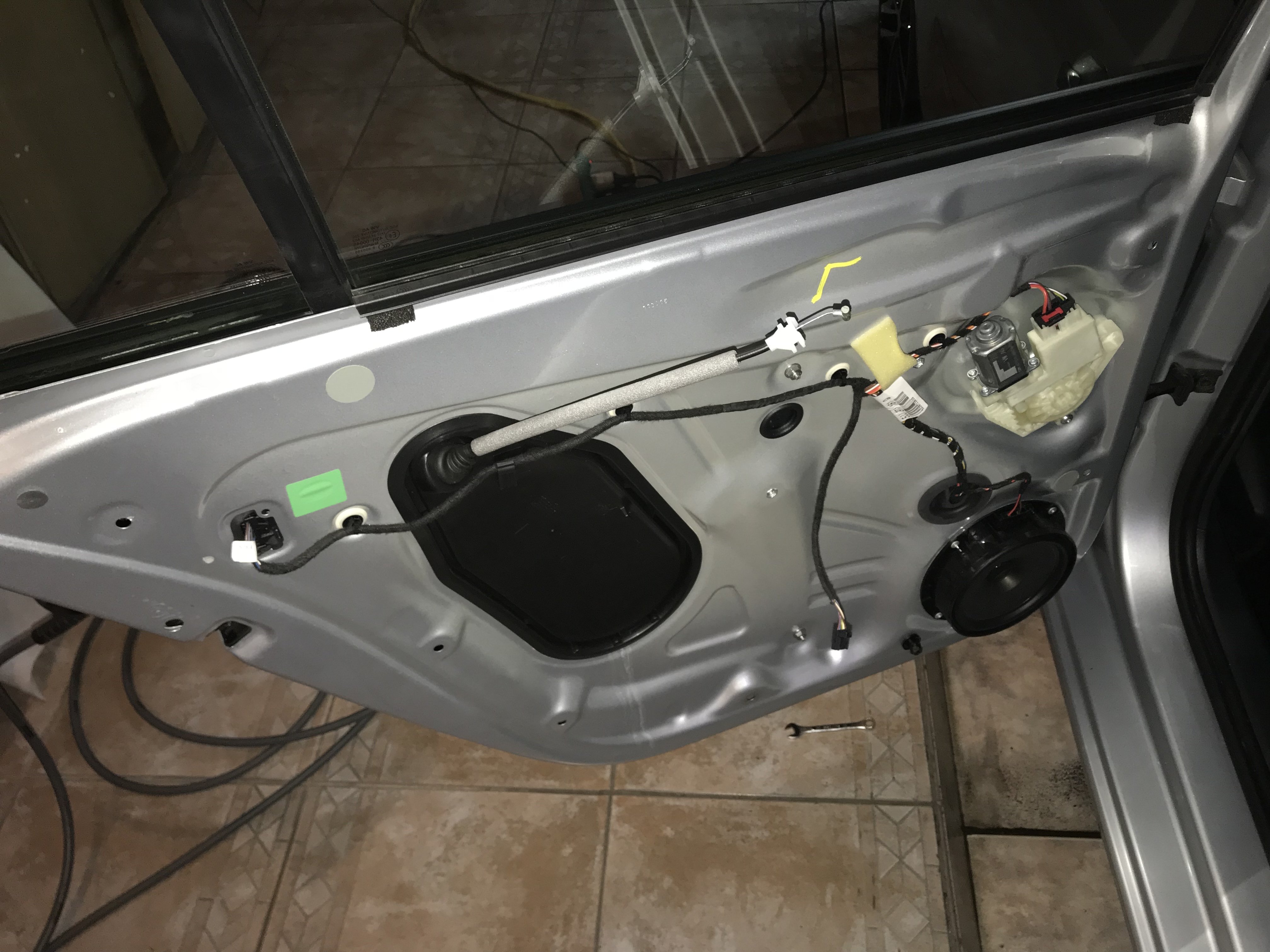

so, I took apart the door card. It’s pretty simple. You’ll need:
10 wrench for the lower look of the door card
a pryer for the door card itself
T30 bit for the 2 bolts hidden under the handle (start from the cushion, with ease. Pull gently.
lift the plate where’s the window switch, it will come off easy, then disconnect the cable. Push the tab, and pull off.
With the pryer start pulling the bracket till you have loosen the door card.
Then, grab the white tab to remove the wire from the door pull. That’s it.

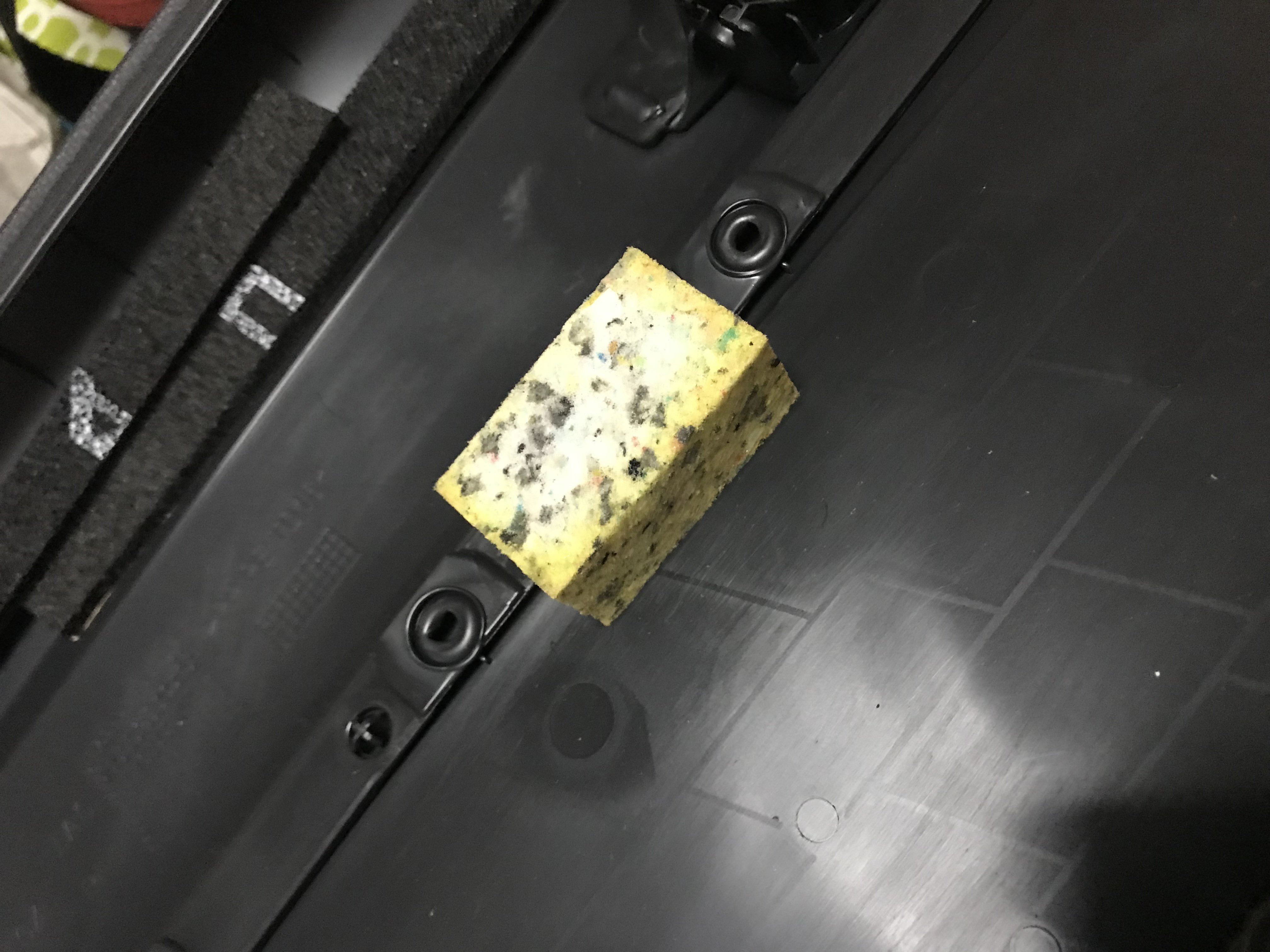

The door card only haves a little block to avoid rattle. So low cost here!

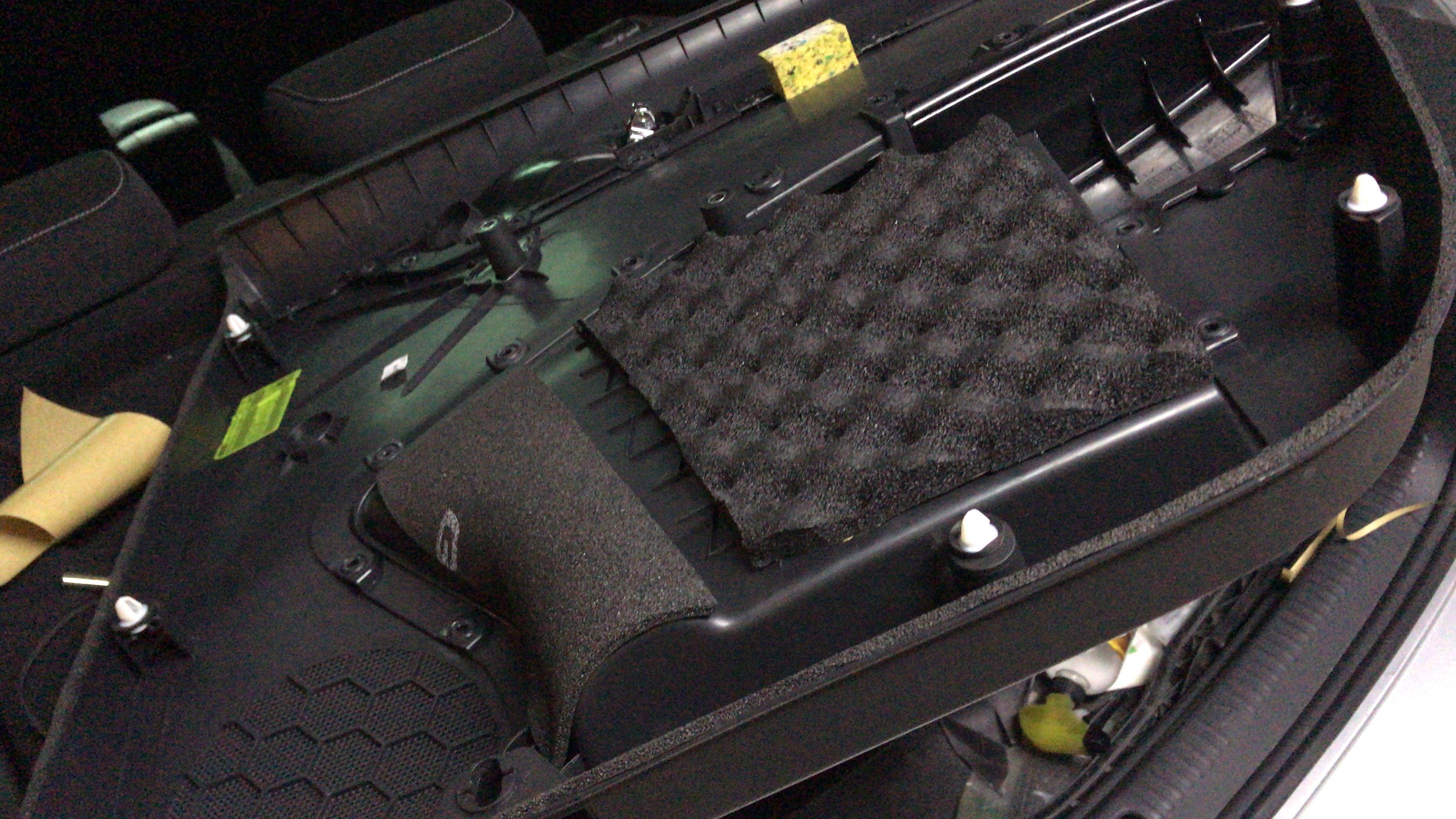

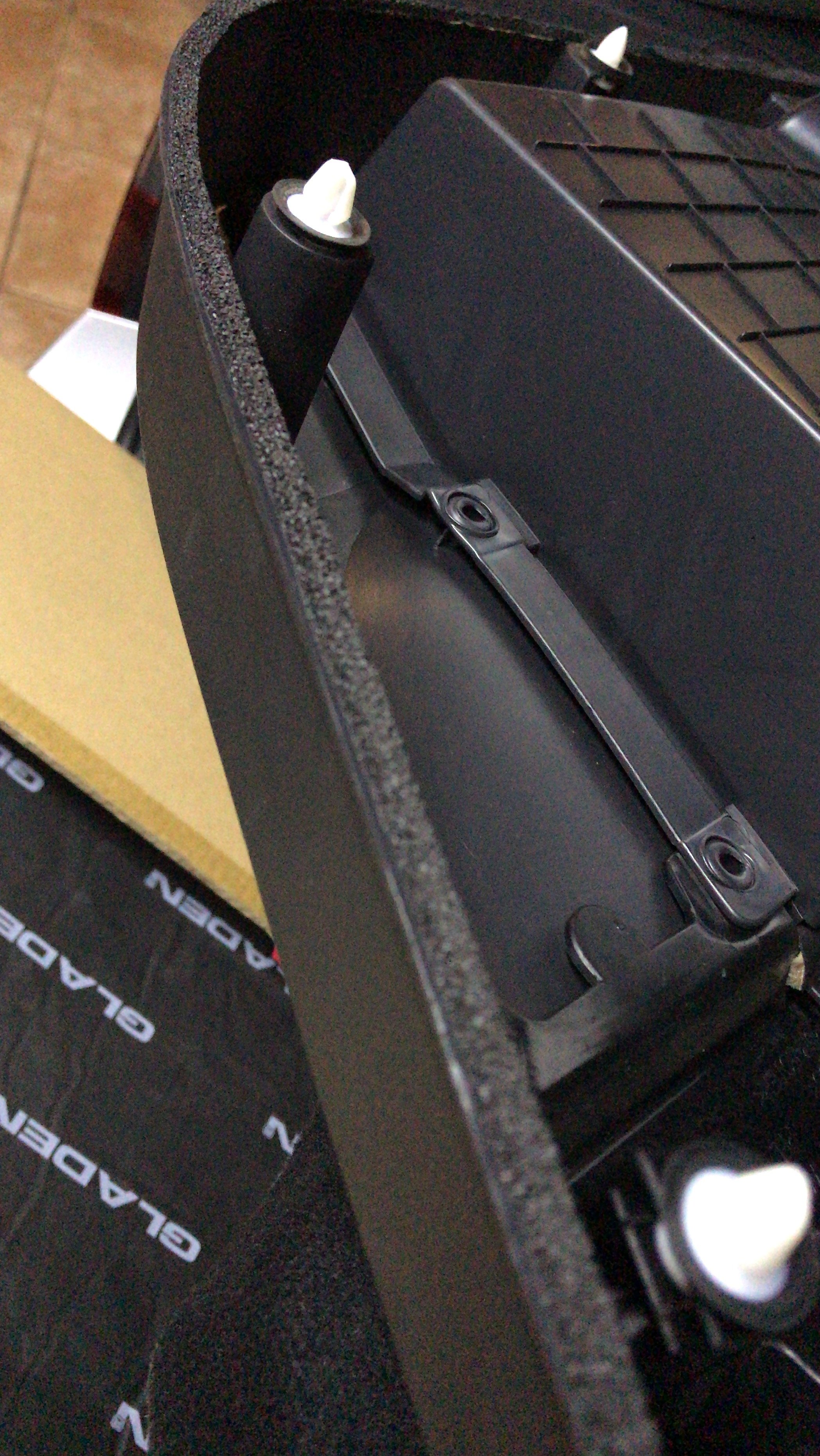

To make it less rattly, I went to a car audio shop and purchase some deadening material.
Picked this.
1 gladen aero foam, the cheapest of the line and thinnest. For the border.
1 gladen aero wave, to avoid the contact in the areas where is little to none gap between the door card and the door.
Picked other, but I’ll make a topic for upgraded front speakers.

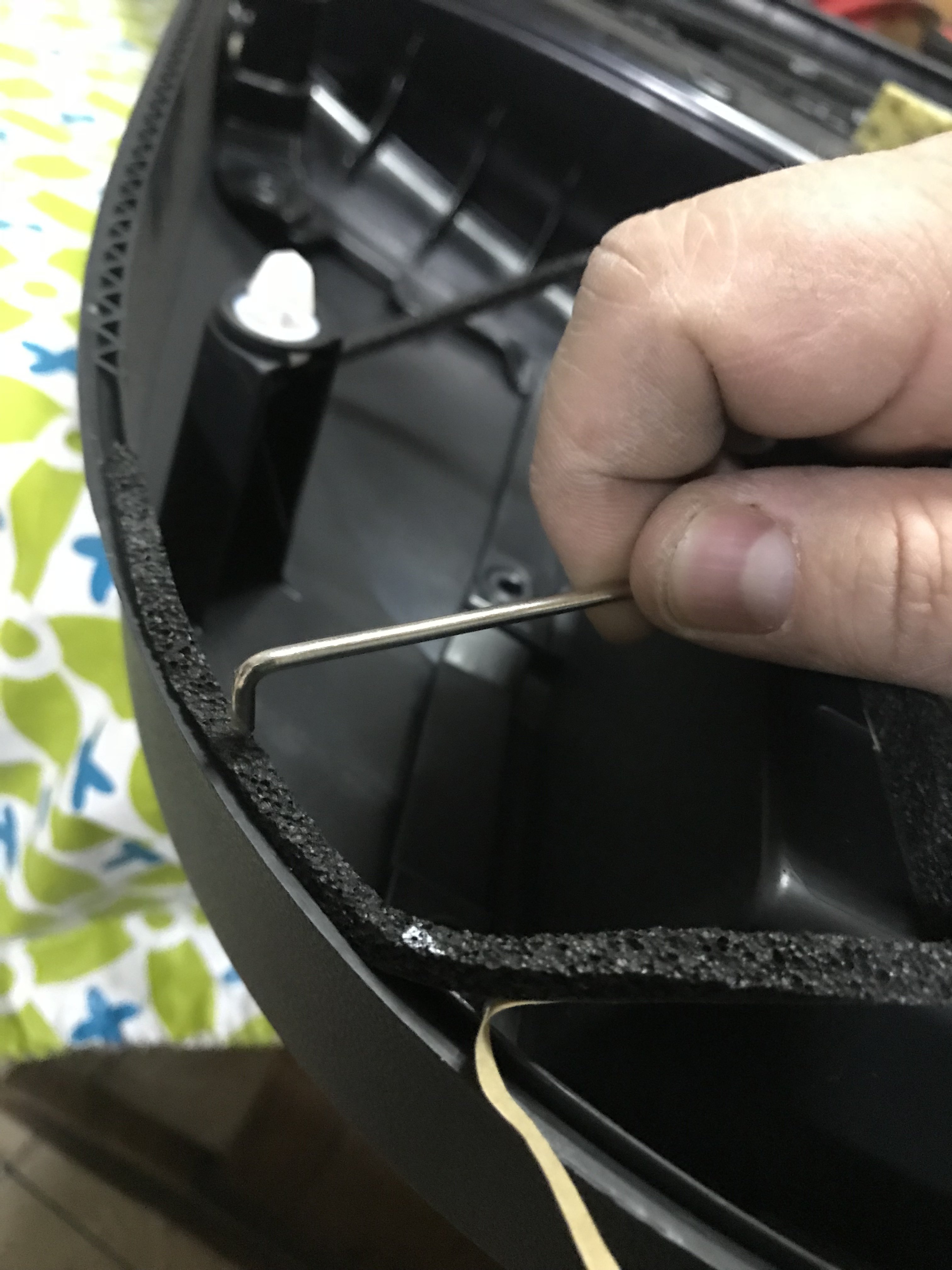

the door card have some channel where I put some of the gladen aero foam.
All the border using aero foam,
Larger areas aero wave
Top of the door card aero foam to avoid contact with the edge by the window.
Aero foam where the door handle ( closest part of the door card to the metal)

Re install and you’ll be rattle free. At least in the rear doors.
Went for a drive and total improvement. Now I have to do the front door but I’m waiting for some Morel components to replace the factory speakers. Should be similar to the rear one. At least I have plenty of material to improve the from door cards as well.
