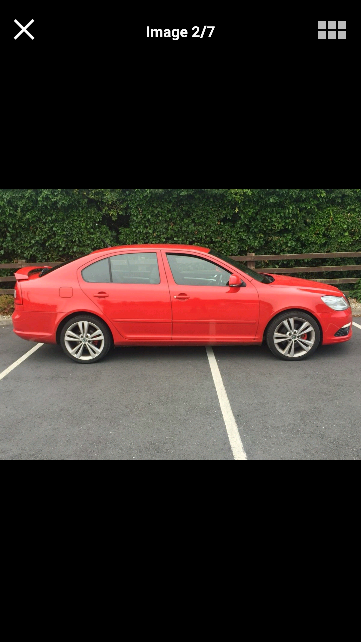

Hi lads,
Newbie post!
Picked up a 2010 VRS Cr170 for the woman and it has a few niggly issues.
1. P2015 (surprise, surprise!) intake flap motor/sensor
2. Door open red warning light on dash when all doors are closed
I have orderded the Dieselgeek diy repair bracket from eBay so I'll go about installing that when it arrives.
Any tips would be appreciated about what parts need to be removed (if any) to gain access to the torx screws to remove the motor assembly or if anyone on here attempted this fix, I'd like to hear how you got on. I see there are a few YouTube videos showing the install but they all seem to be on other slightly different VAG engines.
The door open warning light is the next thing to sort. The car doesn't have a MFSW so its hard to know which door is throwing the fault.
I do have VCDS so perhaps that would show up what door is causing the fault.
What are people's thoughts - worn/failed microswitch? Leaky rear wiper washer pipe? Any successful and not too expensive fixes??
I'm only going by Google searches at the moment but I'm sure there are plenty of people on here who could offer some more relevant and specific advice.
Thanks in advance!
